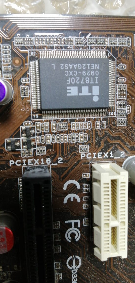

      the problem is that i have asus board m4a78t-e
      it gives me : chassis intruded system halted, i changed cmos battery, i reflashed bios, insert the jumper, none did the job...

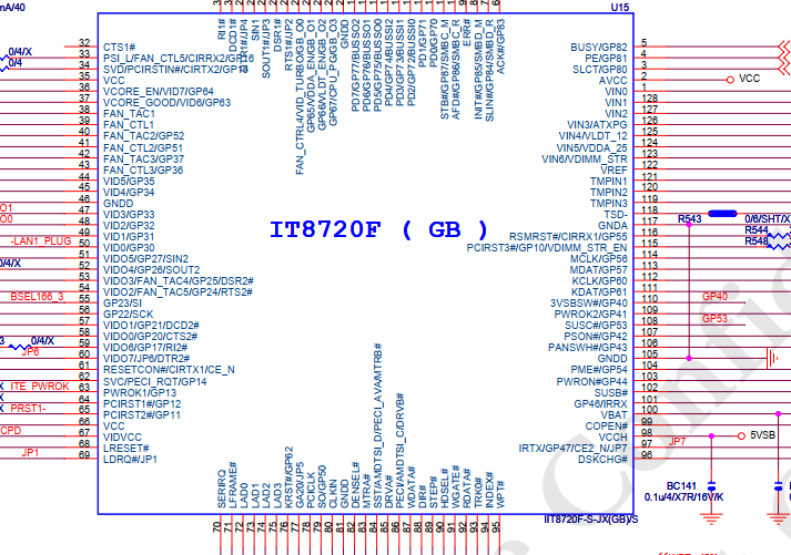

      is there a way in the I/O TO PREVENT IT FROM CHECKING the caseopen,
      the i/o is IT8720F?
      thanks

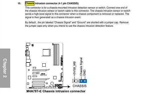

        insert the jumper
        This jumper?

          i already using the jumper, with no succes
          i am confused: i have 2 different data sheet of it8720f, i donot know which one i have
