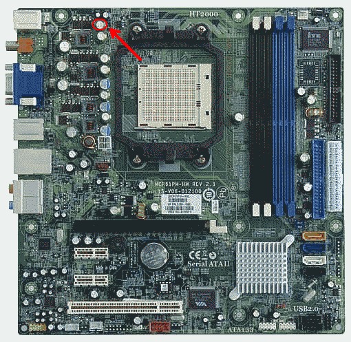

                        Hi, I've noticed that several posters here had trouble removing the old solder from the motherboard holes. Me too! The old solder doesn't seem to want to melt.
                        I've been trying to recap my motherboard (using the caps kit I purchased a few weeks ago from Badcaps). The project is turning out to be much harder than when I practiced on a trashy old board. Every step--removal of old cap, clearing hole of old solder, and getting new solder joint to adhere to hole's solder pad--has been much tougher than expected.
                        The motherboard is an ECS MCP61PM-HM Rev 2.1 used in an HP Pavilion m8400f pc:
                        http://h10025.www1.hp.com/ewfrf/wc/d...c01357175#N467
                        At the moment, I'm unable to clear old solder from one of the holes.
                        I don't think my iron is the problem. It's a 60W temperature-controlled station set at 450C (confirmed by the temperature probe of my multimeter) and I've tried 3 different tips for the iron: chisel, point, and narrow chisel.
                        I've tried a bunch of techniques:
                        Melting some new solder onto the bottom of the solder pad (to improve thermal contact between old solder and iron's tip).
                        Iron's tip on solder pad (bottomside) with vacuum bulb on topside.
                        Iron's tip on solder pad (bottomside) with vacuum bulb on bottom.
                        Iron's tip on dental pick tip & solder pad (bottomside).
                        Pushing dental pick on topside while iron's tip on solder pad (bottomside).
                        Pushing dental pick on topside while iron's tip on dental pick tip.
                        Pushing a capacitor lead on topside while iron's tip on solder pad (bottomside).
                        Pushing a capicitor lead on topside while iron's tip on cap lead.
                        Iron's tip on solder pad (bottomside) with spring-actuated solder vac on topside.
                        Iron's tip on solder pad (bottomside) with spring-actuated solder vac on bottom.
                        The problems I've experienced with the other steps may be related. When desoldering an old cap, it takes a long time (about a minute) applying heat before the old cap can be budged. When soldering in a new cap, the solder doesn't adhere well to the solder pad; it only sticks to the cap lead, even though I had the iron's tip in contact with both lead & solder pad.
                        Does anyone have any suggestions? Pro289 wrote that he needed to drill out the old solder. That sounds scary if the drill is handheld (and I don't have a drill press)... couldn't a tiny accidental movement of the hand destroy the metal sleeve in the hole?
                        Thanks in advance for your help!

                          If the solder refuses to come out, then I don't clean it. I just put a bit of fresh solder over the holes, and hold the soldering iron over both holes to keep the solder melted as I push the new cap in.

                              The technique of pushing the capacitor in while heating the solder-clogged hole from the bottom side (as described above) worked, but I discovered it helps a lot to first trim the length of the capacitor lead so the lead won't bend during the pushing. (When I first tried doing it while the lead was long, it went only partway into the hole before a bend appeared, and got stuck there. I had to heat the hole again while pulling the cap to get it out... after which I trimmed the lead and succeeded.)
                              I suppose one would need to trim both leads if both holes are clogged so you need to heat both holes simultaneously. A question: Should the leads be trimmed to slightly different lengths? I'm thinking this would make it easier to make sure both leads are properly aligned with the holes before pushing them in... less chance of a lead slipping off center during the pushing. Only one lead at a time would need to be carefully held properly aligned: First the longer lead would be pushed a little into its hole while heating only that one hole. Then only the shorter lead would need to be carefully held aligned, when both holes are heated.
                              I'm wondering if one of these two techniques--either c_hegge's technique of heating both clogged holes simultaneously while pushing in the new capacitor, or "my" technique of cleaning the old solder from only one hole and pushing in the new cap while heating only the clogged hole--may in general be easier and/or safer than the normal procedure of cleaning out the old solder from both holes. Does anyone think it would make sense to skip the normal step of trying to clear the old solder from both holes, and instead either clear the old solder from one hole, or from neither hole?
                              To heat both holes simultaneously, is a wide chisel tip best? Does anyone manufacture a soldering iron tip that ends in two points, with the distance between the points the same as the distance between the holes?

                                Since the technique of heating the old solder while pushing in the new capacitor is likely to be generally useful--an alternative to removing the old solder--I wrote about it in a more general thread titled "How to remove leftover solder":
                                https://www.badcaps.net/forum/showth...n+solder+holes
                                That thread is in the "Equipment Usage, Soldering, Techniques and Reviews" subsection of the "Electronics Theory and Troubleshooting" section. (It's not a recent thread, so I'm wondering whether I should have started a new thread.)

                                    @Lucidbarrier: Thanks for commenting.
                                    Perhaps I should have tried setting my soldering station to a temperature higher than 450C. But I was reluctant to risk destroying some component with too much heat.
                                    I only replaced 3 of the old capacitors--the ones that had obviously leaked electrolyte or bulged upward--because replacing them was so difficult and because the computer worked properly after replacing those 3.
                                    I didn't reinstall the motherboard or peripherals back into the system case, because I figured there's a significant probability that I'll need to replace another capacitor, and it was a lot of labor to remove motherboard from case for desoldering/soldering, and I can easily keep an eye on the remaining old capacitors with the computer running sprawled on my desk without its case. One more capacitor developed a slight bulge and a small brown electrolyte spot on top about 8 months ago, but it hasn't seemed to impair the operation of the computer.

                                      Fix it now before it damages something else.

                                        @c_hegge: I appreciate the advice. I'd appreciate more detail about the risks and tradeoffs if possible, because there's also a risk of destroying the motherboard if/when I try to unsolder the failing capacitor.
                                        In case it helps to evaluate the risks, the capacitor that's failing is the one circled in red in the attached photo of the motherboard.

                                          It's on the CPU VRM low side. For now, the other caps will be taking up the slack, but it will put more stress on them.
