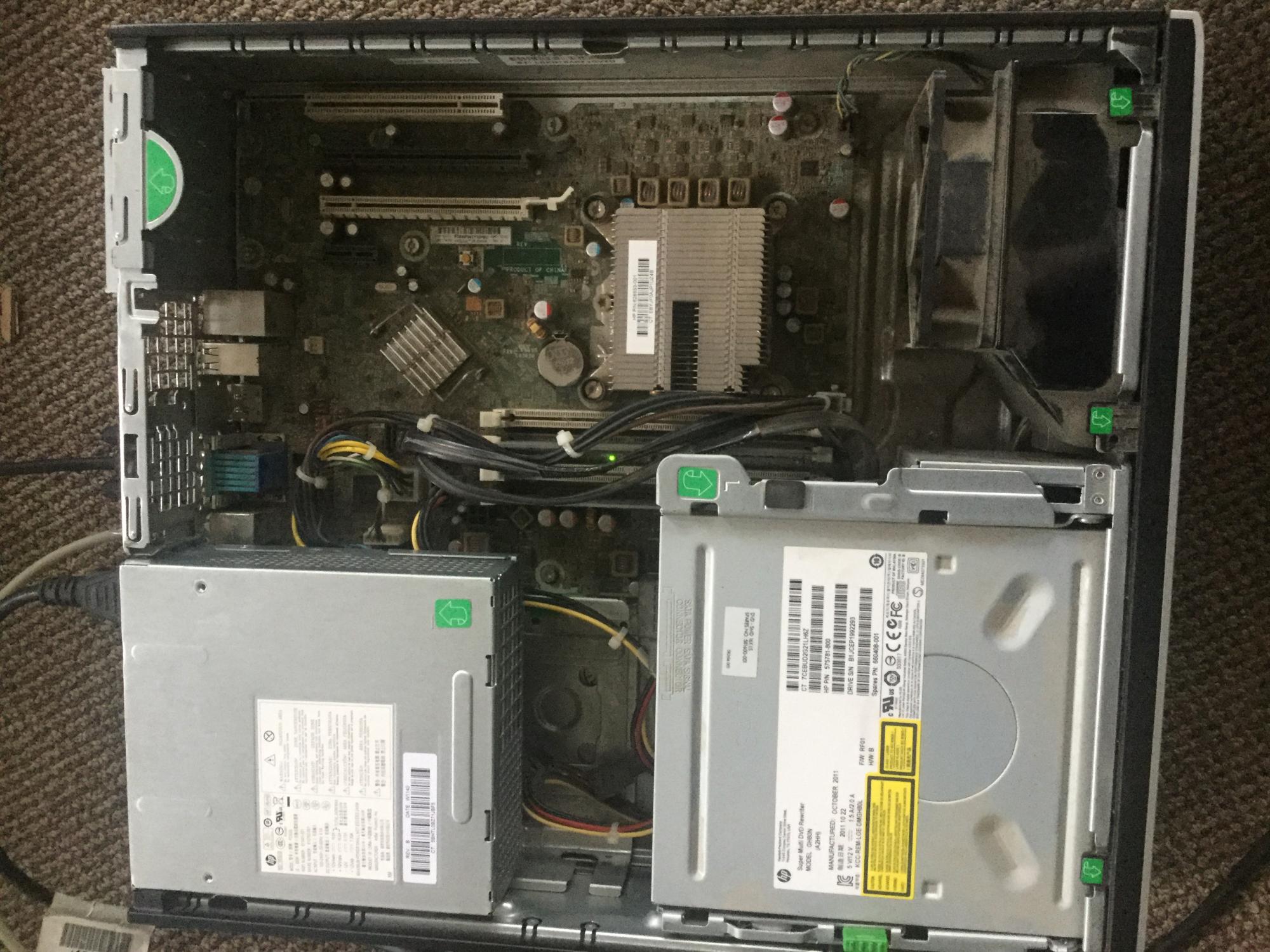

    I have this computer that I inquired them from my employer when they did a computer upgrade
    They have been sitting in my shed for a couple of years now
    I just bought me a battery tester that I want to use this computer to do the data logging with
    I recapped the power supply and all of the capacitor that were less than 100uf were at least 2X higher or more in ESR value than it should be
    My question is should I recap the mother board
    My success rate results doing this is 50 / 50
    The question is should I do this or not
    I can load the windows operating system disk and goes to the screen where if you had a hard drive in it would load the data
    But I do not have a hard drive for it right now but I will be buying one next week
    I do have a question about a hard drive for this computer could I use a solid state drive in it had windows xp on it
    It only uses SATA drives it does not have any IDE connectors for this type of drives
    I will be giving this mother board a very good cleaning

    clean the poor thing!
    then see if any caps are domed - if not then just try it.
    i see it already uses a lot of polymers.

      Remove the motherboard from the case and disconnect all peripherals/cables from motherboard. Use a high power blower and a brush to clean the motherboard. You can reseat the heat sink on the CPU if required by applying a new heatspread paste.
      Dont see a need to recap based on the current image, recap only if you are facing issues.
      As per the specs of the PC (here), it supports SSD upto 160GB. It also uses the Intel Q67 Express Chipset.
      If the motherboard is very old then you may have to replace the onboard battery, but do that only if you face issues (PC time getting reset, BIOS settings getting reset etc).
      There is nothing stopping you from going to the latest OS. It only depends on how much RAM you have in the 4 SLOTS. You can Install windows XP but you might have trouble finding all the drivers you need for the motherboard, chipset, and other onboard peripherals for windows xp.
