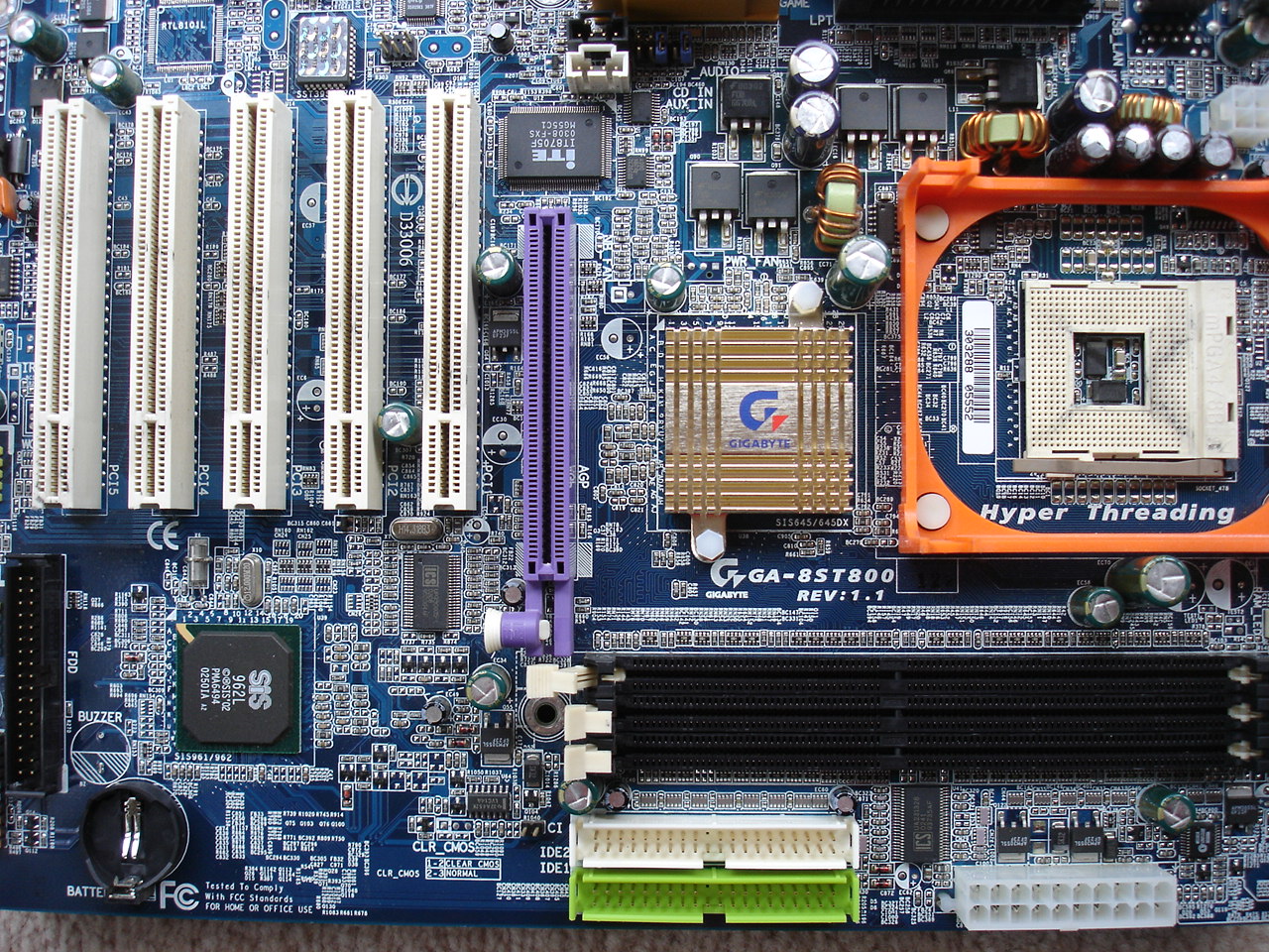

Gigabyte with bad Chemicon
  • pfrcom
    Oldbie
    • Jun 2006
    • 1230
    Chemicon KZG don't like heat, judging by these 8 x 20 next to the heat sink

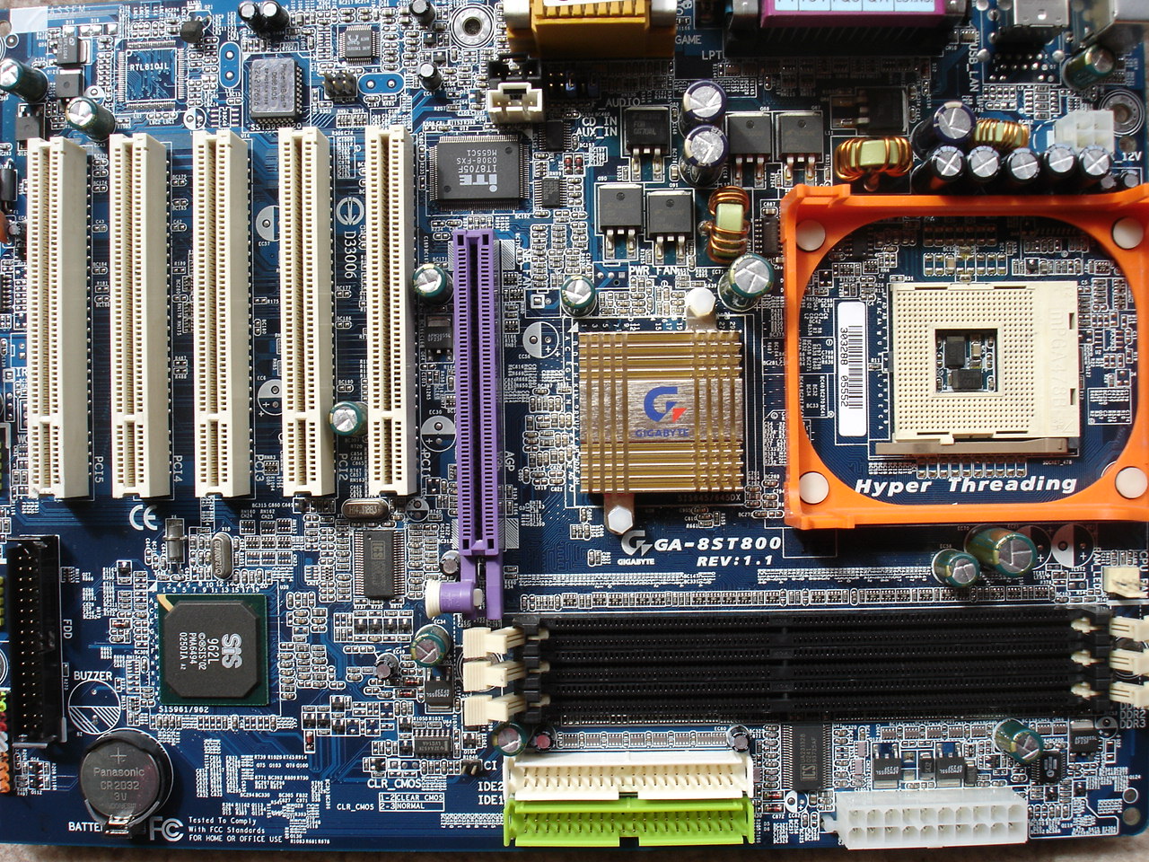

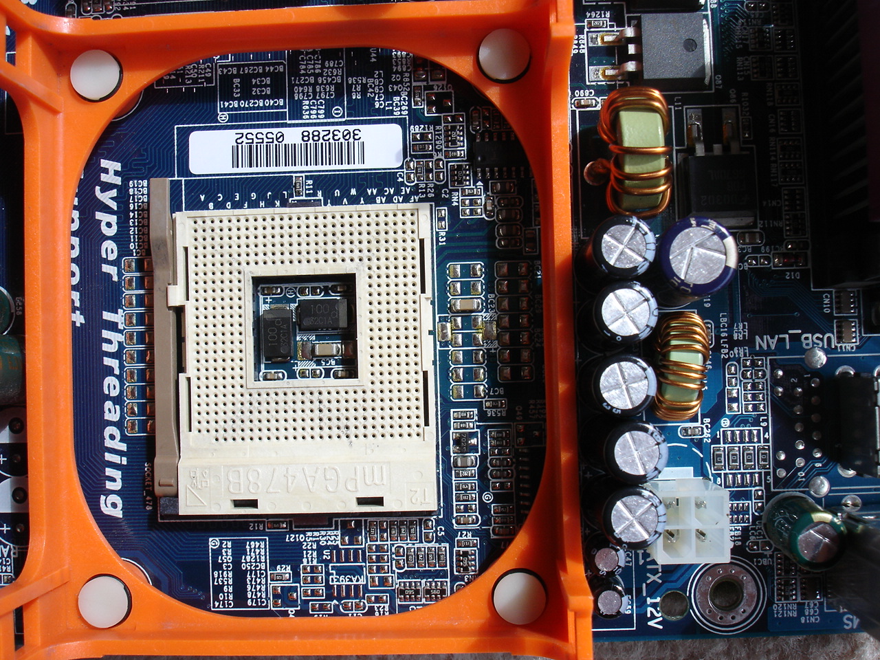

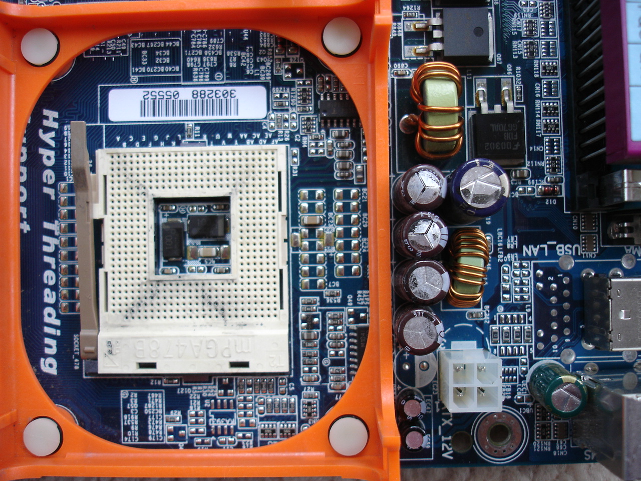

    Re: Gigabyte with bad Chemicon
    Replaced by salvaged Nichicon HM (I know, I know, undesirable, plus they are in the suspect date range) - missing one populated as well

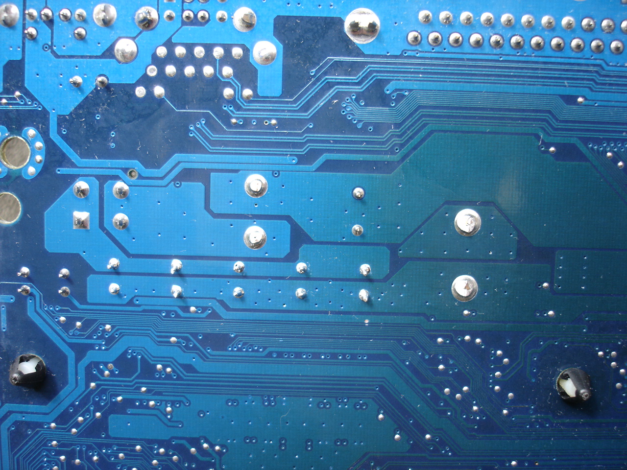

    Underside shows discolouration beneath the processor - strange seeing this GA-8ST800 is not supposed to support a hot running Prescott or Celeron-D
      one word- overclocking. some dweeb must have been oc'ing that thing, and had too small a cooler.
      those kz_ series chemicons are VERY heat sensitive.
        Hmmm, not always ratdude. We've seen these KZG's pop inside stock emachines.
        • ratdude747
          Black Sheep
          • Nov 2008
          • 17136
          well... emachines can have shit cooling. mine did... until i fixed it.
          also, i was referring to the discoloration.
          sigpic
          (Insert witty quote here)
          • weirdlookinguy
            • Sep 2007
            • 1638
            In this particular case (because of the discoloration) it looks like either some pretty heavy duty OCing or a heatsink that was only making partial contact or perhaps a dead heatsink fan that went unnoticed or maybe a bad combination of more than one of those, but what I'm saying is that overclocking is only one of many reasons for why KZG would fail. We can't really generalize and blame it on OCing. OCing isn't bad when done properly, just ask acstech.
            • ratdude747
              Black Sheep
              • Nov 2008
              • 17136
              i know. i used to oc a p3 using a crap cooler, but my fan setup was good so it worked.
