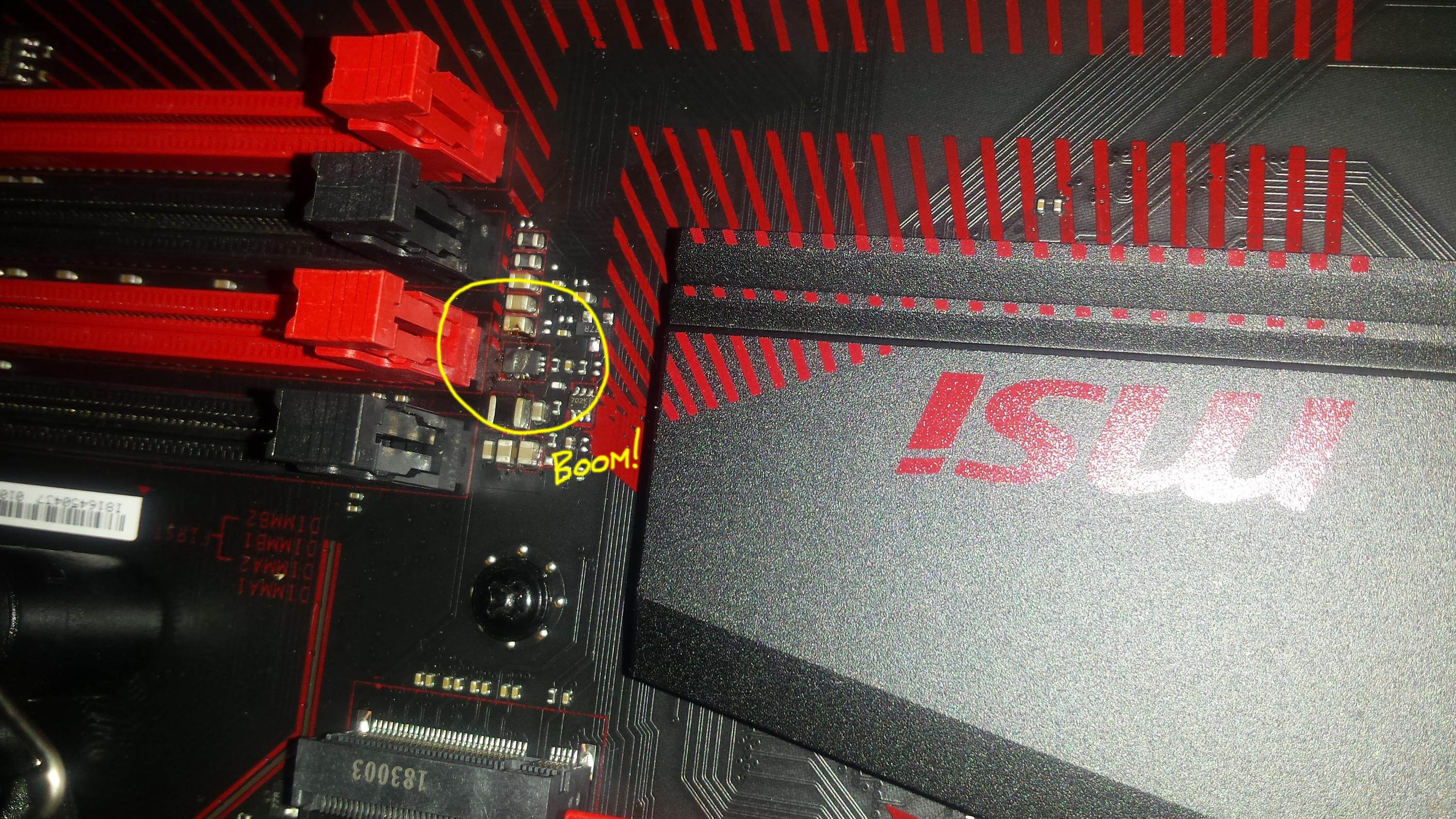

    I have an MSI z370 motherboard that has had a damaged ddr4 inserted causing a component to fry on the motherboard
    Does anyone here know what it is ? so I can replace it

    Can you make out the number above the 175 ?

      Re: MSI z370 fried component
      looks like it could be ALHJ175
        Seems to be a MP2147GD-Z ALHJ QFN12
        ALH = product code
        J = YEAR CODE
        175 = lot number
          ALH = product code
          J = YEAR CODE
          175 = lot number
          Amazing, I'll check it out
          Thank you so much.
