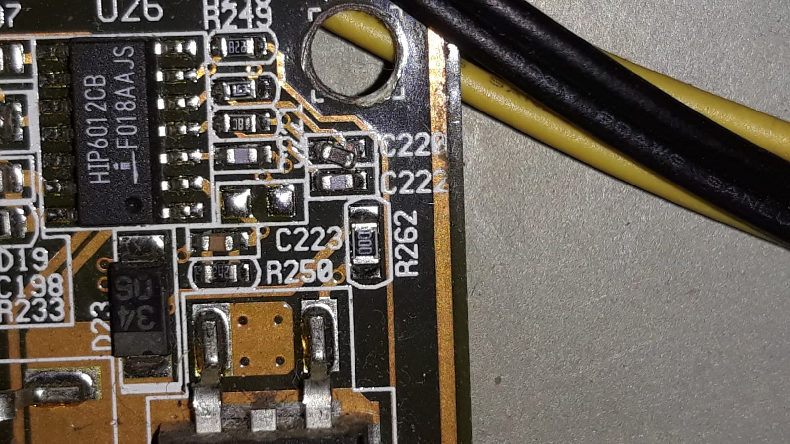

    I've a CUV4-X motherboard for that I didn't use for some weeks, I wanted to reinstall it so put it in it's case again last week, after powering it up I noticed it had 'coil whine'. When I remove the videocard the noise is gone, tried 2 videocards same results. I've used the board for years and this is the first time it has this annoying sound. I tried two PSU's but same results, I'm 100% sure it's coming from the motherboard just not sure which location.
    Here is a picture of the motherboard http://hw-museum.cz/mb/46/asus-cuv4x
    Take a look at the first picture, bottom right (near the memory slots) - I noticed that coil (or choke or inductor don't know how to call it) is VERY hot to the touch (like I can touch it for 2 seconds then my finger 'burns'), other ones are cool. This is after 10 seconds after powering the PC on and sitting in BIOS. Is this normal? I have no idea if it was always so hot to the touch, might have something to do with the high pitched sound? Anyway I never replaced any caps on the board, but they all look OK, the ones near that hot coil do feel kind of warm to the touch though, probably because that coil is heating them up.
    Any thoughts?

        Re: Asus CUV4-X suddenly has coil whine
        What brand of capacitors does your motherboard use? The ones pictured at hw-museum.cz are Rubycon. But knowing ASUS, it's possible they could have used something else on your motherboard, so that's why I ask.
        If yours are Rubycon too, then they are probably still okay, despite being a tad old. Though if you do have an ESR meter, it won't hurt to pull a few and check them anyways. I pulled some caps a few days ago that looked "okay" but were actually bad (low capacitance, high ESR, etc.) These were OST and Ltec brand, so of course I don't expect the same from Rubycon... but again, it just doesn't hurt to check them if you can.
        By the way, the coil you see there on the bottom right of the picture you pointed - that's likely for the RAM supply (and seeing this is SDRAM board, the output of the coil should have 3.3V).
        As to why you only get coil whine when there is an AGP card... that I am not sure.
        The AGP termination voltage (3.3V, 1.5V, or 0.8V, depending on version, with AGP 1.0 running at 3.3V) is likely generated by Q16 - a TO-267 MOSFET by the AGP connector. So the two shouldn't be related.
        But if that coil gets hot within seconds of turning On the PC, I would suspect something is wrong in the circuit it is in. It's part of a buck-converter circuit and should technically be a lot more efficient than a linear regulator circuit (hence, much less heat). Generally, it's not uncommon on new motherboards to have hot coils - but loads nowadays are a lot more demanding than before (especially CPUs).
        The only thing I can think of is if the system is handling resources/IRQs differently with a video card, and perhaps putting more stress on the RAM somehow. And if the buck-circuit is marginal for whatever reason, that could be making the coil to heat.
        Do you have a PCI card you can test the PC with? Do you still get coil whine with a PCI video card? Does the coil still get hot?

                Ok just found out that C220 (near the screw hole) was shifted and loose. It came off very easily (no force applied!).
                I found it in the case but should I solder it back on or buy a replacement? No idea what type it is (ceramic?) I think it's brown.
                Maybe this is why the coil got so hot?

                  Measure it if you have a capacitance meter, if it measures as a capacitor then solder it back in.
                    Yes, could well be that.
                    U26 appears to be the buck-controller for the regulator circuit that this coil is part of. So you definitely need to have that cap back in there.
                    I would take Per Hansson's advice: if you have a capacitance meter, check the capacitance of the original cap. If it measures good capacitance (probably a few hundred nanoFarads to 1-2 uF, I'd guess), you can solder it back in. But if you can't read any capacitance on it, check it for short-circuit or low-resistance with your multimeter (chipped and broken ceramic caps can become short-circuited). If bad, then you can look for replacement. For that however, we might need to know what U26 controller is so that we can figure out what value we need (or what range of values would work there).

                      Attached is picture of how the capacitor looked and U26 sheet.
                      I'm curious, aside from the coil probably heating when this capacitor is not in, what else happens? Other parts get too much power and degrade faster?
                        Thanks a lot guys, close to solving it then probably!
                        Well, this capacitor appear to be part of the compensation network between pins 4 and 5 (COMP and FB, respectively) of U26. The compensation network basically makes sure the buck regulator runs smoothly at all loads. So with that cap missing, it's possible to make the feedback loop unstable at certain loads, and thus the voltage output of that buck regulator could have been unstable and/or oscillating - hence why the coil was heating up.
                        That said, it's unlikely that anything else got degraded/damaged. At worst, the coil's core lifespan might have decreased a little, along with the caps connected to it (since they probably got hot too). But again, sounds like it wasn't running to excessively hot. So it's probably okay. So all you have to do now is just really figure out the value of that capacitor, and all else should be okay.

                          Well you were right, the capacitor was the cause. I measured it with a multimeter and decided to give it a try and solder it back. Pretty irritating to solder something so small
                          So, coil whine is gone and coil is *cold* after an hour of using the pc!
