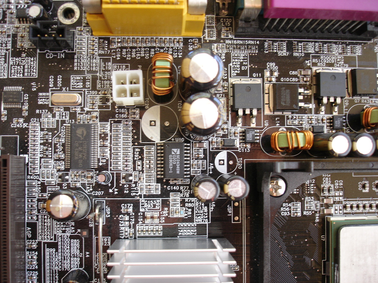

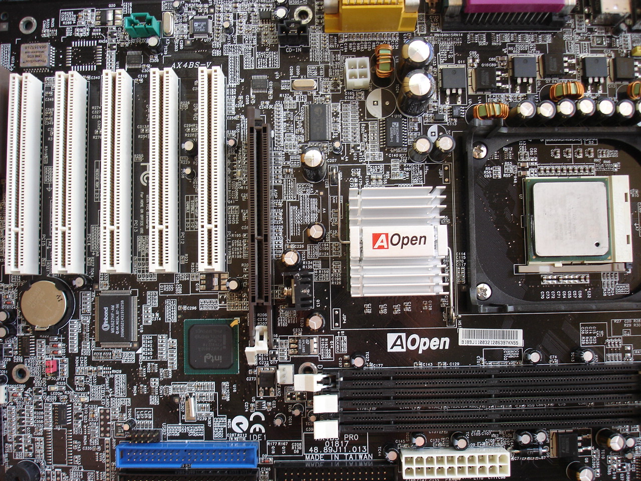

    AOpen AX4BS Pro with bad Lelon caps
    Nicely built P4 board which uses SDRAM - worth preserving
    Spoiled by Lelon RXA caps - 2 of 2200uf 16v and 1 of 1500uf 6.3v
    Other caps are Panasonic FJ 2200uf 6.3v and Chemicon (?) TMZ 1000uf 6.3v
    Talk about spoiling a nice board by scrimping a few cents

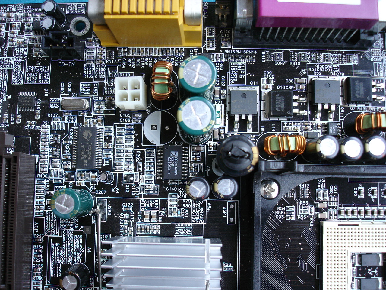

    Re: AOpen AX4BS Pro with bad Lelon caps
    Lelon replaced by same spec Sanyo (tested on ESR meter) from donor boards - all working well
    One of the big Lelon propped upside down in the pic to show its split bung
      I got sent here from your GA-8I915P Duo motherboard thread.
      Yes, epic thread revival, I know.
      Anyways, this seems like a decent old board. Are those Sanyo caps next to the 4-pic CPU connector legit, though? Their vent suggests fake Sanyo. Also, there is a free spot next to them. Should have inserted another cap there for extra filtering.
      • Wester547
        • Nov 2011
        • 1268
        • USA.
        ^ 12.5mm and larger diameter Sanyo (Suncon) capacitors have always used the overlapping X in lieu of the typical K vent stamp. Now, if it was a regular + vent stamp, they'd be fake. The replacements look to be the WX series, which is certainly worlds better than the very horrible Lelon RXA series.
          master hoarder
          • May 2008
          • 12175
          • Bulgaria
          Got it. Thanks for the info, Wester.
