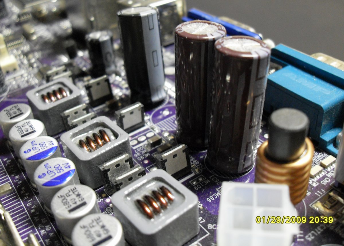

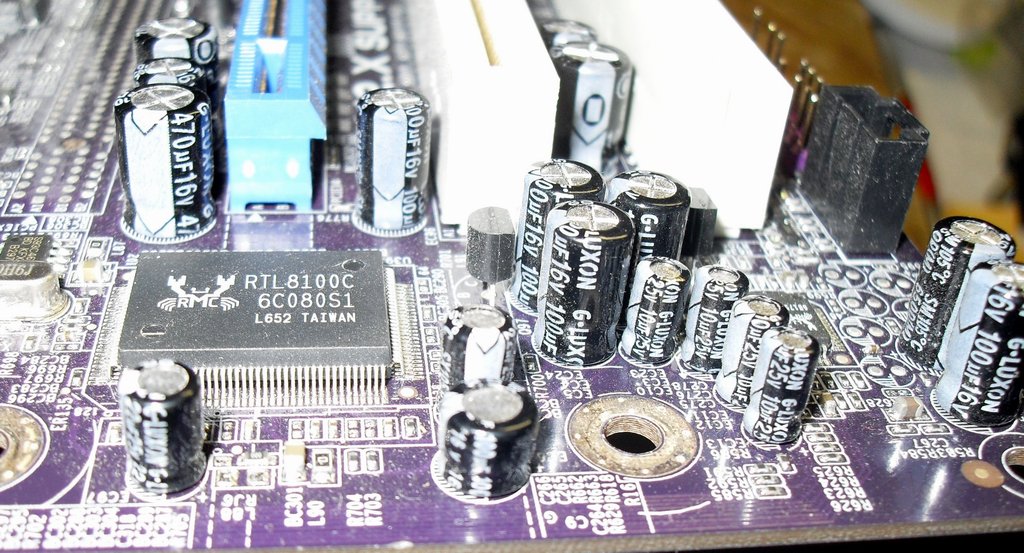

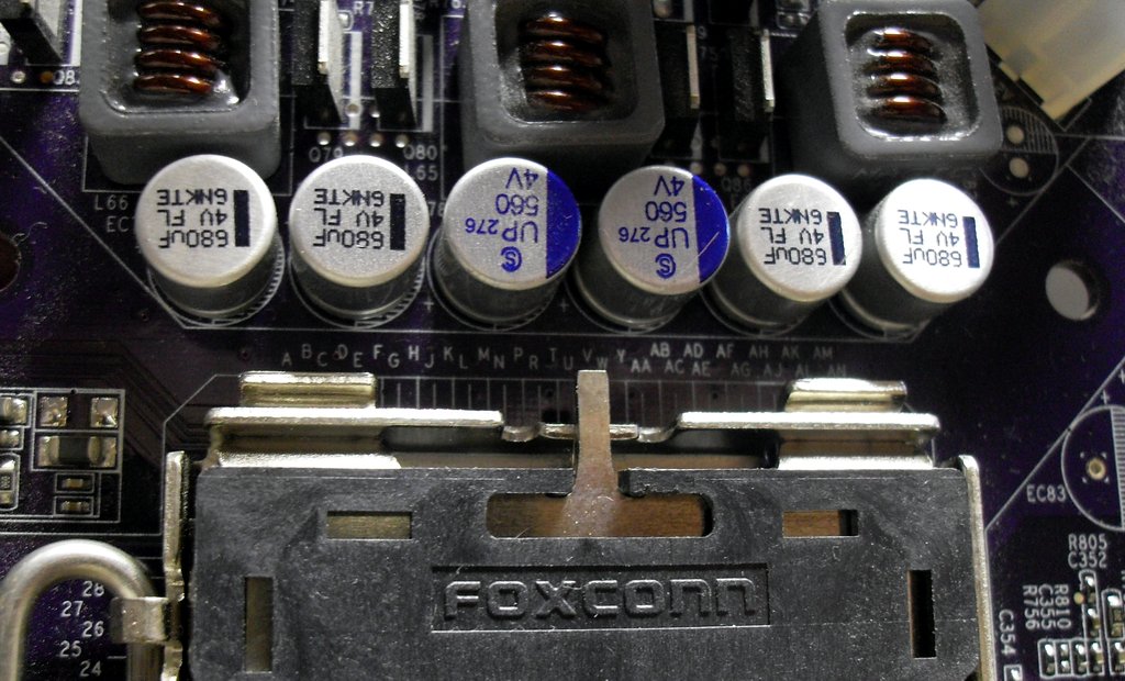

    I have an ECS 945GZT-M board that was working really good on my son's PC. Then one day he told me that the computer was making noise all night. I saw it from afar and no leds were turned on (from the first pic you can tell that it is easy to tell if the computer is on or not ). Then I checked and the fan on the PSU was on. That PSU is (was) a BesTec 300w and I was thinking on changing it, and that was the perfect opportunity). Then I installed another and the same : computer would not turn off. Also, sound died : no errors, no driver problems, just no Audio output.
    Most caps are G-Luxon, and three 16v 1800uf near the CPU are TK. Seeing a thread about an 865 with TKs (Fry's Mobo with TKs thread , I think I'm going to give it a try. I replaced one so far with a Rubycon MBZ I found from a dead Dell GX240 board, and I think I should have some more. But any idea on why it does not power off? It is stable and except for not having sound (which I don't really care) it was working good.
    Any feedback would be really appreciated.

    Re: ECS 945GZT-M would not power off. Sound died also.

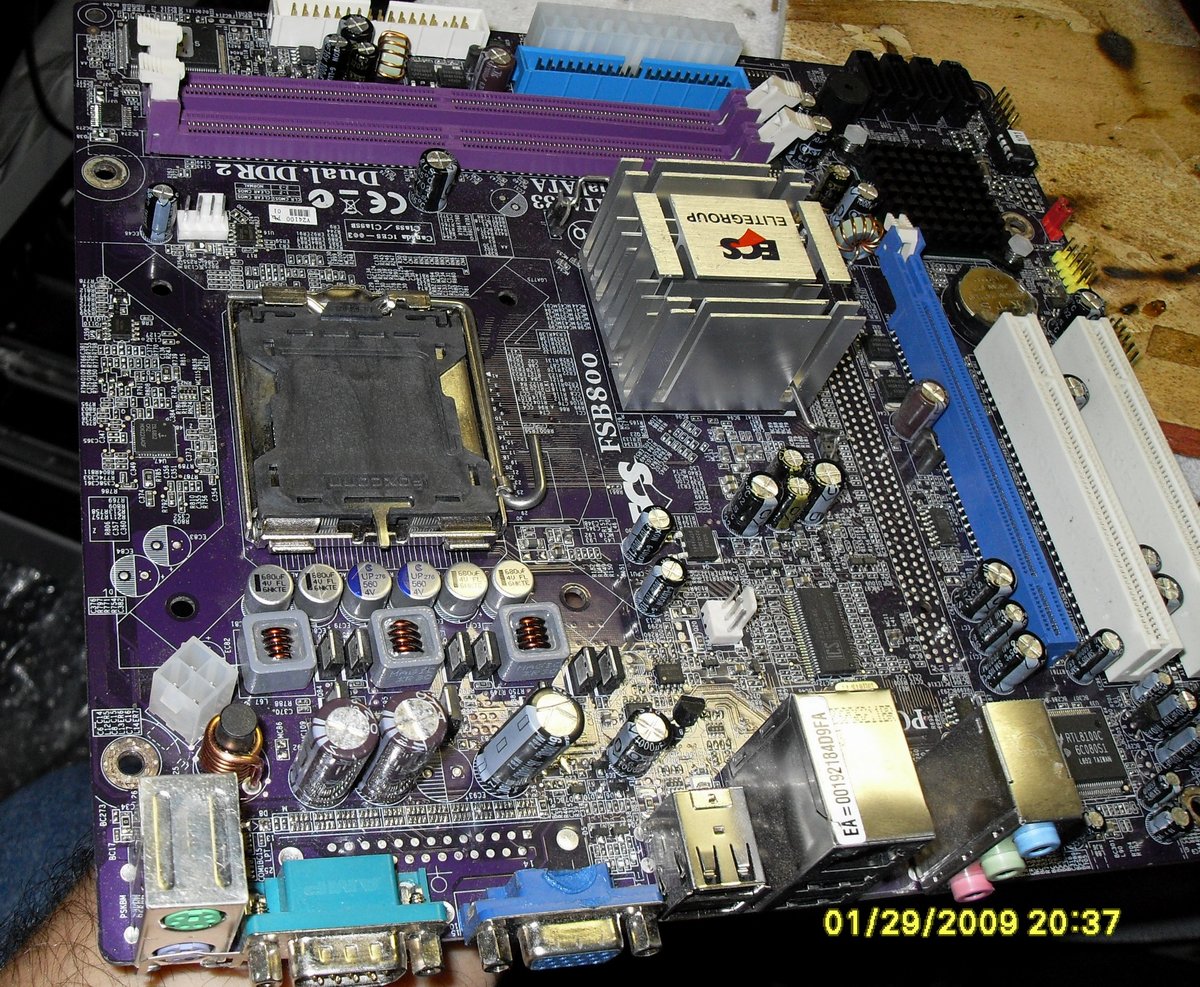

    two more photos. Hope this helps. If needed, I can post additional pics of needed area, or more data, as needed.
    Eduardo.

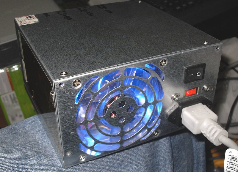

      bet the bestec killed the southbridge.
      +5stby overshoots.

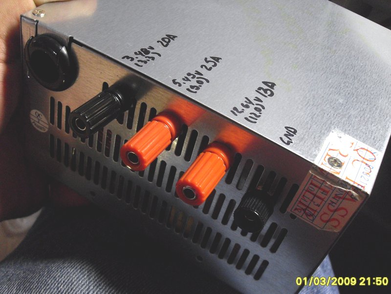

            Originally posted by bgavin
            Some folks are not aware that you have to push AND HOLD the power button at least 5 seconds to force the hardware to turn off. I'm just asking this question to make sure this is being done.
            I've been assembling PCs for 15 years. Believe me, I know how to turn off a PC either an AT or the "new" ATX ones. I have heard about the standby power problem on that brand of PSUs, but honestly, as the rig was working good when I got it I never paid attention to it immediately, but ordered a replacement/upgrade PSU, just didn't had the time to swap it until the first problem showed up. Then, after that, I still used the MB to test components.
            The PSu has donated it's case to a better cause, as you can see in the pics. Now I have a generic 3.3, 5 &12v PSU to test monitors with (12v), just have to attach tips (which I have many, of different sizes, built by me with RShack tips).

                Still, the MB is dead. It is half way to the dumpster (after I remove all the caps on it). I really don't know what to do with it. But if you are right and the South Bridge is shot, I guess I can't do anything, right?

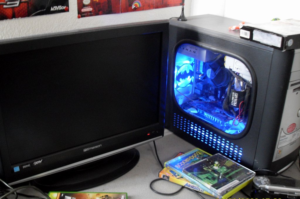

                                  I did that already : installed a Dynex 400w PSU, a side Window with blue Batman theme fan grill with blue leds, new board (first it was the ECS, now it has another ECS 945, but different layout), P4 2.8HT, 2GB DDR2 667, 160 HDD and a 19" LCD TV that serves his xBox, his TV needs (ATSC tunner) and the computer. The bestec has been dumped, except for the shell, and the board is on my bench. I just wanted to try to revive it. But I guess it will not be a good idea after all.
                                  The kid loves the way the computer looks, by the way.

                                      bestecs are fine once recapped.
                                      just get that 10@50 in the +5stby.i use a 22@50 fc.

                                        Removed the Rubycons previously installed to revive another board. This board is technically dead (for me, at least). It will be used as a wall decoration, maybe next to my Maxtor that has the plates exposed ..... what a shame, as It worked great before a bad Bestec came in its way ...
