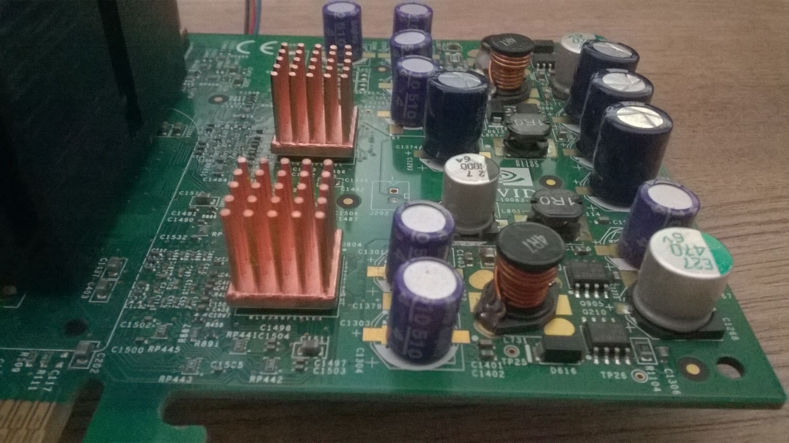

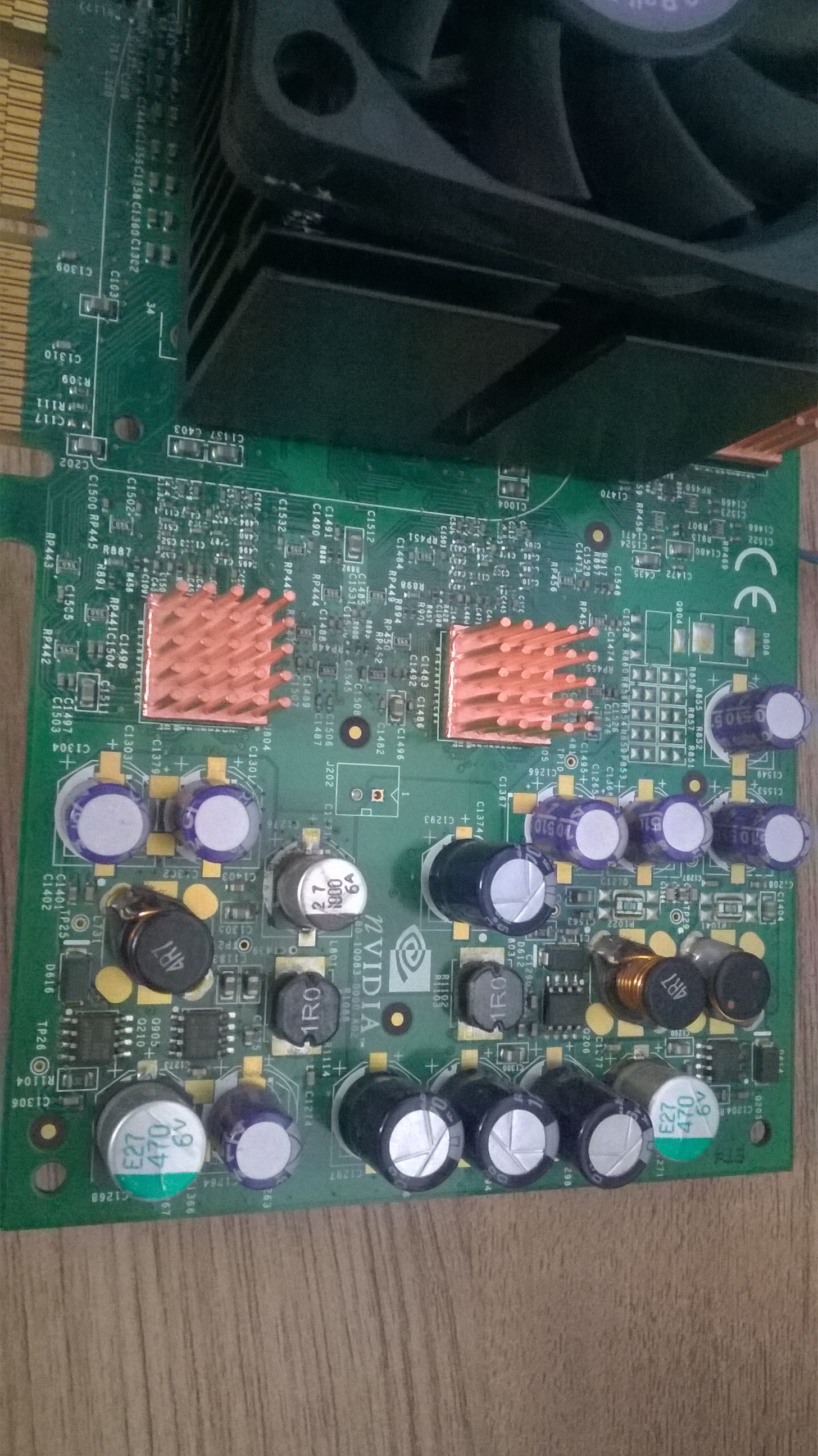

    Hi ,
    I want to replace all the capacitors on this video card and i have some issues not knowing the value for some capacitors.
    My problem is with those surface mount caps. Not sure what value i'm looking at

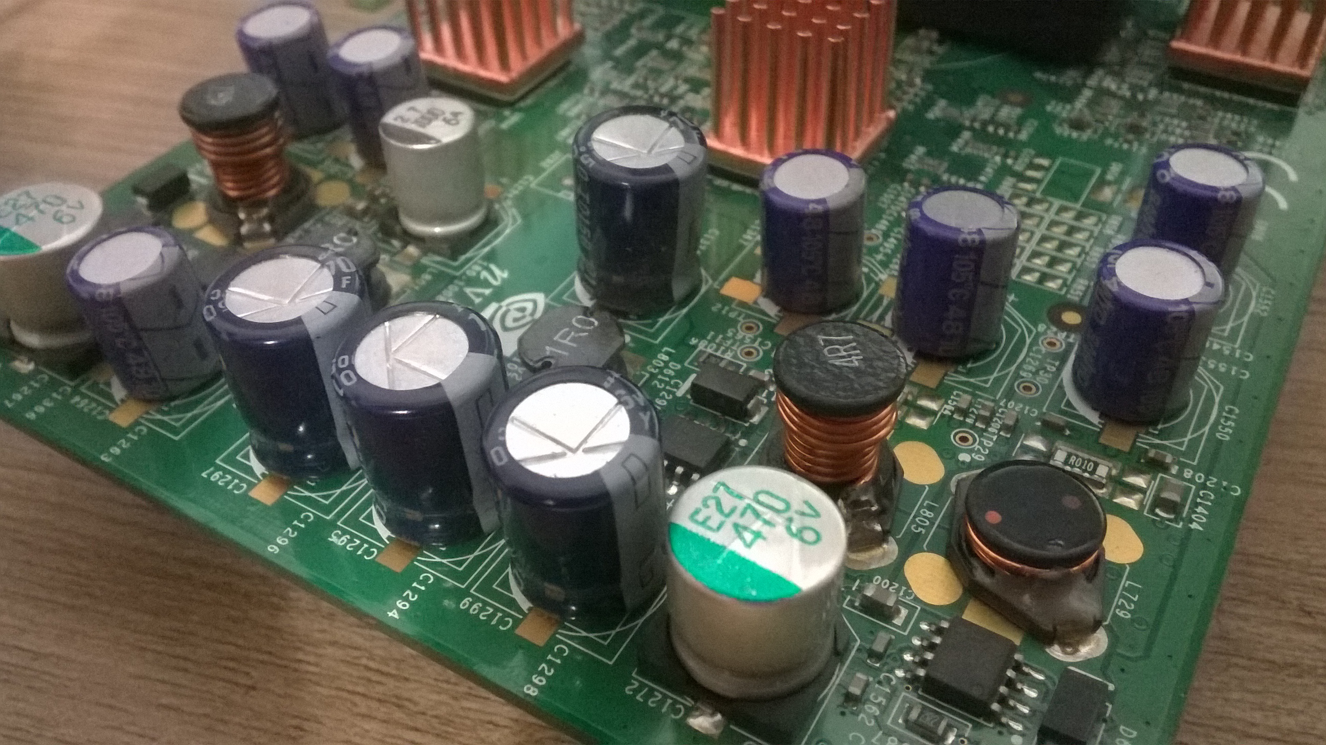

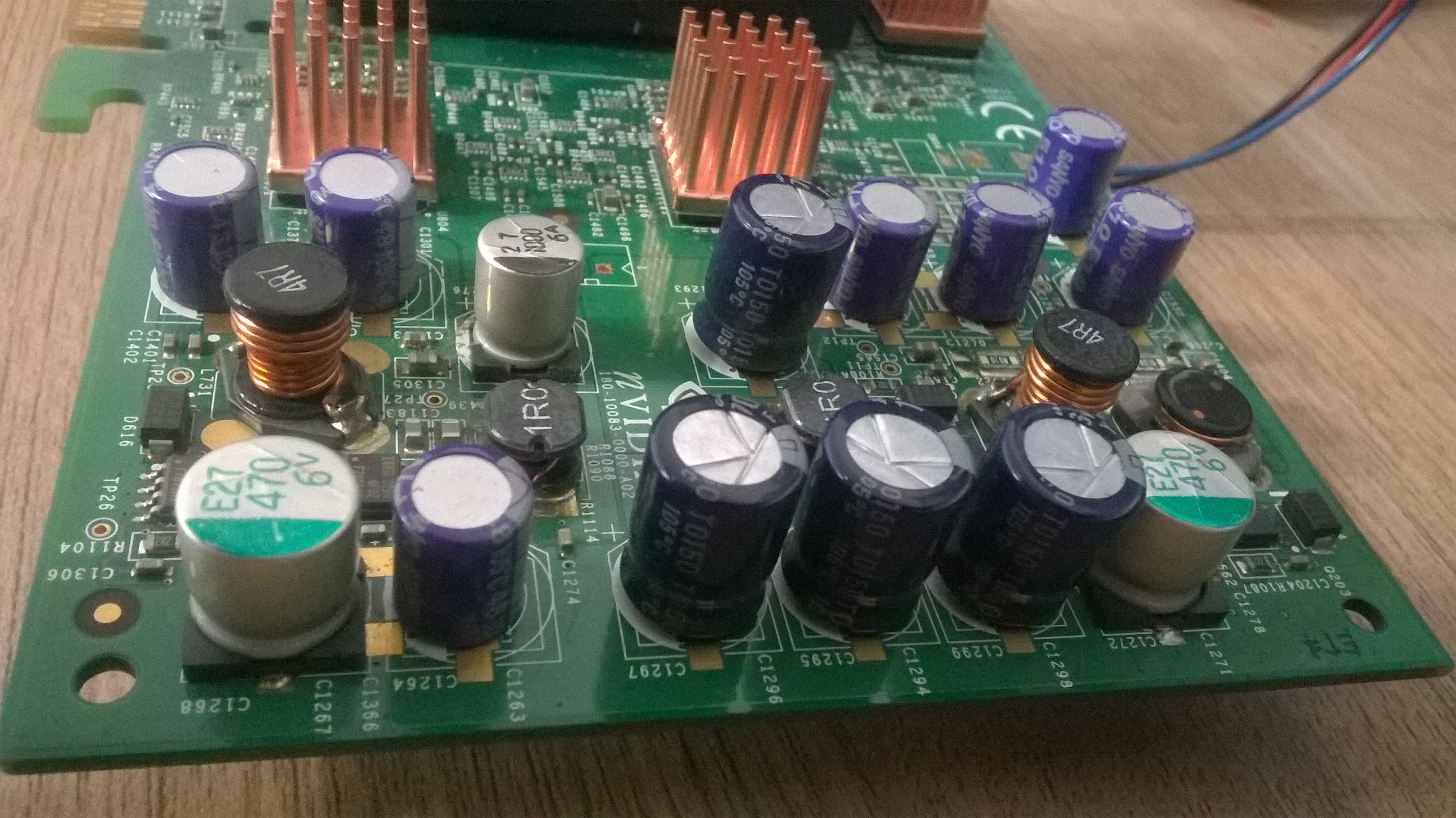

    The green-silver metallic one i think i know: 6v 470uf.

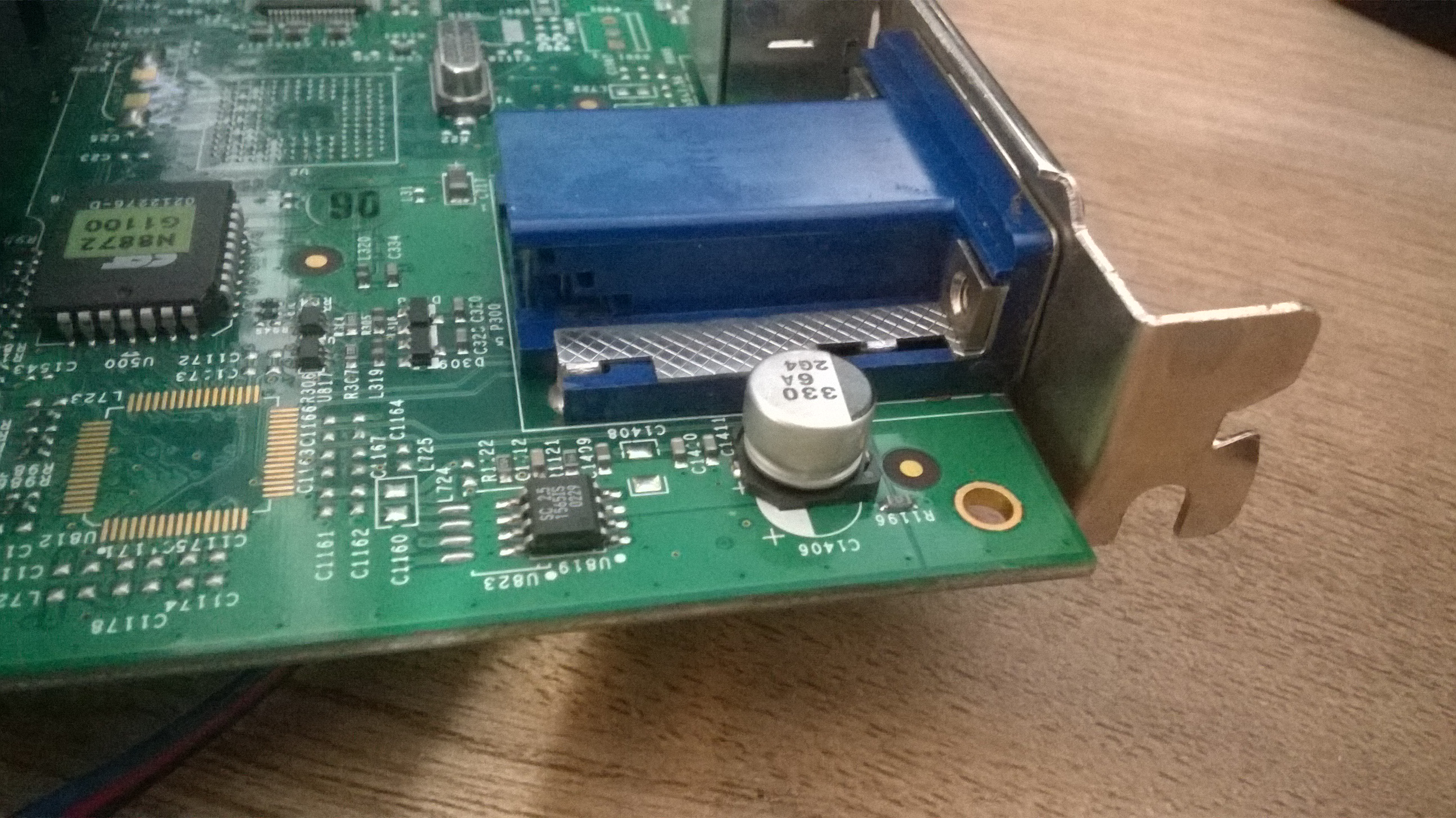

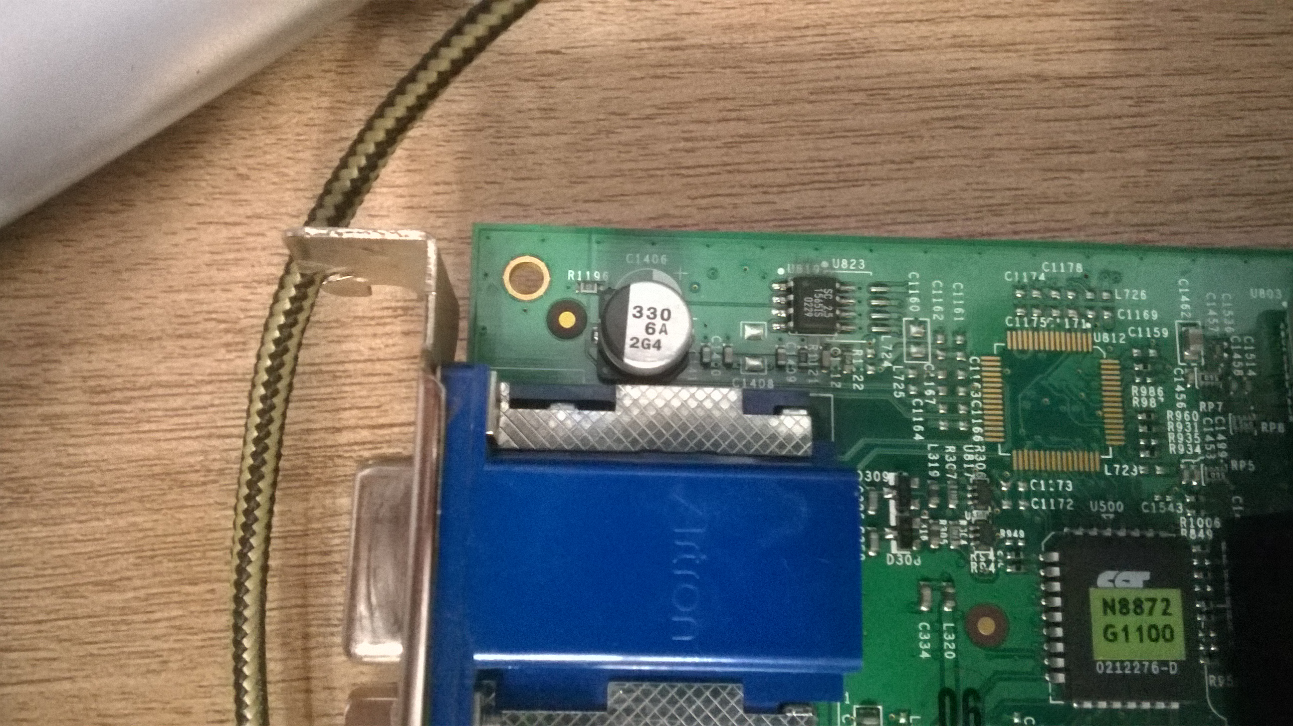

    But the black-slver metallic ones i do not know. Can anyone help me with this?
    (markings 330 6a 2g4 and 27 1000 6a)
    I've attached some photos for you to look at.
    Also i have some doubts about the blue ones: 4v 510uf. Seems a very odd value. Am i reading this right?
    Many thanks.

    your video card seems to use all good quality branded jap caps. replacing the caps is unneccessary unless u are experiencing problems with the card. if it aint broke, dont fix it. the bga on the card will probably fail first before the caps.
    anyway, 330 6a = 330uF 6V
    1000 6a = 1000uF 6V
    for the sanyo 510uF 4V caps, they are most likely custom orders. u can replace them with 470uF or 560uF caps. caps have a ±20% tolerance. 470 and 560 are within the original tolerance band of 510, so they will work fine.

      No need to replace those caps. They are all from high quality brands The memory chips will fail before the caps do.

        The green-silver metallic ones are not ok. You can see from the pictures that they are bulging or starting.
        This card is a bit modded and not overclocked(i bellieve what the previous owner said ). Bigger radiator on video chip(i looked at it and it seems it's CPU cooler glued,maybe some thermal glue, to the chip), custom coolers on the memory chips(these also glued). I think it will hold another decade.
        Anyway, beeing such a rare card i will poly mod it.
        Thanks all.

          They aren't bulging. It's normal for them to look like that.

            Basically, your video card has good capacitor on it, so no need to change anything.

              Ok then. You all conviced me to let it be. I will not change the caps anymore.
