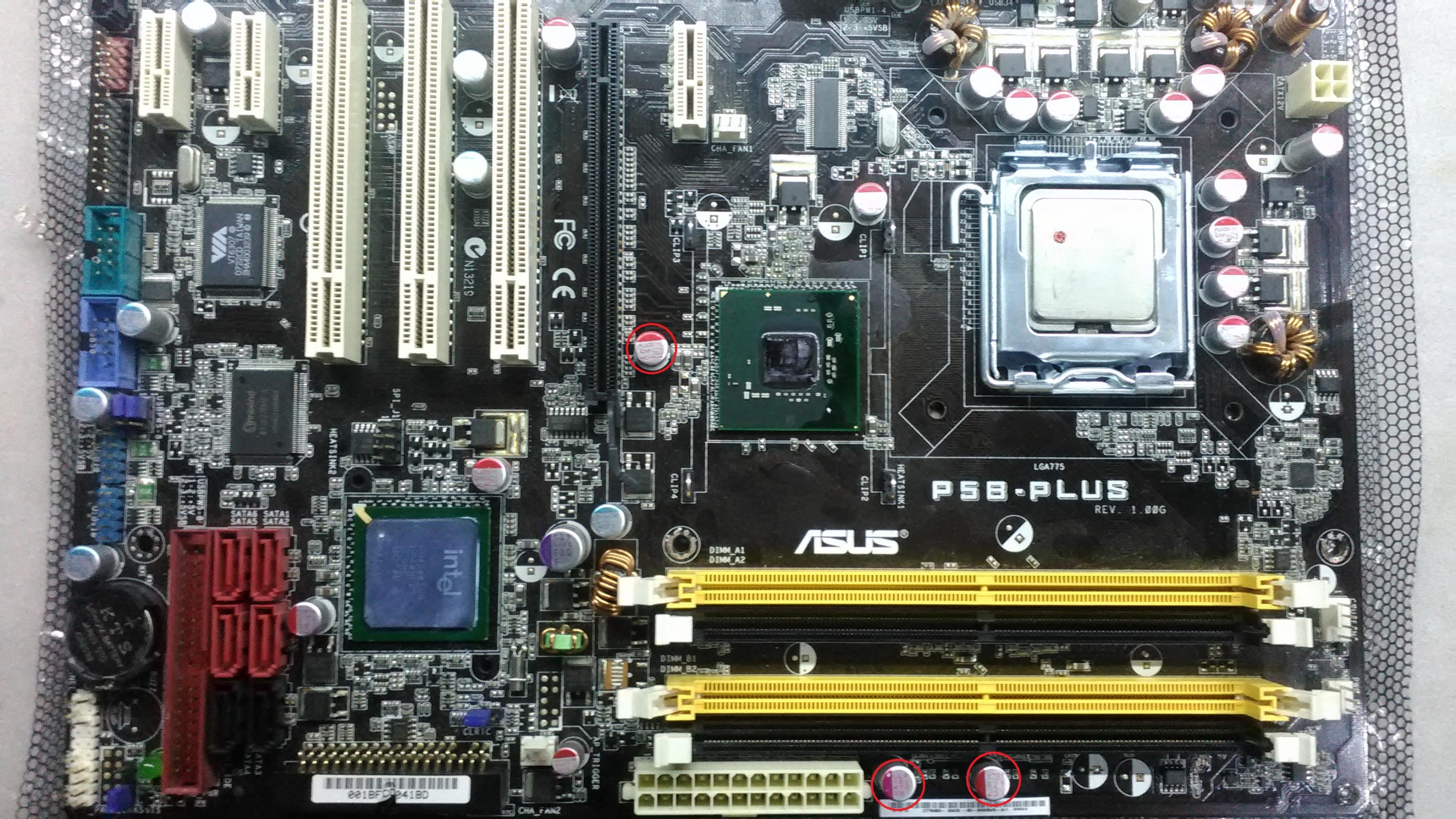

    I got an Asus P5B-PLUS motherboard witch wont give me picture. The CPU fan is working, the led on board is on but the picture on screen never shows up. Graphic card works 100%.
    When I inserted pc analyzer it gave me these codes:
    D3D3 without any RAM memories,
    D7D7 with RAM memories (in all slots, few different modules,together or solo).
    AMI (D3)DMA controller #1,#2,interrupt controller #1,#2 disable. Video display is
    disable and port-B is initialized. Chipset initialize/auto memory detection about to
    begin.
    another PC analyzer code book
    Starting memory sizing next.
    None of these have any information on D7D7 error code. Any help will be appreciated. Thank you!

    this type of error typically indicates ram or memory controller issues. usually, u'd check for bad caps around the dimm slots and then check the voltage regulator for the ram. then the northbridge. maybe northbridge needs a reflow or the mosfet powering the northbridge went bad.

      Checked the fets, they seem fine. I replaced the two caps near DIMM slots, same result. Reflowed the northbridge - same results. After replacing one of two caps near northbridge pc analyzer outputed 4040 error.
      Preparing the descriptor tables next.
      Preparation for virtual mode test started. Going to verify from video memory.
      CACHE memory on and about to disable A20 address line.
      I'm guessing this is a step back... :/

        actually, its fine. for modern ami bios (i'm assuming this since its an asus board) based boards post-2002, its starts with the D post codes which is early chipset and ram, bootblock and bios flash initialisation. btw, the d7 post code means:
        D7 - Restore CPUID value back into register. The Bootblock-Runtime interface module is moved to system memory and control is given to it. Determine whether to execute serial flash.
        now u made it all the way to post checkpoint 40, which is almost there to mid-late post, so its an improvement. post code 40 means this:
        40 - Detect different devices (Parallel ports, serial ports, and coprocessor in CPU, … etc.) successfully installed in the system and update the BDA, EBDA…etc.
        this may indicate a mobo onboard device has failed and could be holding up the boot/post process. u have to find out which one is the culprit. note: it is possible for more than one onboard device to be bad and holding up the post process.
        btw, most post code booklets that come with post analyzer cards have obsolete info in them that pertain only to pentium pro, 486 or earlier bios. for 2002 or later pentium 4 or athlon xp boards, the post code booklets shouldnt be trusted. i have a post card and the post code booklet that came with it wasnt helpful at all for troubleshooting the modern boards i had.

            I'm reading what northbridge controls (communication between CPU,GPU slot (AGP or PCI-E)) and RAM. Could it be that I fixed the northbridge but in the same time broke RAM? Since I used not so exact cap to replace original ones.

              I have just returned the 470uF 6.3V (witch I replaced with 470uF 16V before) back to the board. And now my analyzer displays an 6060 error code.
              Code 6060:
              The DMA page register test passed. Performing the DMA Controler 1 base registar test next.
              DMA page register test passed. About to go for DMA #1,verify from display
              memory.
              At this point I tried to power it with graphic card witch gave me 6F6F error code. And playing with RAM modules and another graphic card result me in error codes 9898 and for the first time D4D4.
              Code D4D4:
              Uncompressed RUNTIME code.
              Chipset Initialization/auto memory detection about to begin. Check SIMM for
              mismatch.
              Returning to real mode. Executing any OEM patches and setting the stack next.
              Code 9898:
              Clear all Interrupts.
              All Interupts cleared.
              Control to optional ROM
              Optional ROM control is done. About to give control to do any required
              processing after optional ROM returns control.
              No info on AMI 6F6F code.

                  anyway, codes 60 and 98 are almost to late post just barely before it displays stuff on the screen. code d4 is back in early post and is testing base 512k ram (ram initialisation) and is a major step back. have u tried reflowing the southbridge too? maybe it needs a reflow as well seeing how something onboard is holding up the post. if post is successful, it should display the 3738 post code when it is able to display bios boot/post messages on screen.
                  • Morsus
                    • Nov 2016
                    • 96
                    • Serbia
                    Re: P5B-plus d3-d7 post code
                    Thank you a lot.
                    I reflowed the southbridge too after witch I got an 4040 post code back. After that I replaced that one cap next to northbridge again. And now the analyzer gives 1010 to me.
                    In your tables it says "Waking up from sleep state". Im guessing its stuck in sleep so it does not turn on or something like that. I tried clearing the bios but no luck.
                    Any ideas?
                    • ChaosLegionnaire
                      HC Overclocker
                      • Jul 2012
                      • 3264
                      • Singapore
                      this board looks like it has been damaged by too much ripple from a junk power supply. did u get the whole system or board only? see if u can confirm if a junk/unknown brand psu was used? if so, make sure u use a good quality branded power supply. unstable power can cause issues like that.
                      i recommend replacing all the caps around the nb/sb/dimms and cpu. the flash memory in the bios chip can also be bad and start losing its contents if the power supplied to the chip was unstable. either swap to a new bios chip or reflash the bios chip with a serial flash programmer.
