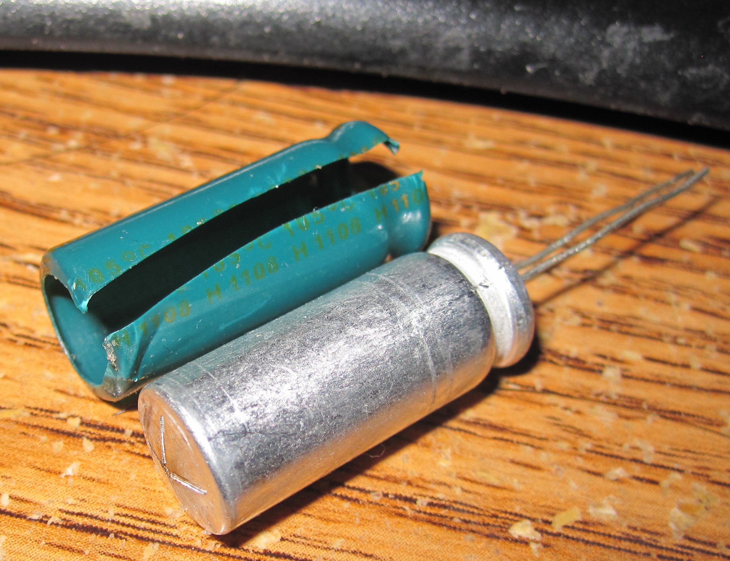

      Yeah it's those same fake 16V "Nichicons" that gassed at 12V. I haven't tossed them yet, but they did serve their purpose as sacrificial caps. These caps that I'm replacing are running at 1.3V.
      Hmm. I might go ahead and disassemble one of those fake "nichicons".

        Off topic but for anyone interested
        Fake "Nichicon" heat shrink removed.

          Thanks. Sorry, I didn't mean to have you disassemble one for nothing. I was thinking of the third one in your thread, actually (the one with the "thickest" sleeve), but you may have already used it for experimental purposes rather than sacrificial. Then again, it's a Teapo (or NTE?) in disguise rather Sacon, in accordance to the thread (although I suspect the real voltage is underneath the sleeve). No worries.

            Don't worry about it, the one I sacrificed was the one that vented, so no loss, all gain
            I think they all have about the same thickness sleeve, it might appear thicker due to an optical illusion.
            BTW, the one I cut open was a "type 3" but not the one pictured on the other thread. Just matched the rubber bung on the bottom.
            (Now the question is whether it should be dissected further...)

              Oh, type 3 isn't Teapo in disguise then. Probably NTE.
              Well, it looked thicker from the bottom. I suppose the attached image is what I was thinking of (the type of "counterfeit" which is not among your counterfeit Nichicons). If you look at the image full size, it's obvious the sleeve "appears" to be way too thick to be a production anomaly or optical illusion.
