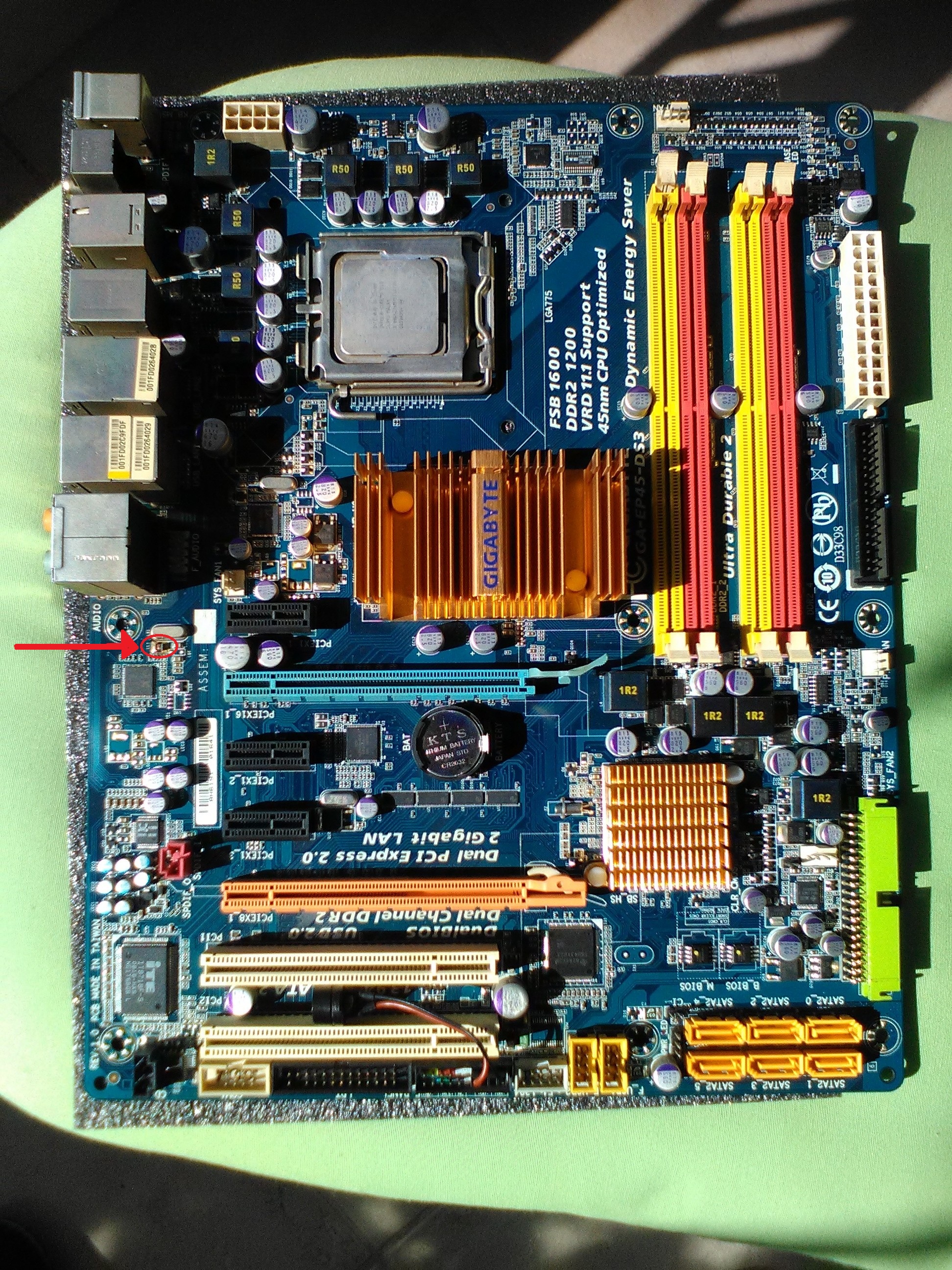

Hi Does anyone have a service manual for this board or could help me identify the value of the component in the foto?
Gigabyte GA-EP45-DS3

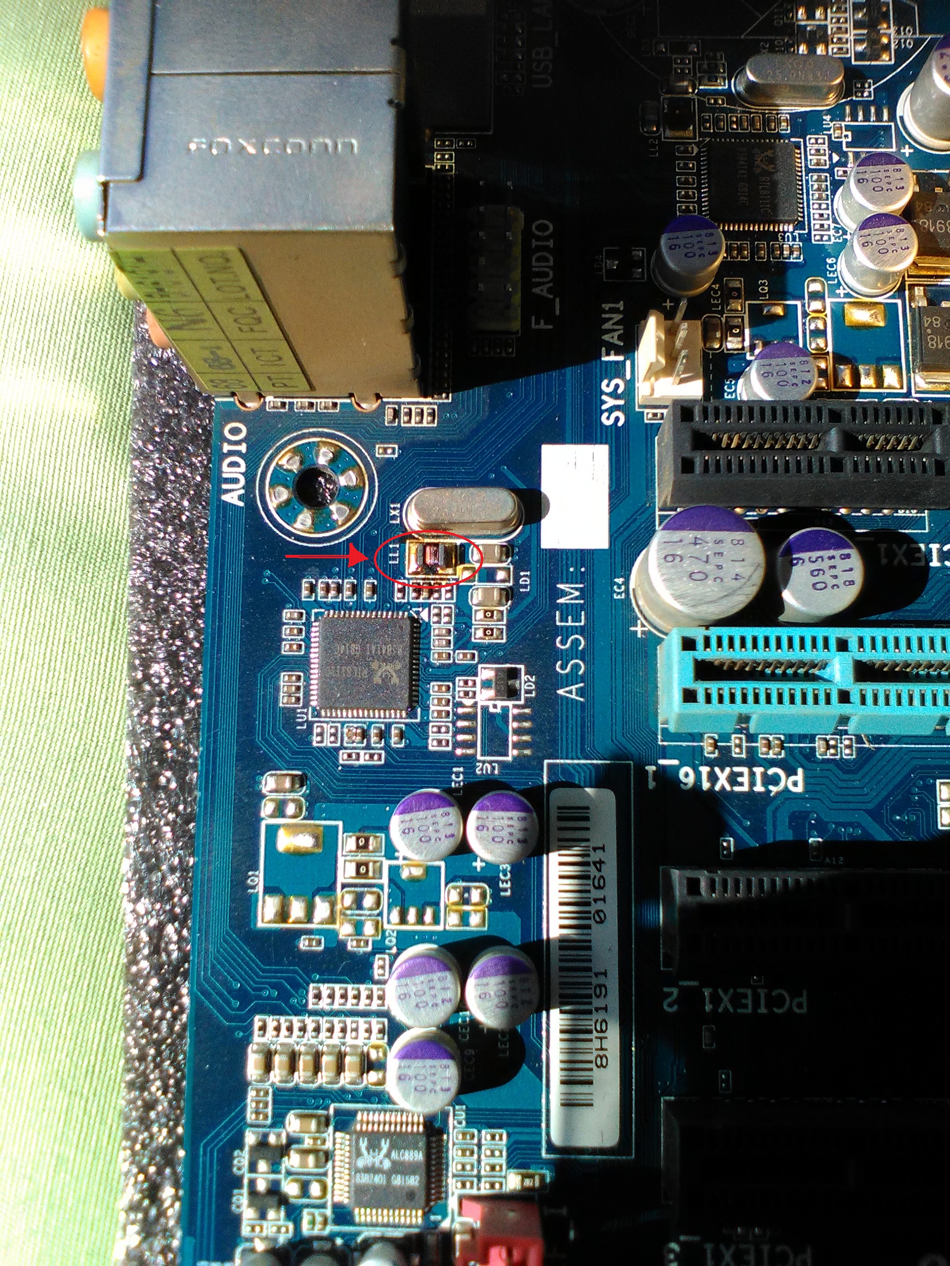

Re: Gigabyte GA-EP45-DS3
Some inductor,judging by the "L" in the component name. You can simply desolder it and bridge the connection altogether.Main rig:
It is a coil, is a supply line IC ethernet.
ic ethernet in the other connector, you have another exactly like coil, measures the resistance of the coil, and whatever the hell you, you put the same on the other ic.
But I fear that if burned, probably the ethernet ic is shorted, surely it will be burned by lightning..
But nothing happens, this motherboard has two ethernet connectors, whether the other port still work.Last edited by kevin!; 07-10-2016, 10:39 AM.Gaming pc:
Hi kevin! thanks for the reply! What do you mean with "whatever the hell you, you put the same on the other ic" . replace the inductor with the same value of the other ethernet port? can you point this inductor on to foto i have post? if you have a schematic i will appreciate thatIt is a coil, is a supply line IC ethernet.
But nothing happens, this motherboard has two ethernet connectors, whether the other port still work.Comment
Right above your top PCI-E slot there is a similar circuit for your other Ethernet port, The chip is labeled RTL811IC (some generic Realtek Ethernet chip) same as the one on the circuit you are trying to repair, measure the resistance across the unburnt coil in that circuit to find the value of the coil you want to replace. The coil is labeled LL2 you want to replace LL1. Hope this helps.Hi kevin! thanks for the reply! What do you mean with "whatever the hell you, you put the same on the other ic" . replace the inductor with the same value of the other ethernet port? can you point this inductor on to foto i have post? if you have a schematic i will appreciate thatComment
