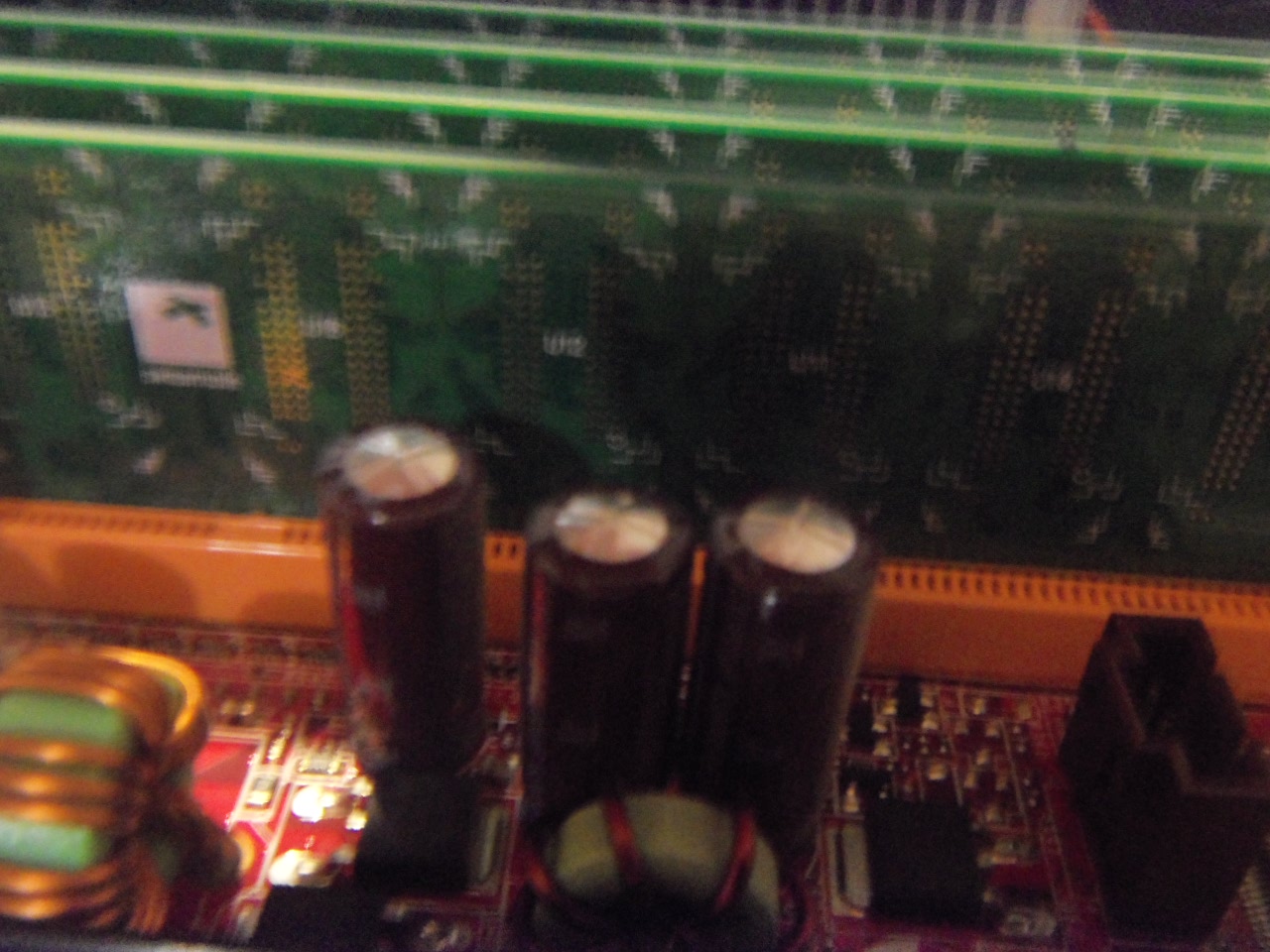

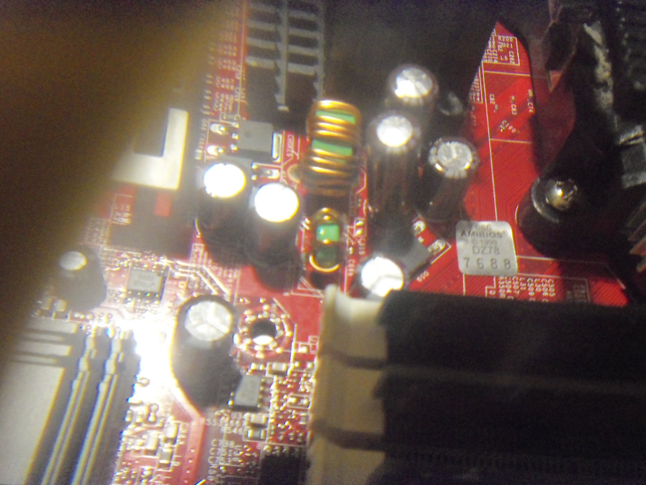

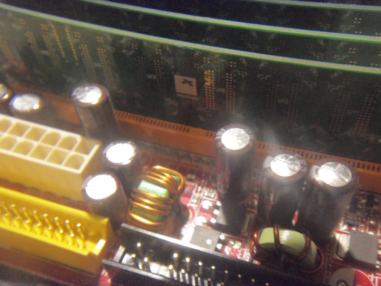

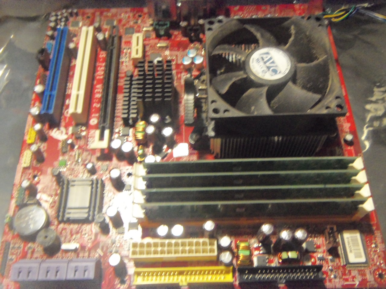

    MSI Motherboard MS-7501 Bad Caps
    Just a few pics of my motherboard. Bought some Rubycon caps to replace them.
  • Stefan Payne
    • 1267
    Re: MSI Motherboard MS-7501 Bad Caps
    Do you have a digicam? Those mobile phone pics are pretty bad, you can't see anything on them.
    Either way:
    Maybe you should go for polymer caps...
    • genghis1
      • May 2016
      • 8
      Yes, those pics are bad. I already have the new caps, so too late for polymer. The board has another problem - caused by me. I bricked it updating the bios. I read somewhere that the bios needed updated for windows 10 to work. I went to the medion website to get the latest bios but ended up with the wrong bios. Now it won't boot at all. So now I ordered a cheap bios programmer off ebay and am waiting for delivery to try and fix it.
      • genghis1
        • May 2016
        • 8
        Replaced caps and bios. All is good now. Thanks!
