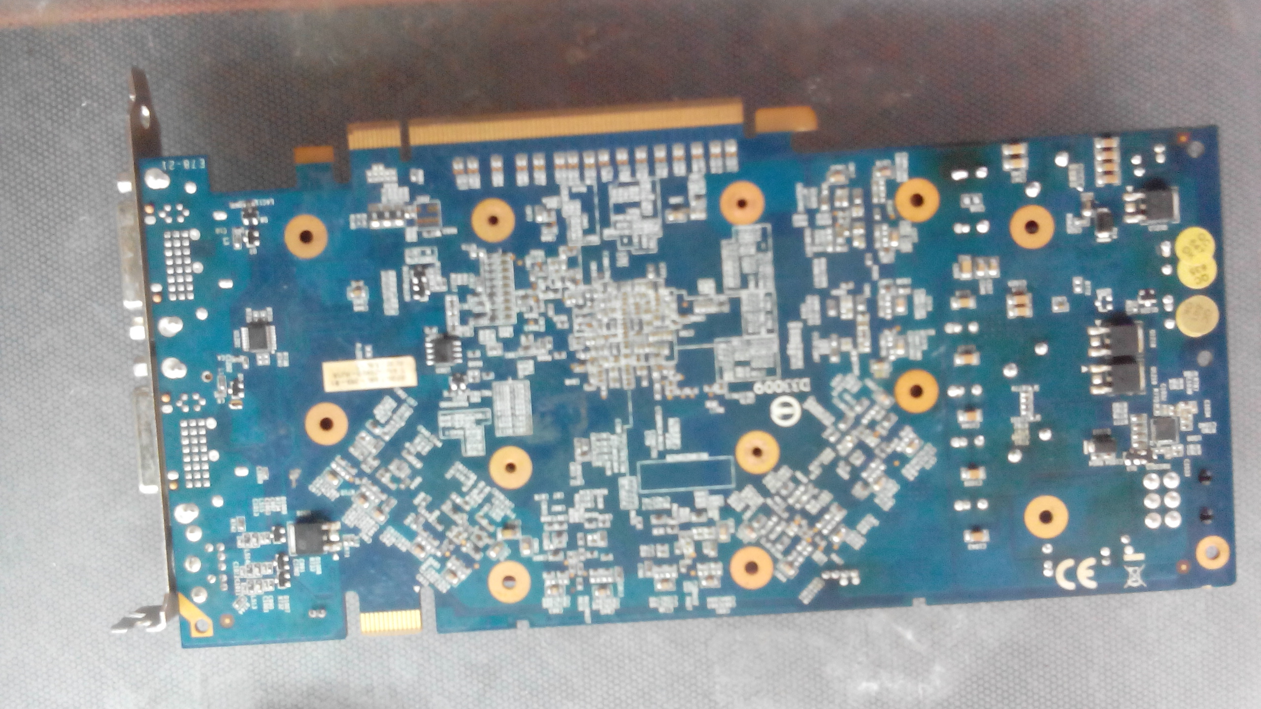

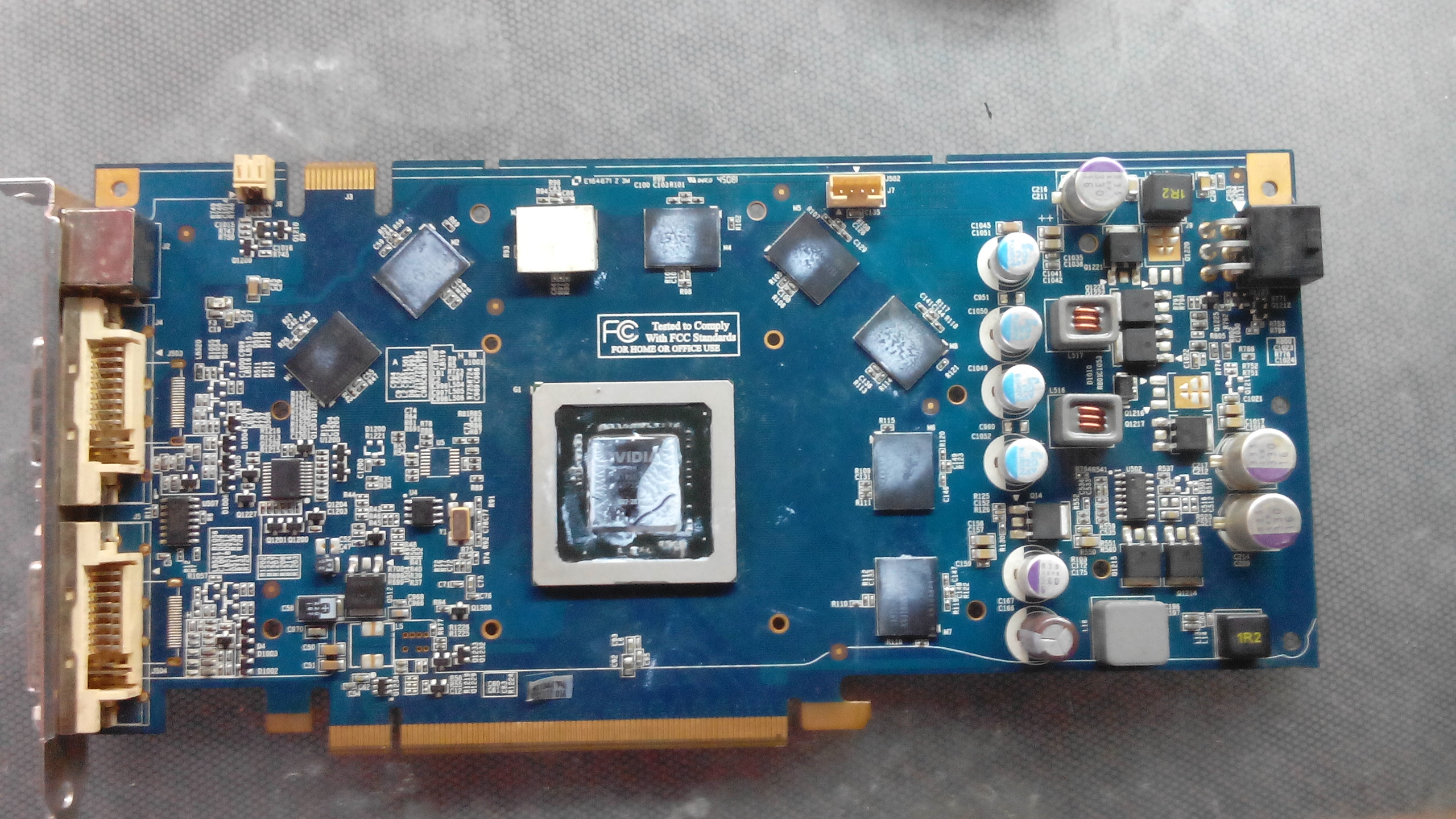

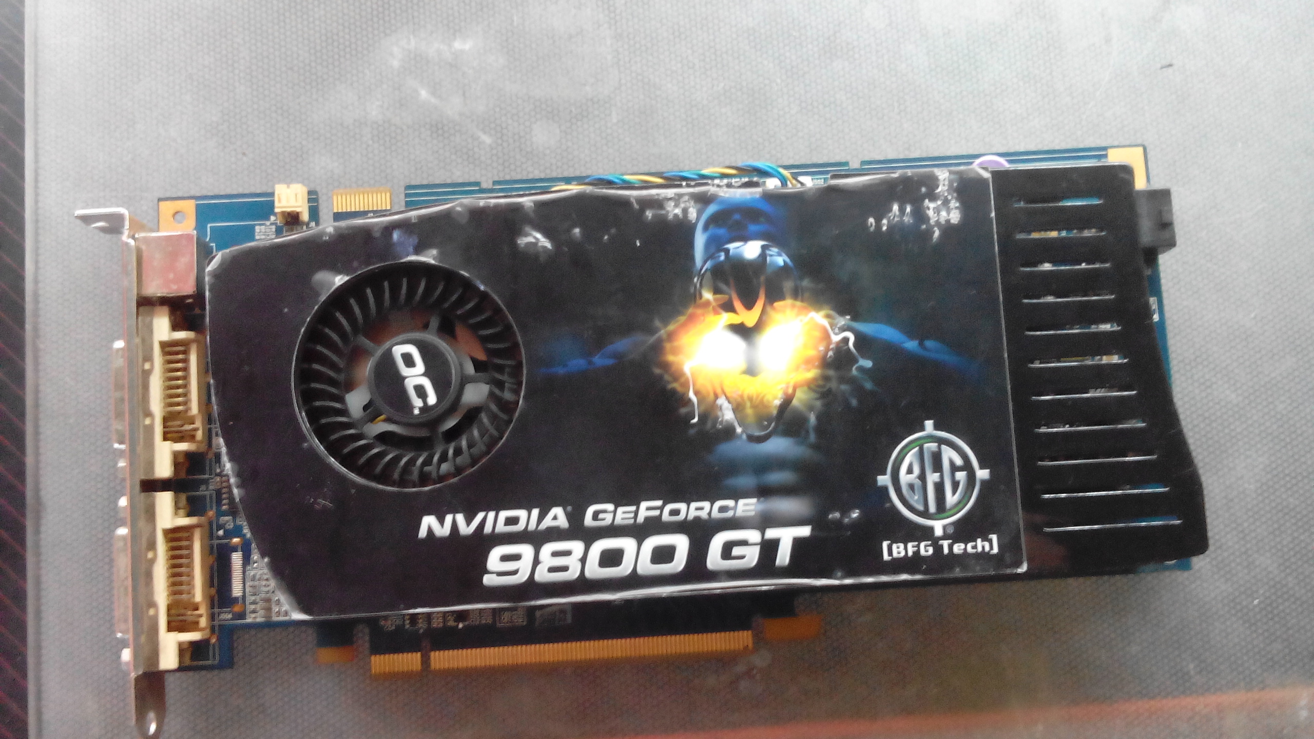

    hi guys i have a nvidia Geforce 9800 gt , when i press power button video card doesnt work, i mean fan doesnt spin, nothing happen, no video...can someone be kind of helping me fix these card...i already did a reflow nothing happen...where can i measure to know the problem..thanks....power supply atx is working good, the problem is on the video card..

    Your re-flow wasn't hot enough...
    If it was, that brown electrolytic capacitor in the bottom right corner would have bulged (That is almost certainly a Chemi-Con KZG series, which should be replaced).
    If you MUST use this card and are adamant about fixing it, then I suggest trying to re-flow it again, but this time squirt some liquid flux under the GPU BGA before you do, desolder that electrolytic cap, and re-flow it at the proper temperatures, following proper procedure.

      thanks friend, proper temperature would be 200 C would be ok, what do you think??

        385f or 196 Celsius about 6-8 minutes. 8800 ultra works fine now, I put it to oven 200 C
        about 7-8 min.

          The fan not spinning would suggest the card or fan (or both) are not getting any power. Reflowing won't fix that.

            No, proper temperature would be 225-235C. Ideally, when the temperature of the video card reaches 225-235C, it should stay like that for no more than 10-20 seconds. Then you turn the oven off and open the door *a little bit* to let out the heat and cool the card slowly.
            Lead-free solder melts at 217 Celsius, so you need at least that much for a proper reflow.
            Your 8800 Ultra likely got fixed because ovens are not 100% accurate with their temperature - they can over- and/or under-shoot by 5-15C.
