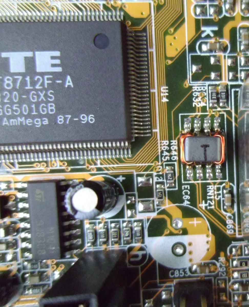

    What is this assembly on Abit SG-71 ?
    I think I recall this SG-71 not working, so I put it aside
    Having rediscovered it recently, I desoldered the remaining wires from the 8-legged IC, after which it did work
    Although neither of its USB ports, nor its LAN port, work - assembly in question is just beside those ports connector block
    So, what is it ? - an inductor glued to an IC, or what ?
    Speaking of glue, I've tried scraping it off, without success
    What can I do to fix it ? - rewind the core with strands taken from a cable, then resolder to the IC - or would those strands not being coated, be a show-stopper ?
    Or replace the whole assembly with something from a scrap board ?

    looks like a pulse transformer.
    i dont think it's a chip under it - just the original base.

      I'm also going with a transformer for the data pairs of the 100mbit network card. Use a continuity mode on your meter to find where those traces go, they probably go into that RTL8100 network chip.

        it's an inductor for filtering power to usb and lan

          Didn't get a continuous beep from any of those 8 legs, to any of the leads on the Realtek chip
          Two legs did give a brief beep to certain leads of the Realtek, similar to that produced when testing a Mosfet

            It could be also filter for USB data lines.
            2 pairs of D+ and D- located in same area as network socket.

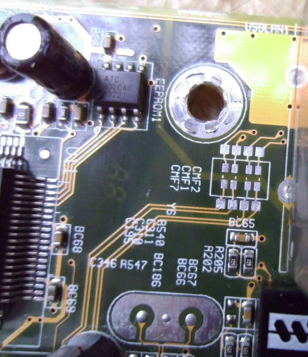

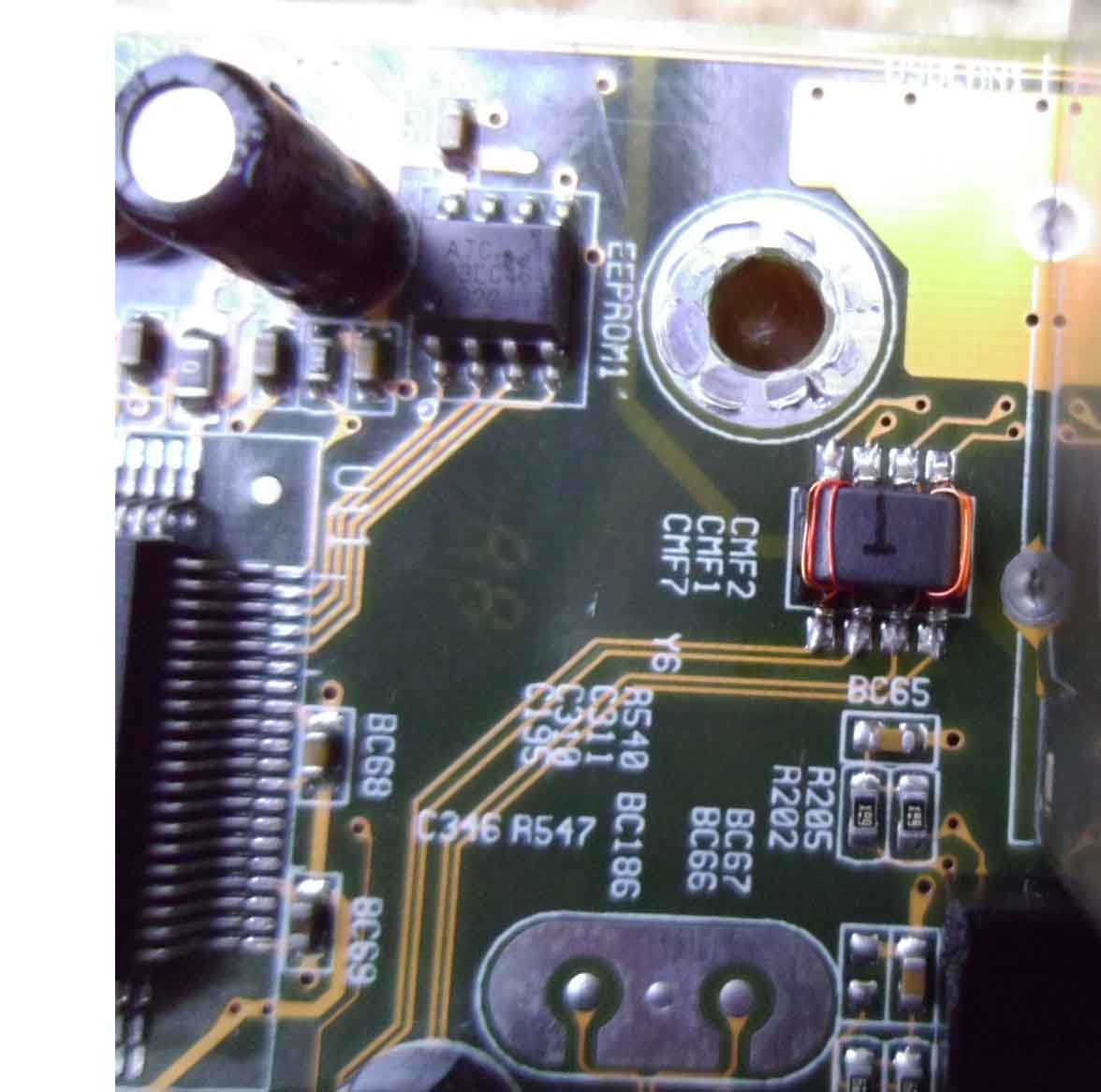

              I was too hasty opening this thread, thinking the assembly was unique to Abit
              Not so, examination of scrap boards produced donor Gigabyte GA-8LD533, same vintage as SG-71

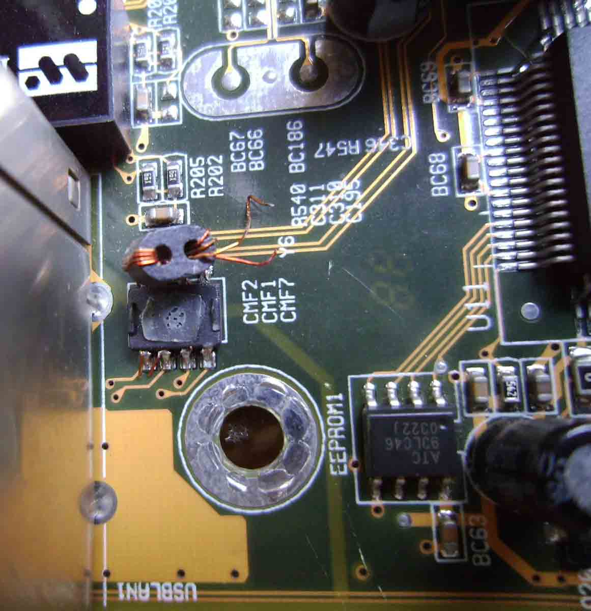

                Original removed from SG-71

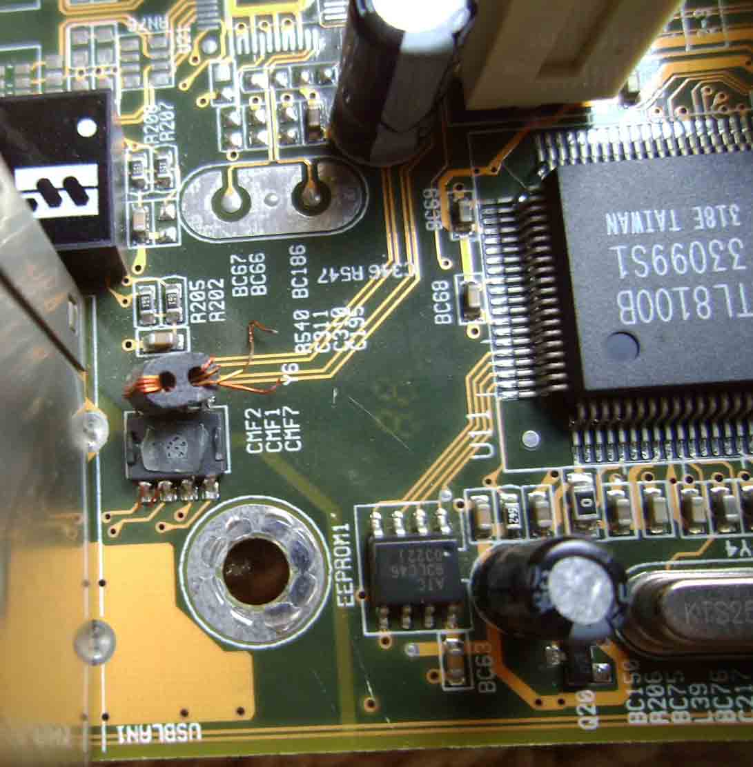

                  Re: What is this assembly on Abit SG-71 ?
                  Donor assembly transplanted successfully - LAN and USB ports all working now

                    interesting that it also has pads for individual inductors.

                      That looks like a "Common Mode Filter" something like this https://cdn.badcaps-static.com/pdfs/...1c67be10dc.pdf
