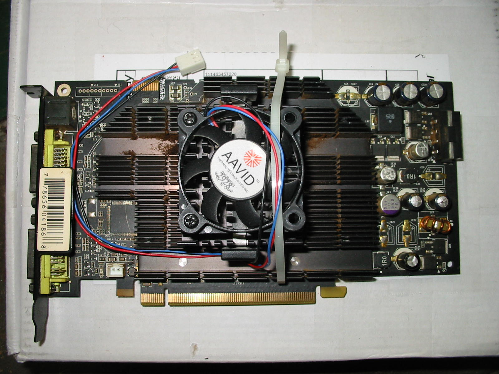

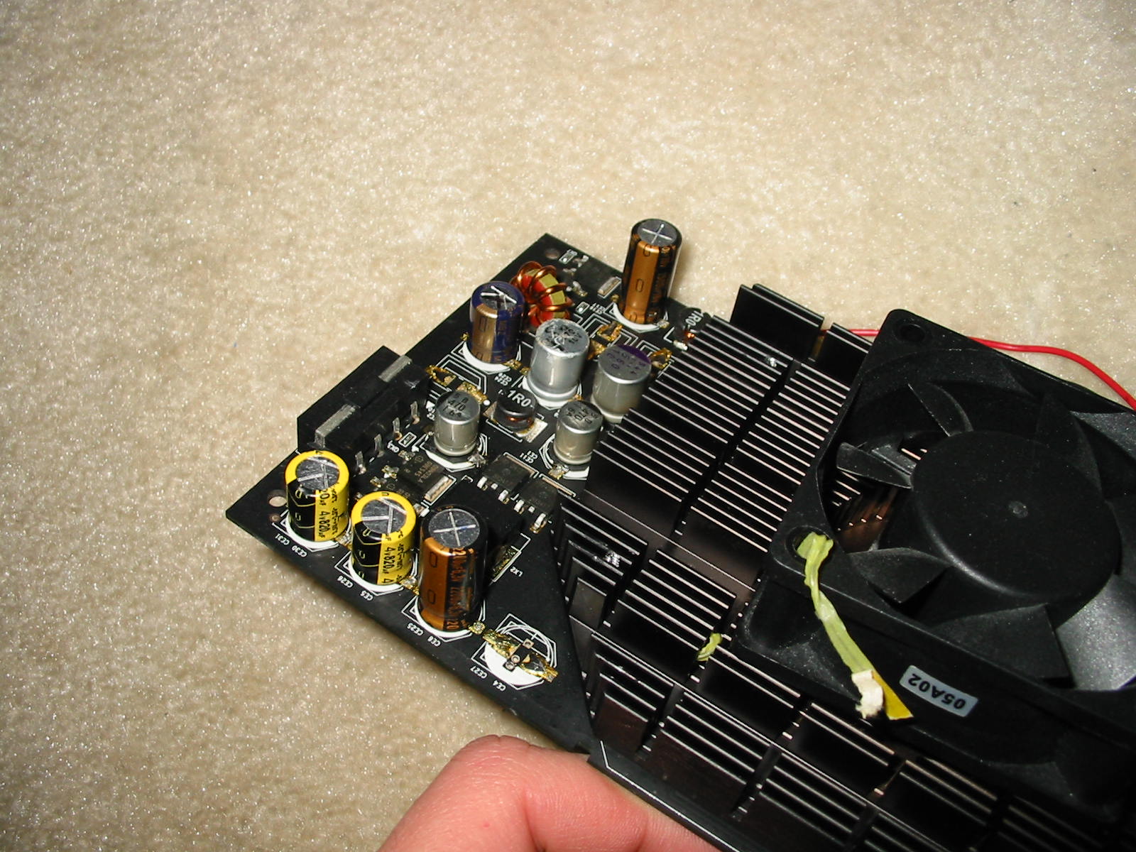

    So I bought this gem at the end of last summer on eBay (or thereabout). Why I haven't posted it earlier? Well, because I am slow and tend to leave pictures on my hard drive until they ferment a good amount before I post them . Anyways that moment is here and now.
    Ladies and gentlemen, brace yourselves, as I have another ghetto mod… except this time, I wasn't the mastermind behind it.
    https://www.badcaps.net/forum/attach...1&d=1444698583

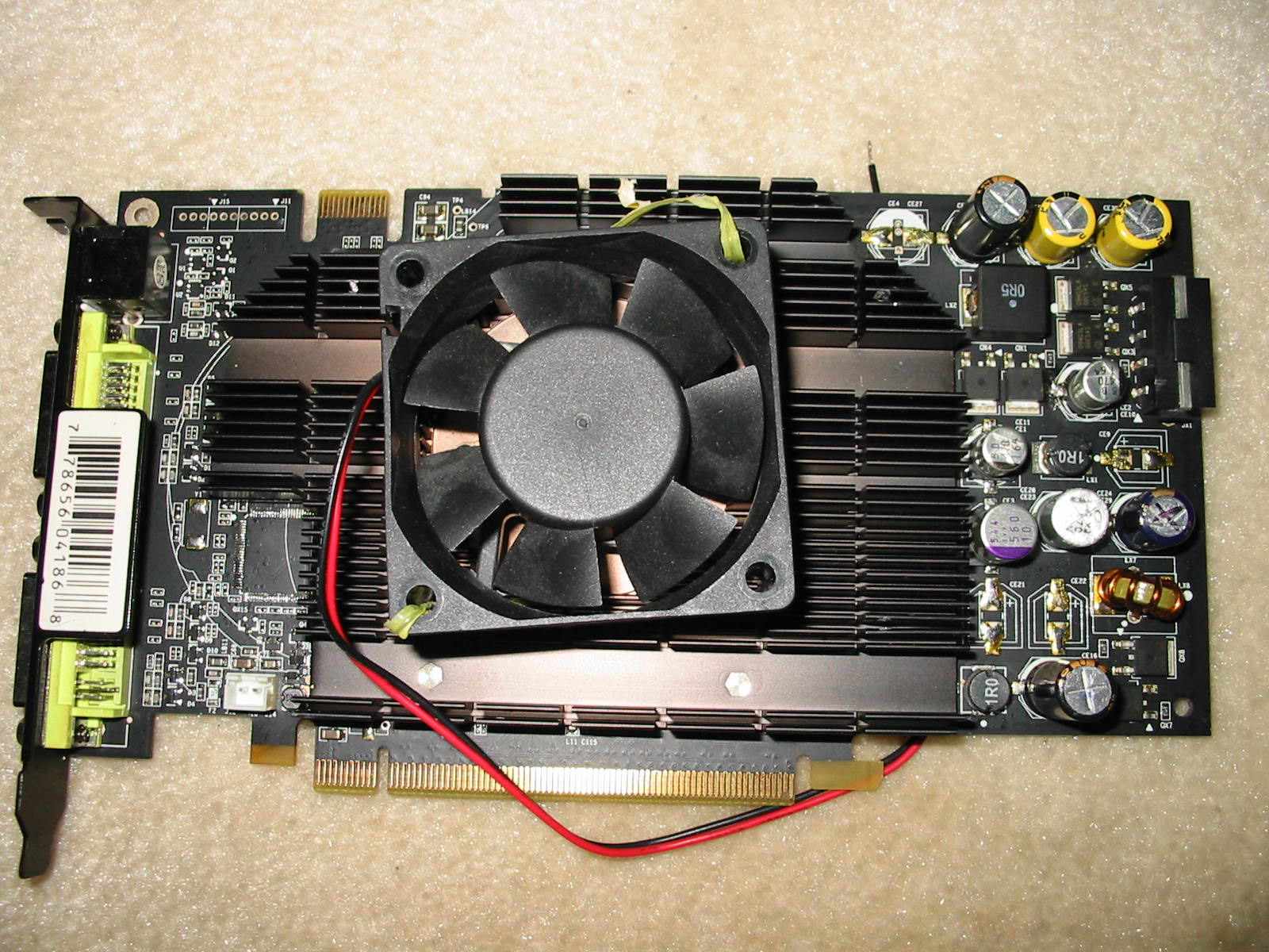

    So let's see what we have here:
    Old socket 370 cooler to cool the heatsink – check
    Zip ties – check
    Bulged caps - check
    Dust, dirt, filth, and some small dead roach bodies – check
    Awful smell of cigarettes that I am glad cannot be captured as part of the picture – check
    Now you may be wondering, why would anyone sane buy something like this? Well, maybe that's because I am not . That, and the fact that the auction started at just a penny and no one bid on it at all.
    So yes, I got this video card for just $0.01 – a great deal if you don't factor in the shipping (which was something along the lines of $8-12, I don't remember exactly anymore.) But what really interested me was the seller's ghetto mod. Moreover, he described and pictured this video card exactly as it was (minus the bulged caps, but I saw them before buying). He warned of the heavy cigarette smell, explained how and why the mod was done (original video card fan failed), posted GPU-Z screenshots of the video card running, and even offered DOA warranty. In short, he just said he didn't want to throw it away, since he had it running for a long time and so would rather someone find a home for it. Given that no one bid and that the video card had a lot of stuff to be fixed (but was otherwise functional), I decided to grab it just as a fun project.

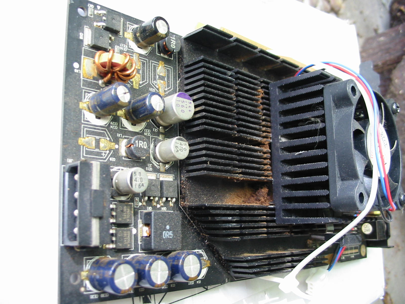

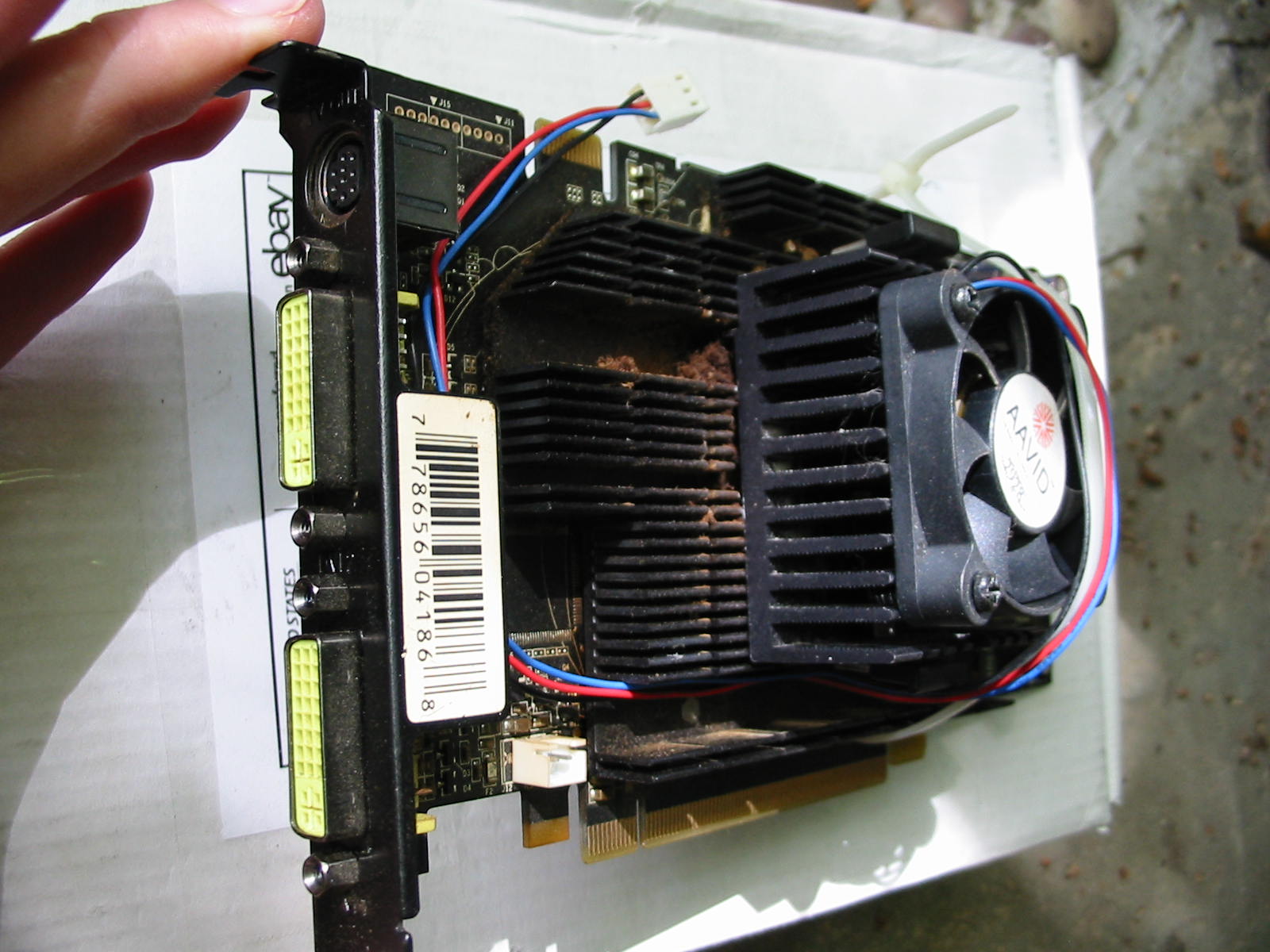

    When the shipping box arrived at my door, I immediately noticed the strong smell of cigarettes. So the first thing I did – take it outside for a wash. First, I removed the socket 370 heatsink and fan. Next, I put the garden hose on full tilt and gave the video card a good blast. Immediately, the card looked 100x better. Of course, there was still quite some room for improvement. Using an old tooth brush and a generous amount of dish detergent, I scrubbed every surface at least twice. After another rinse with the hose, the card looked great. Unfortunately, that was only as far as the visuals went. The strong smell of smoke was still there even after the wash. So, the next thing I did is I took off the GPU heatsink and gave the board a quick wipe with a bit of alcohol.
    Now that did the trick for the smell . The result of all of that cleaning:

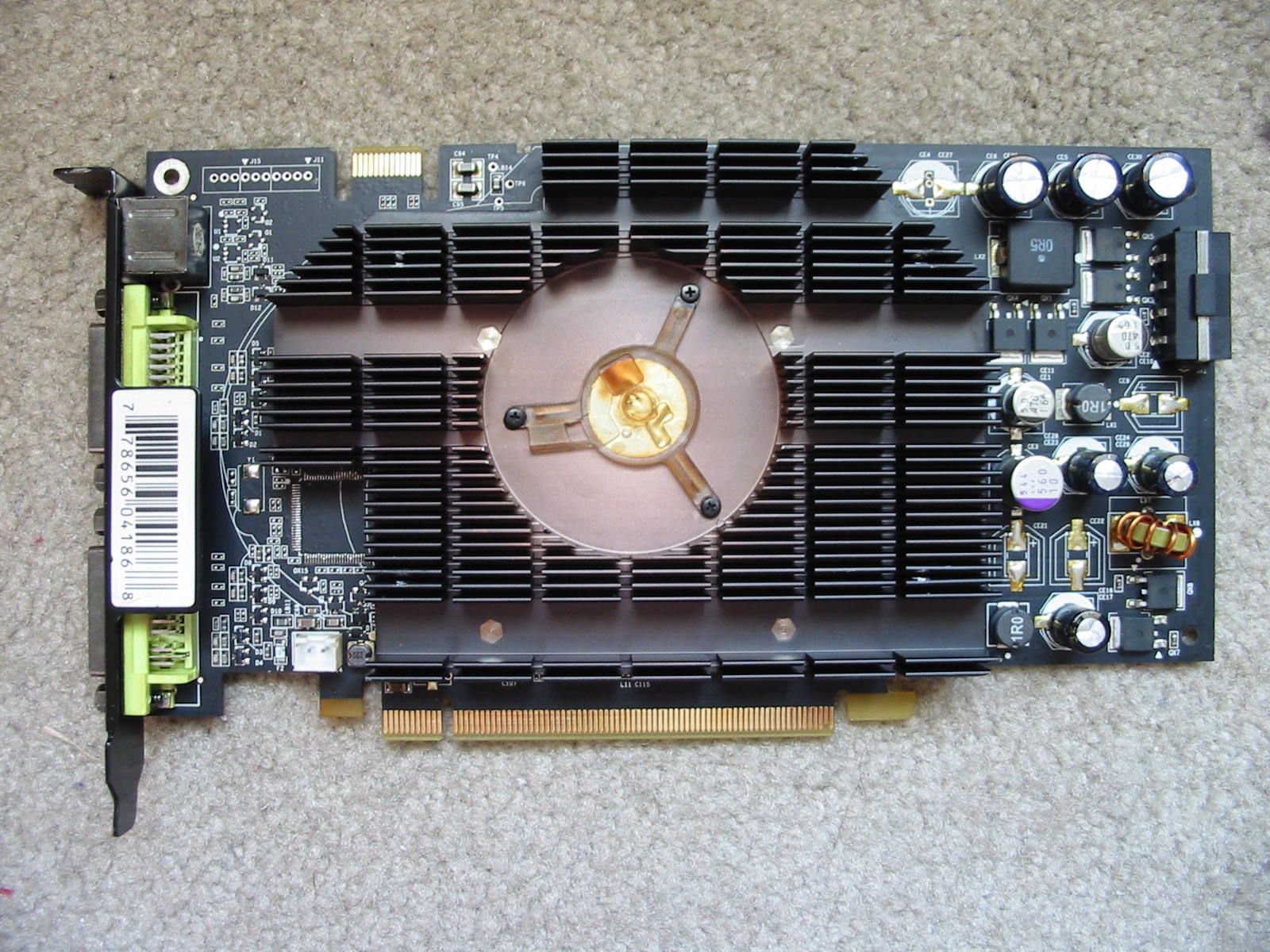

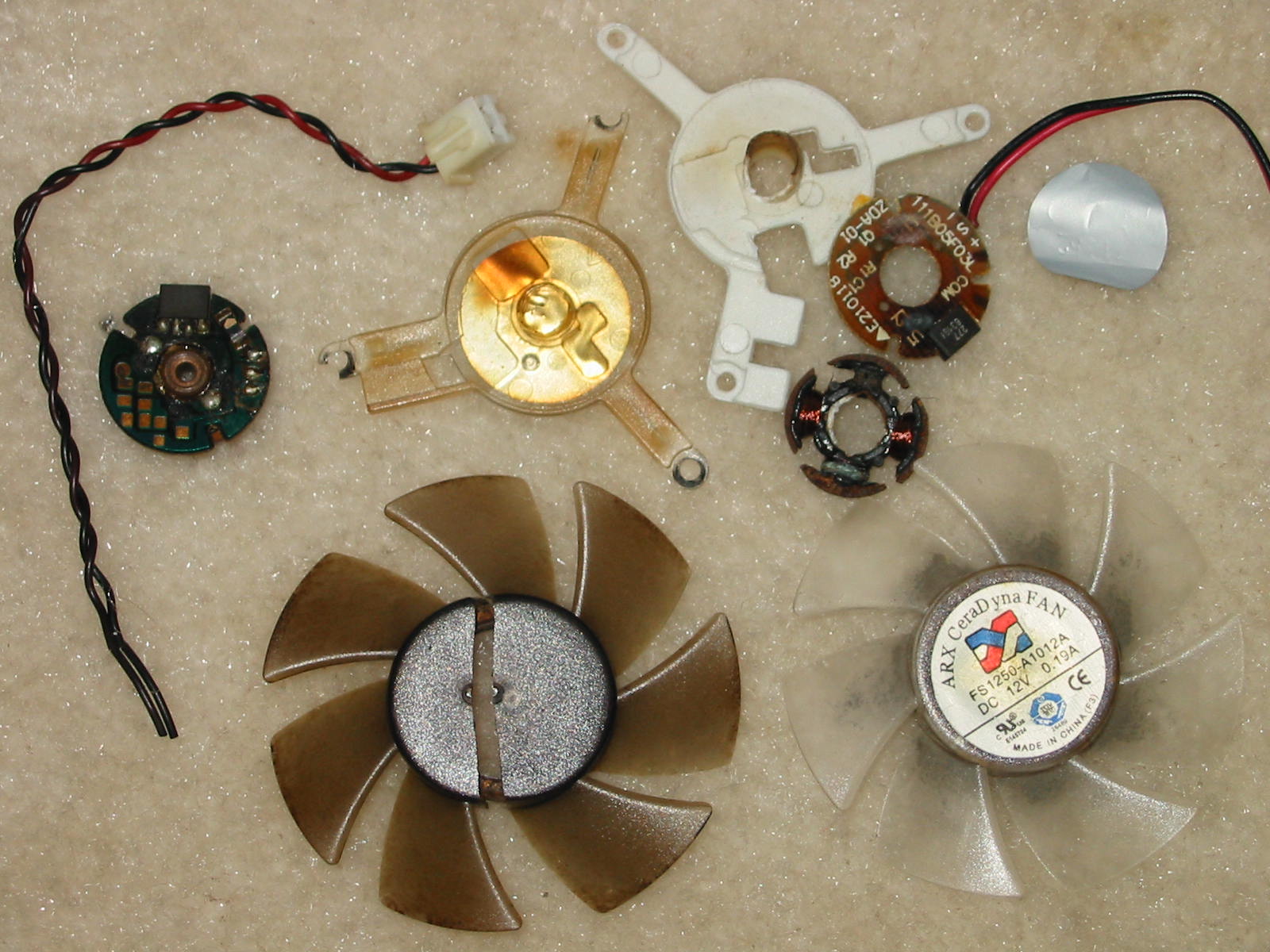

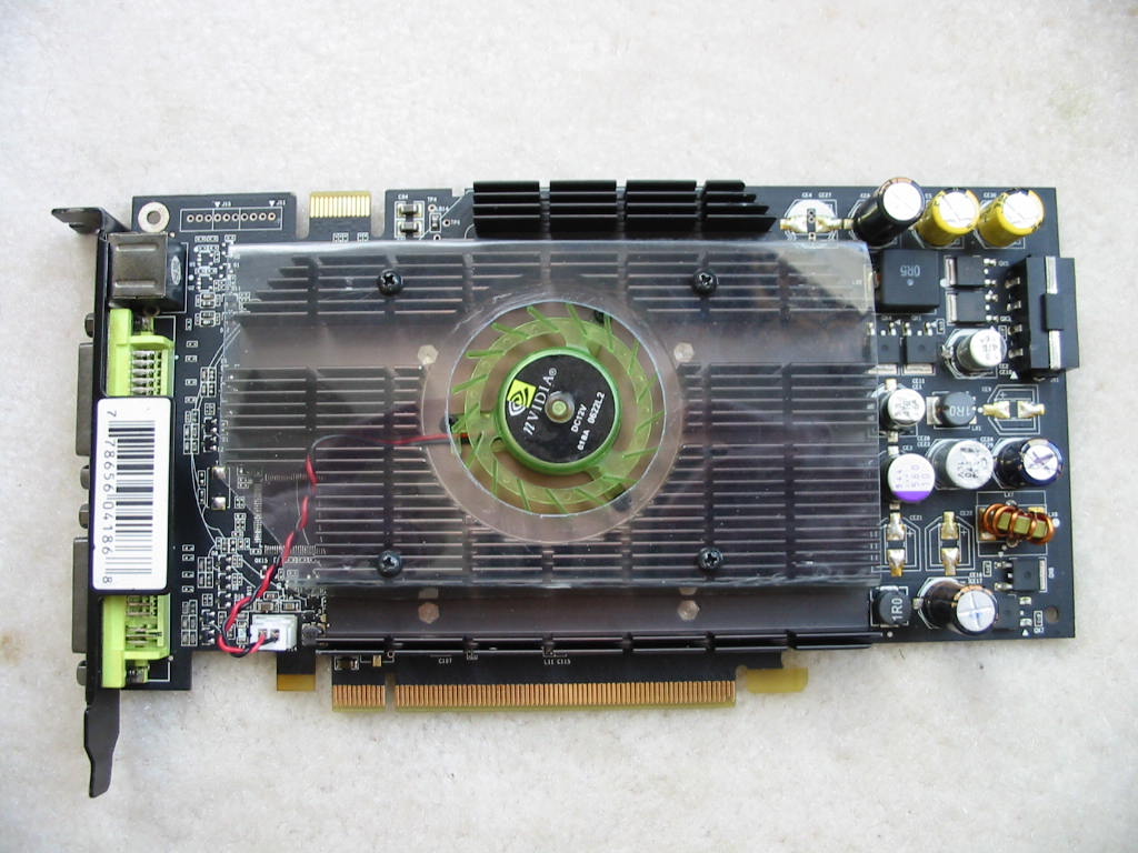

    You can also see on this picture that the original fan was indeed damaged. The seller said his son tried to clean it because it was seized, but the fan was so stuck that eventually the whole fan blade assembly broke. Fortunately, he thought this might be repairable, so he saved all of the parts. Thus, the auction also included all of the broken fan parts in a small bag.
    Upon inspecting them, I found out why the fan broke: the magnet sensor/FET was cooked. This likely overheated the coils in the stator and caused the plastic to become fragile. Another notable thing is the rust on the magnet of the rotor. It is more than just surface rust – it is deep. Perhaps this caused the fan to stall in the first place?
    - I think so, because this is not the first time I have seen this. An MSI GeForce 7600 GS (given to me by a classmate) also had this issue. On that one, even the coils were burned to a crisp! Other cards on which I have indirectly seen this bad fan are PNY GeForce 8500 (or maybe it was a 9500) as well as a few other select ATI cards, often described as having "bad", "stuck", or "rusted" fans on eBay. Looking at the two fans I have from the GeForce 7600 GS and this 6800, it appears the fans are made by the same manufacturer. There is no label to identify the fan from the 6800, but the 7600 fan has "ARX CeraDyna FAN" written on the sticker. UL number E145724. Its PCB, however, has UL number E210118. Most notable, perhaps, is that both fans have plastic shafts on the rotor assembly, and the PCBs are nearly identical. So I think this is definitely one and the same company that makes them. Here is a picture of the two fans, with the XFX 6800 fan on the left and the MSI 7600 fan on the right:
    Finally, the capacitors: those Evercon ME really needed to go – even the group of three at the top that aren't bulged. For those of you who are new to the forums, avoid GSC, Evercon, Sacon, and Elcon like the plague! They are the most terrible electrolytic capacitors in the history of electronics (or maybe strongly rivaled by Rulycon… but let's not even go there. )
    Starting with the four capacitors at the top right corner by the power connector (that's CE4/CE27, CE6/CE25, CE5/CE26, and CE30/CE31), those filter the GPU V_core. Originally populated by three 6.3 V, 1500 uF Evercon ME 10 mm caps. I don't think they were bad yet - at least they didn't appear so, but I didn't have an ESR meter handy to check them. I changed them for two 4V, 820 uF Fujitsu FPCAP RE polymers, accompanied by one 6.3V, 2200 uF Nichicon HZ. This combo may have slightly lower total capacitance, but the ESR and ripple current specs are much more superior that the original setup. For anyone recapping this video card, feel free to experiment here. There are four cap spots in total, and the board has holes for both 8 mm and 10 mm diameter thru-hole caps (or if you are brave, SMT ). Given the not-so-great specs of Evercon ME, it is possible to use even something like Panasonic FR and FM, Nichicon HW, Rubycon ZLG, or Chemicon KZM.
    The next set of caps that really needed my attention – the two bulged 6.3 V, 1500 uF Evercon ME 10 mm caps filtering the RAM Vdd rail. I've looked at other XFX GeForce 6800 Xtreme video cards on eBay, and they always seem to have these two caps bulged. These are in spots CE23/CE28 and CE24/CE29. Much like the GPU V_core caps, the board gives options here again for both 8 mm and 10 mm thru-hole caps as well as 8/10 mm SMT. I had a 6.3V, 1500 uF Rubycon MBZ 10 mm cap that I wanted to test (it appeared good on ESR meter before, even though it bulged once due to high heat on reflow machine), as well as a 10V, 470 uF Nichicon HC 10x12 cap from a Radeon 9500/9700 video card. On paper, both of these caps have reasonably close ESR and ripple current to Evercon ME's. So I tried them out, and they worked fine on my card.
    Finally, there are the 12 V input filters for the VRMs above (i.e. GPU V_core and RAM Vdd). It appears that the GPU V_core VRM draws power from the 12 V rail on the 4-pin power connector, whereas the RAM Vdd VRM draws its power from the 12 V rail on the PCI-E connector.
    The GPU VRM input filter caps are in spots CE2/CE10 (which filters the 12 V rail directly as it enters the power connector) and CE1/CE11 (which filters the 12 V rail after a 1 uH inductor before it is chopped by a MOSFET). Both of these caps are 16 V, 470 uF, 8 mm diameter SMT style. I don't know their brand, though (if "5 D" on the first line means anything to you). The board again gives the same three options as for the GPU V_core and RAM Vdd. I tried removing one of these caps, but I couldn't. Since they weren't bad, I left them alone.
    As for the RAM Vdd VRM input filter, it has a single 16 V, 470 uF L.H. Nova LE 8 mm diameter cap sitting after a 1 uH inductor. Cap spot is CE16/CE17. Since L.H. Nova is another crappy brand, I replaced it with a 16 V, 1500 uF Nichicon HN 10x20 mm cap – a bit overkill, but I figured it's good to have the extra filtering so that there is less ripple sent back through the PCI-E's power pins.
    And that is all of the caps for the major rails. There is also a 10 V, 560 uF Sanyo SVP 10x12 mm SMT polymer cap on my board, in spot CE3. I suspect it is filtering the secondary GPU rail (around 1-1.2 V IIRC) or a 5 V rail. Either way, it is a polymer, so I didn't touch it.

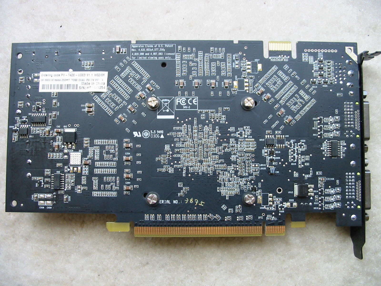

    Here is what my recap looked after I was done with it and ready to temporarily test the video card (thus, pay no attention to the ghetto attached fan .)
    Everything worked great on my tests (which consisted of me just playing a bunch of games for an hour or so). Therefore, there was one last thing left to do: attach a fan in a less ghetto manner. Since I have two dead GeForce 7900 video cards, I pulled the squirrel cage fan from one and put it on the 6800 (because apparently the 7900 heatsinks are not compatible with the 6800). The fan fit perfectly. It just needed something on top so that the air would get forced through the heatsinks. For this, I cut out a large piece of transparent PET/PETE plastic from a fruit container. Some bending and cutting, and this is what it looked like in the end:
    I don't want to praise myself too much, but personally I think it looks even better than the original XFX heatsink. With two green LEDs, I think it will look even showcase worthy! (Okay, I give myself too much credit now. ).

    The only problem: that fan from the 7900 is quite loud. I guess the original fan on this 6800 was slower, so the default settings supply higher voltage at idle. And during 3D operation, the fan is at full blast, which makes this little 12 V, 0.18 A Delta fan really scream. What's worse is that the GPU core temperatures are still pretty high – up to 60C in games! (Which is getting very close to the limit where these GeForce chips start to fail from the bumpgate problem.) But I suspect that is just due to the design of this heatsink (with the GPU die right under the fan rather than under the fins). Despite liking the looks so far, I might mess around with the fan and heatsink a bit more in the future to improve the temperatures (especially if the card will be used for 3D stuff.)

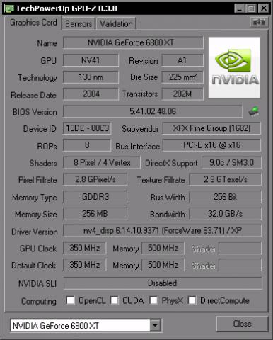

    Which leads to my last point… gaming. Is this video card really worth anything these days in terms of games? -Absolutely not! It struggles at 20-30 FPS average in Half-Life 2 Episode 2 (at 1024x768 resolution and most settings maxed except for AA, which is OFF). And last part of test chamber 18 in Portal (with which I have tested on most of my other video cards) also makes it struggle a bit at 20-ish FPS. The other levels run much better, though. Slightly older games like Collin McRae Rally 2004 run butter-smooth at 80 FPS average on 1024x768 resolution. So I guess the 6 series GeForce is just too old. According to benchmarks, the GeForce is about on par with the Radeon 9800, which is pretty ancient now. But that shouldn't surprise you, as the 6800 has 8 ROPs. 8 pixel shaders, and 4 vertex shaders – exactly the same as the Radeon 9800.
    Here is a GPU-Z of my GeForce 6800 Xtreme:

      Hmmm A1 silicon. That's good I think. Probably doesn't suffer from the design defects of the later revisions.
      Good score for what you paid. The card should actually do quite well if you disable antialiasing and anisotropic filtering. They used to take a heavy hit back in those days with them enabled. You can also vastly increase the framerate if you run the games in 16-bit color -- trust me, it's not as bad as you think. I used to do it all the time and it was well worth the quality hit not having to spend hundreds on a new card.
      The 16-bit trick won't work on Radeon cards though. Because of the architecture, the performance on them is the same regardless of the color depth.

        one probable cause of the poor performance in recent games u are experiencing might be due to the driver version u are using. from the gpu-z screenshot, i saw u are using forceware 93 or something. that is quite an old driver back from 2006 or thereabouts. i suggest u update to a newer driver like the last driver supporting the gf 6 series like forceware 295.73. nvidia deprecated driver support for the gf 6 and 7 series in the forceware 300 or newer drivers. so the forceware 295 drivers or below should be the last and most recent drivers supporting your card.
        i have the 6800 ultra and 6600 gt (both purchased second hand) running the third party customised xtreme-g 295.73 driver and both cards work great.
        judging by the paper specs of the 6800 xt on wikipedia, it has identical core config and fillrates as the radeon 9700 pro. the only two exceptions i can see is with the mem bandwidth and core clock speed. yours seems to be running with a 25mhz core factory overclock (6800 xt core stock speed is 325 mhz) and extra higher speed or factory overclocked memory at 500mhz (1ghz effective ddr with 32gb/s of resultant mem bandwidth) when the stock mem speeds for the 6800 xt should be 350mhz (700mhz effective ddr with only 22.4gb/s of resultant mem bandwidth). so the end result is a card that is a bit faster than the 9700 pro. im guessing the performance is in the ballpark of the 9800 pro or 9800 xt like u said.
        with the higher mem speed, your card should be bottlenecked less by anti-aliasing and anisotropic filtering. u can try overclocking your card to take advantage of the extra memory bandwidth and also thereby boosting the pixel fillrate if u are concerned about the card being too slow. however, that could accelerate the bumpgate problem and not recommended since its running close to the thermal limit of the bumpgate issue.
                    It's also possible that the motor driver wasn't able to detect that the fan had seized and kept power applied to that pair of coils until they burned up.
                    ARX CeraDyna fans have ceramic shafts.
                    http://www.arx-group.com/ceradyna.html
                        Heh, so much for their "long lasting" shaft then. Because it is broken on both of them. I swear it the shafts looked plastic, though. I have to see if one of them is still in the bag somewhere. I don't think I saw it when I took out the fans for a picture.

                          Another issue with these cards is the stock ADDA hyprobearing fans that come with it. They are not lubed well from the factory so they seize prematurely and expedite the failure of these cards. And they're only spinning at 7V by default, I think, so they aren't spinning fast enough to keep the card cool (though at least they're less noisy that way).
                              Yup, the fans on these video cards become seized quite often. I don't know if they are all ADDA, I didn't take note (I did fix one on my classmate's 9800 Pro - same guy that saved his lunch money for a year.)
                              Well, Radeon 9500/9700 cards have 12V going straight to their fan connector. IDK about the 9800. Probably the same, though.
                                  The OEM ATI ones come with ADDA hyprobearing fans. AD0512MX-G70 is the model number (rated for 4300RPM, 50x50x10mm). Some of them come in 7 blade variants, others 9 and 11 blade variants. Also, I meant came with them, not came with it.
                                  It doesn't seem that way to me (I thought I read somewhere that +7V was the default voltage). I unplugged the fan from the header and connected it straight to the +12V output of a Hipro PSU (so it had good regulation for the +12V rail and no bad caps in that one), and it was much louder and was moving more air than it was just connected to the header. Maybe they limit the current going to the fan in order to slow it down somehow whilst still providing it with +12V.

                                        Re: XFX GeForce 6800 Xtreme – an eBay special (with LONG story)
                                        Okay, I got a bit of news...
                                        The ICs in those burned fans from the XFX 6800 above and 7600 gs might actually be good. Even the protection diode on the 6800 fan board is still good. The stator windings on the 6800 also might have been good (or not completely bad yet, at least). However, as I was trying to do some "fixing up" on the stator for the 6800 fan, I accidentally tore the stator core (with the windings) out. One of the wires snapped at a bad place, so I can't solder it back in without a complete rewind of the stator. And I can't use the stator from the 7600 gs fan, because it has a different windings pattern *and* the windings are burned.
                                        So most likely, I will get rid of the windings on the 7600 gs fan and rewind the stator, then test it on the 6800 fan board. With some work and ghetto modding, I might actually be able to revive one of these fans.
                                        Worth the time? Heck no! But I do tend to have some free time on my hands now while applying for jobs. (Which is why I am on BCN so much). Besides, why not? Maybe i learn something along the way .
