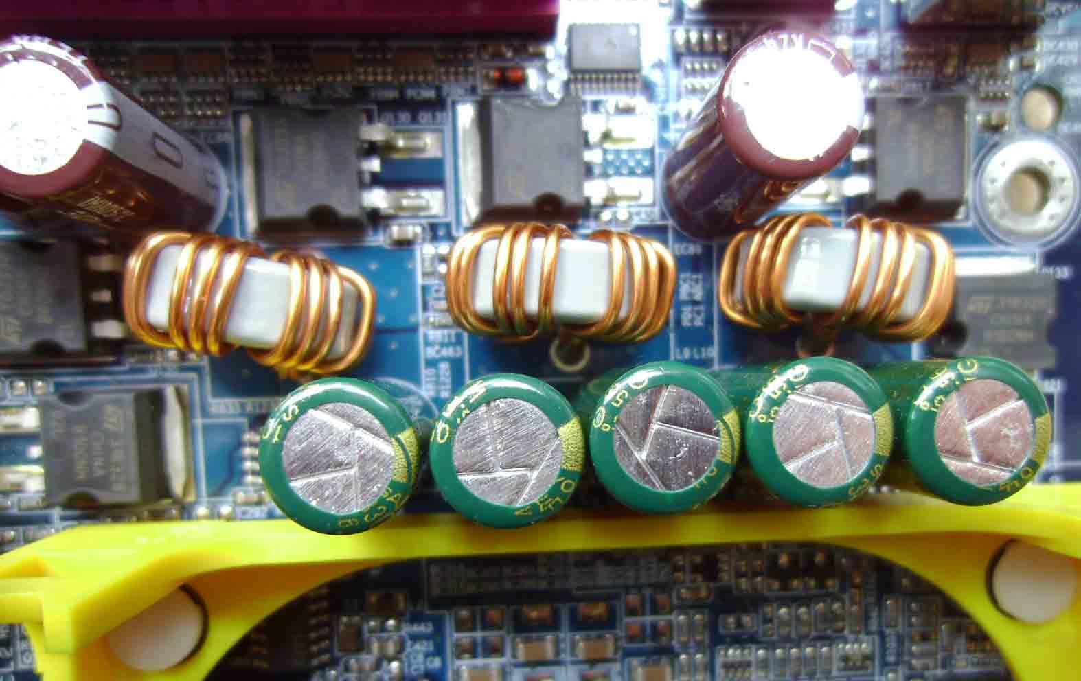

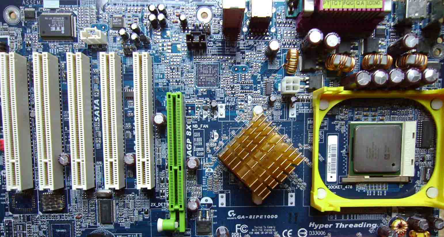

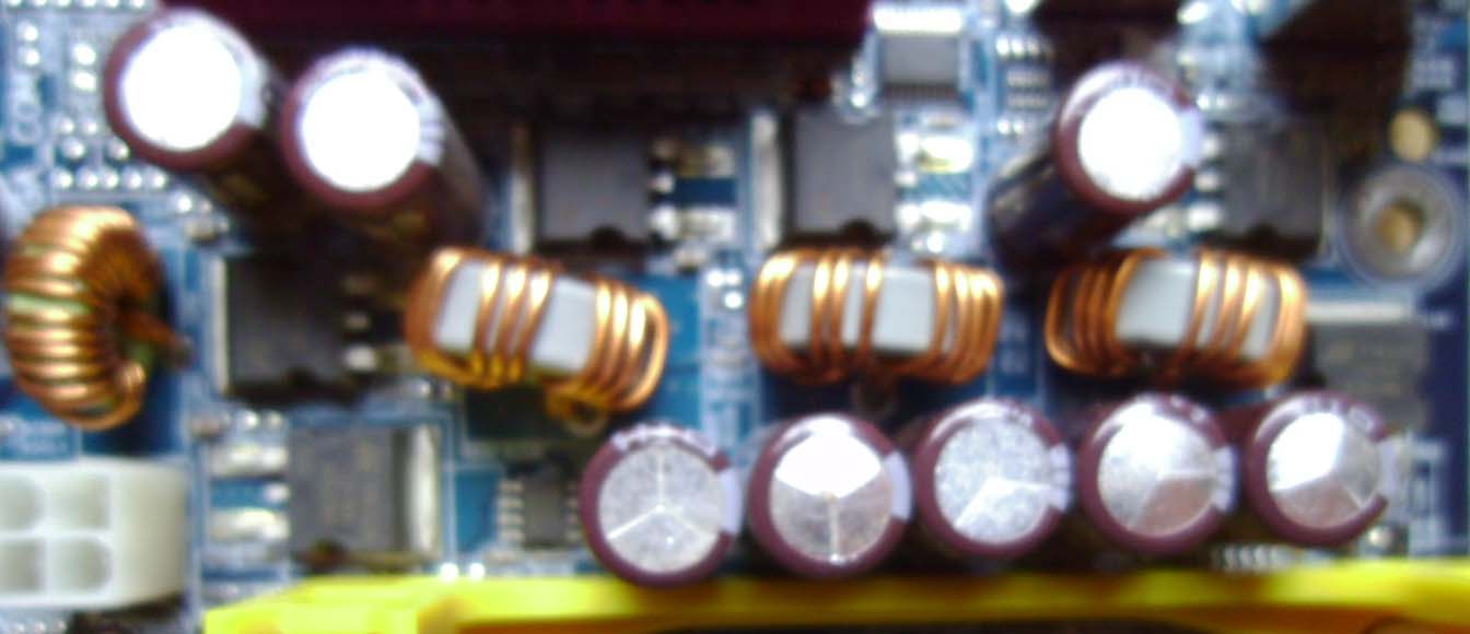

    Gigabyte GA-8IPE1000 - KZG caps bloat in storage
    Similar to this https://www.badcaps.net/forum/showthread.php?t=38550 ...
    ... I'm not having much luck with motherboards that aren't regularly used
    I built this GA-8IPE1000 into a machine to be used for data recovery, and needing to use it years later (for a family member) found it in condition pictured

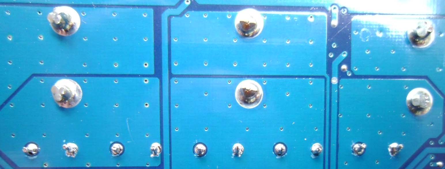

    Re: Gigabyte GA-8IPE1000 - KZG caps bloat in storage
    Although it still ran, and accomplished the task, I replaced the offending KZG with Sanyo WG, as shown
        eeks is that a whole board of KZGs? probably shud recap the entire board even if u arent using it regularly. dont want another "accident" with the KZGs again!
          I had this board too.
          Funny thing that mine was the exact OPPOSITE - factory installed Sanyo WGs around CPU,and KZGs on the high side.
            Originally posted by stj
            it was on the 5v line so it was voltage under-rated anyway - should have been 10v.
            Not really - I'd agree with you if it was a solid aluminum polymer. But 6.3V provides a healthy 26% tolerance when it comes to voltage (on the +5V line, for electrolytics). GSC capacitors are just that shoddy... their raw materials are that poor.
            Those 3300uF 6.3V KZGs are the worst of them all. People have seen so many of those bloat on unused boards, it's not even funny. It doesn't exactly reflect well on Chemi-con, but in their defense, there is a massive divide in quality between KZG/KZJ/KZV/TMV/TMJ and the rest of their electrolytics (I'm pretty sure they discontinued their ultra low ESR lytics anyway, at least for the most part). This is also proof that it isn't really heat that's killing KZGs - just time! Heat only expedites their failure.
