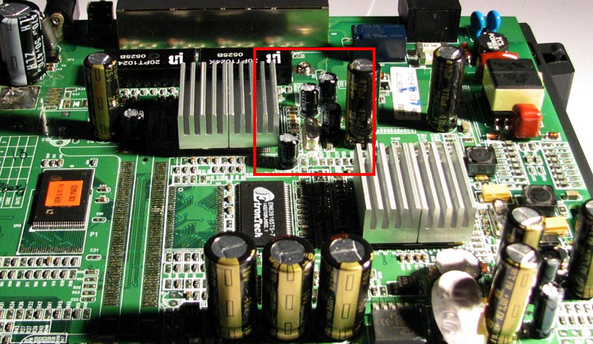

      Re: Replace small caps?
      Small caps can cause problems too. Recently I fixed a serious where the device wasn't useable issue by replacing 33uF Hermie caps with 56uF Rubycons. I did this just on the off chance, all the larger caps had already been replaced to no avail I was close to giving up.
      Rubycon Rubycon Rubycon
        Fizzy.
        Where were those caps?
        As in what do they do?
            Originally posted by PCBONEZ
            Fizzy.
            Enclose photo, originally all the large ones were Hermei but this didn't solve the issue of network connections not working and maybe drop outs, I discovered by temporarily soldering randomly some good caps in parallel to the small ones solved the problem and later replaced all of them.
                Looks like they are either I/O for that sinked chip or maybe part of the clock/timing circuit. (There's a timing crystal right there next to them.)
