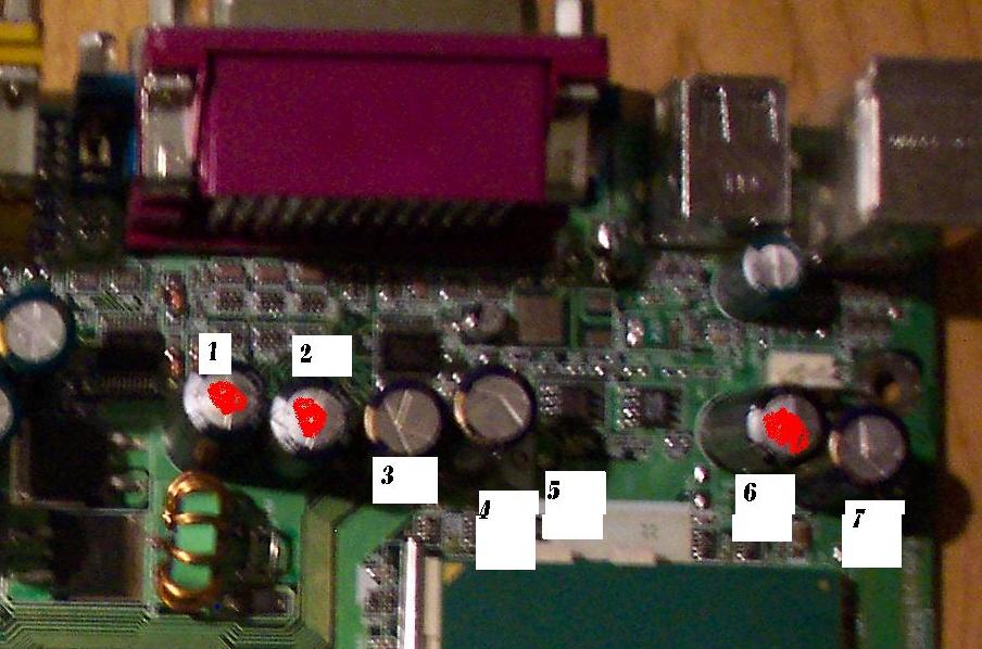

    Hi. Great forum here. Going to turf the board and ran across info that lead to this site.
    Have a couple of questions regarding replacement caps. I have completed the inventory of caps on the board and have 5 different manufacturers. The CHHSI 2700 uf and G-LUXON 2700uf caps are the culprits. From reading here, I understand some people are using different values for replacing these caps - some 2700uf, some 2200uf, some replacing with 3300uf.
    I am attaching a pic in which I have identified the 3 leaking caps with a red mark on top. Here are the current values of the caps that I have numbered.
    1. CHHSI 2700uf, 6.3V (blown)
    2. CHHSI 2700uf, 6.3V (blown)
    3. Rubycon 2200uf, 6.3V, MBZ
    4. Rubycon 2200uf, 6.3V, MBZ
    5. Empty spot - no cap there
    6. G-LUXON 2700uf, 6.3V,LZ, 1073(M) (blown)
    7. Rubycon 2200uf, 6.3V, MBZ
    I realize I need to replace all caps 1000uf and over. I plan on using panasonic caps (FC type, low impedance) and ordering them from Digikey (Canada).
    What values should I use for these 6 caps and should I also add a cap to spot 5 which has no cap in it. Sorry from the crappy pic. Numbering is left to right (1-7).

    Sorry, had to adjust jpeg size. Here is the attachment

      You will not need to replacethe Rubycon MBZ caps. Replace Luxon and CHHSI. Looking at the photo it would seem that the replacements should be the same Rubycon MBZ type.
      It depends where you are. If in the USA Topcat, the forum owner can supply replacements for you. Send a PM
      If outside the USA Big Pope, found in this forum, can supply Samxon GC caps by air mail. If using GC I suggest that all six be replaced with 2200u 6.3V. Send a PM.
      If you have any other Luxon or CHHSI caps at 1000u or more replace those.

            The system is running, but get the freeze screen after a few minutes and ctrl alt del won't work to restart. Have re-installed win98, and problem is still there. Both fans running and all the dust bunnies are gone.
            Ordered some new caps and should be here Tuesday. Will update then.

                  Replaced the 3 bad caps with 2200uf ones as per davmax.
                  System working great! Can't get it to lockup or crash.
                  Thanks for all your help.
