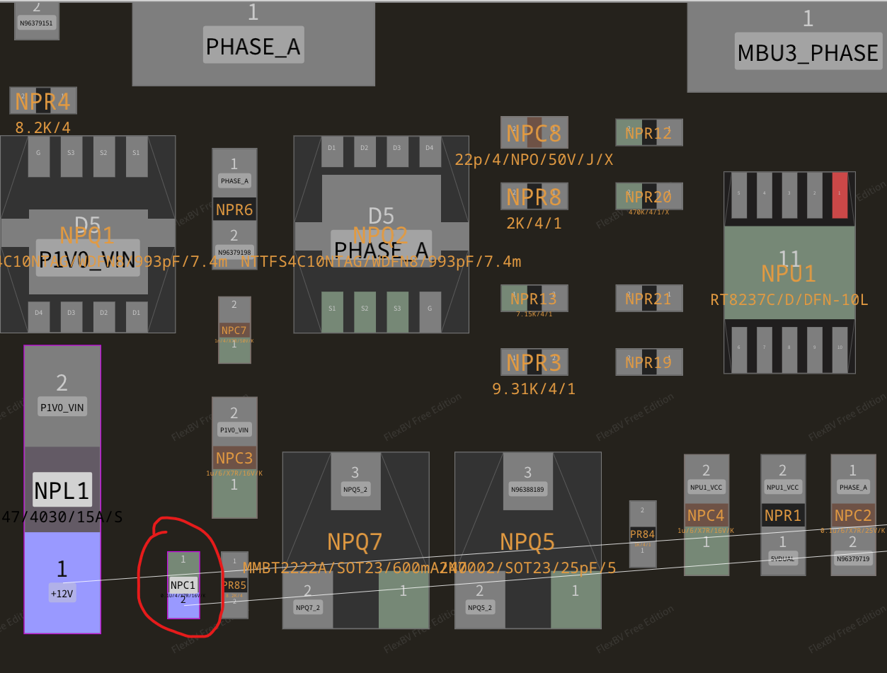

Hi! May I ask help on this. Im just starting to learn board repairs so I might get terms wrong. The motherboard has 5v standby and can confirm that power on switch is working due to drop of Pin 16 in the 24 pin connector. But no 12v on Pin 10, not even a twitch. Also checked the schematics from the forum. I checked resistance and continuity from the Pin 10 to the components it send 12v to. All of them gives shorted beeps and 0 ohms resistance except an 0 ohm resistor, i guess. It has good continuity and around 0.009 resistance. I attached the screenshot of the board view for the resistor. Thank you for your help!
Gigabyte A320m S2H V2 No 12v Power
