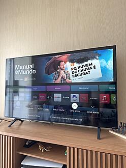

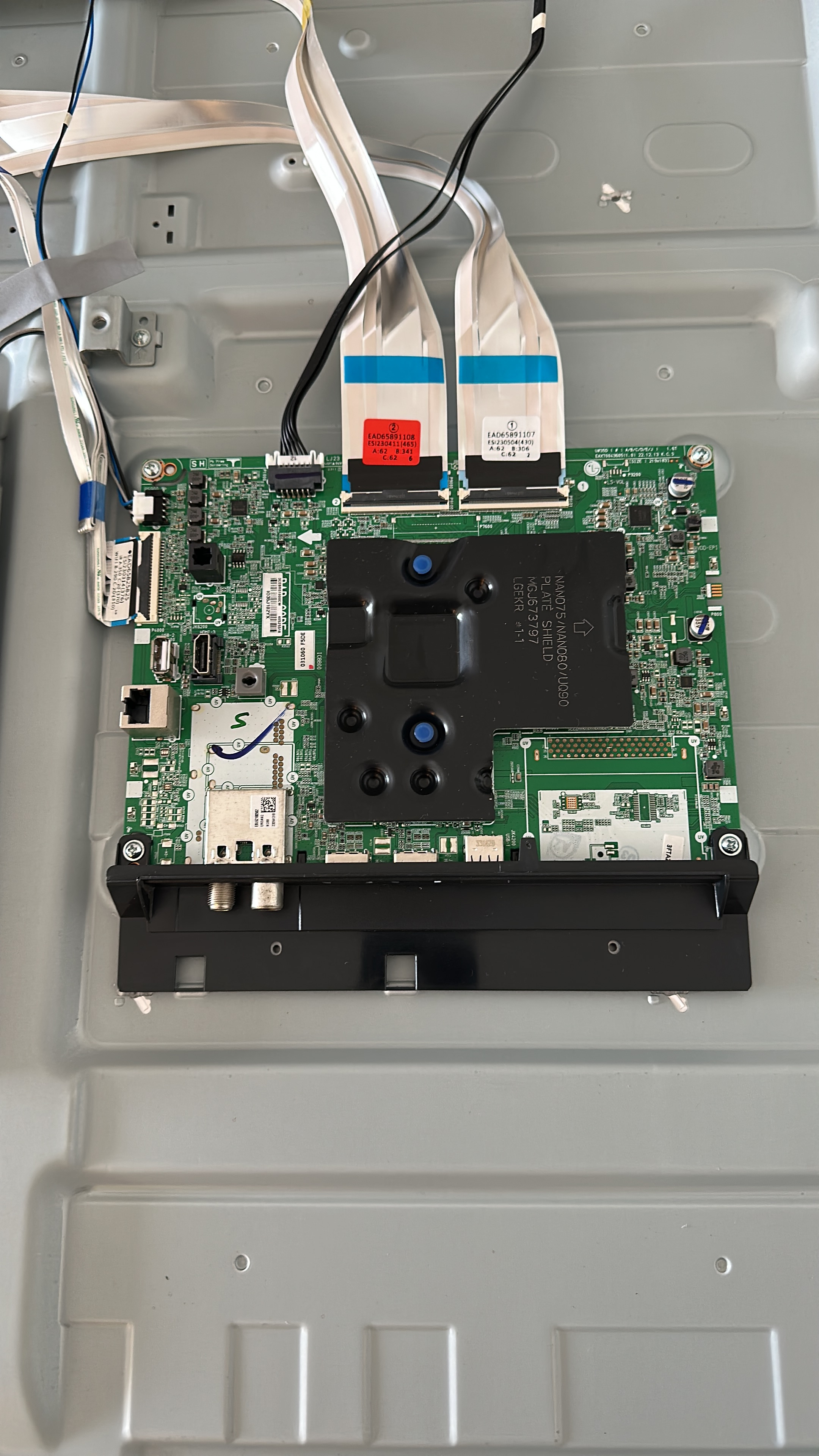

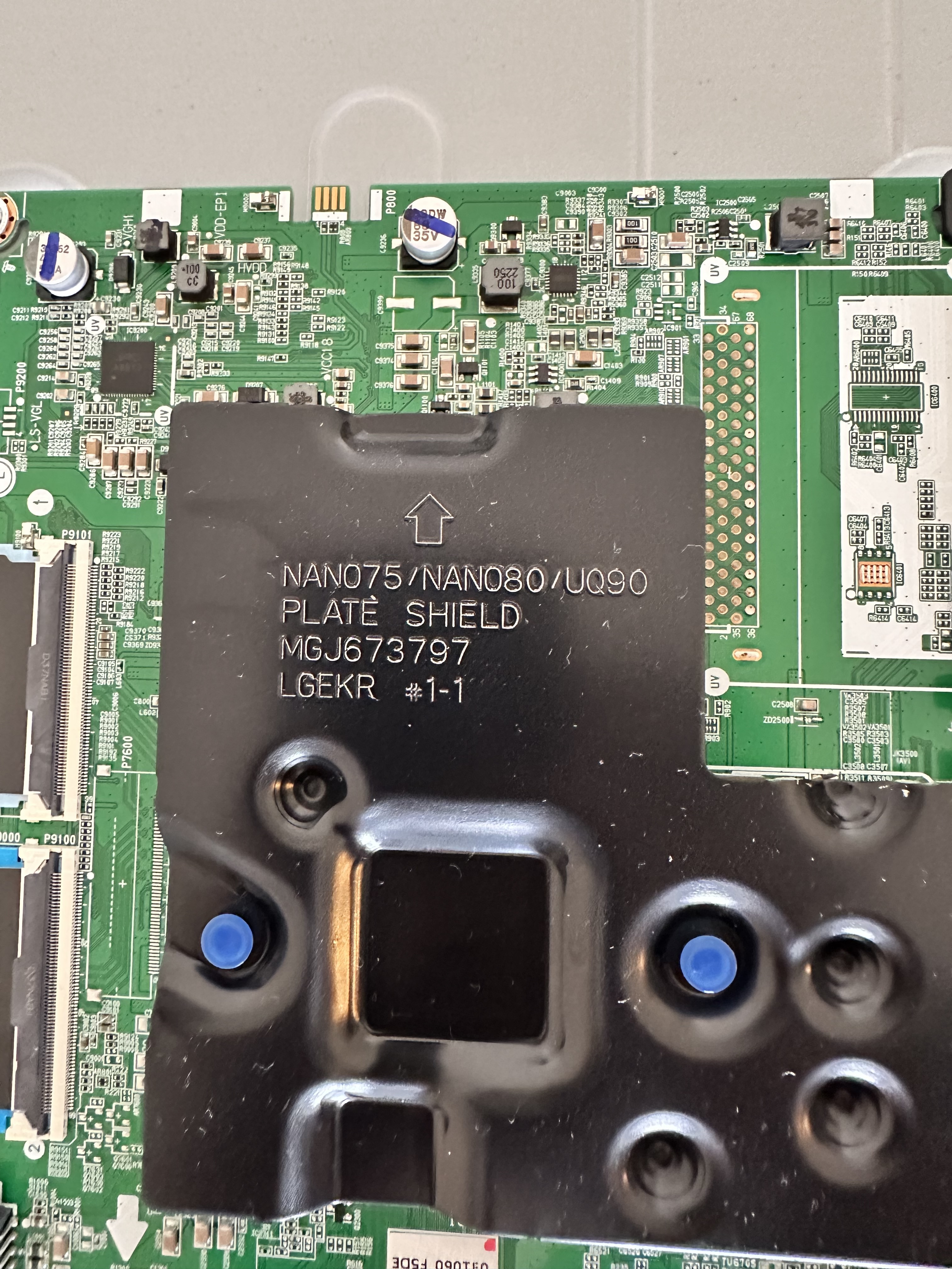

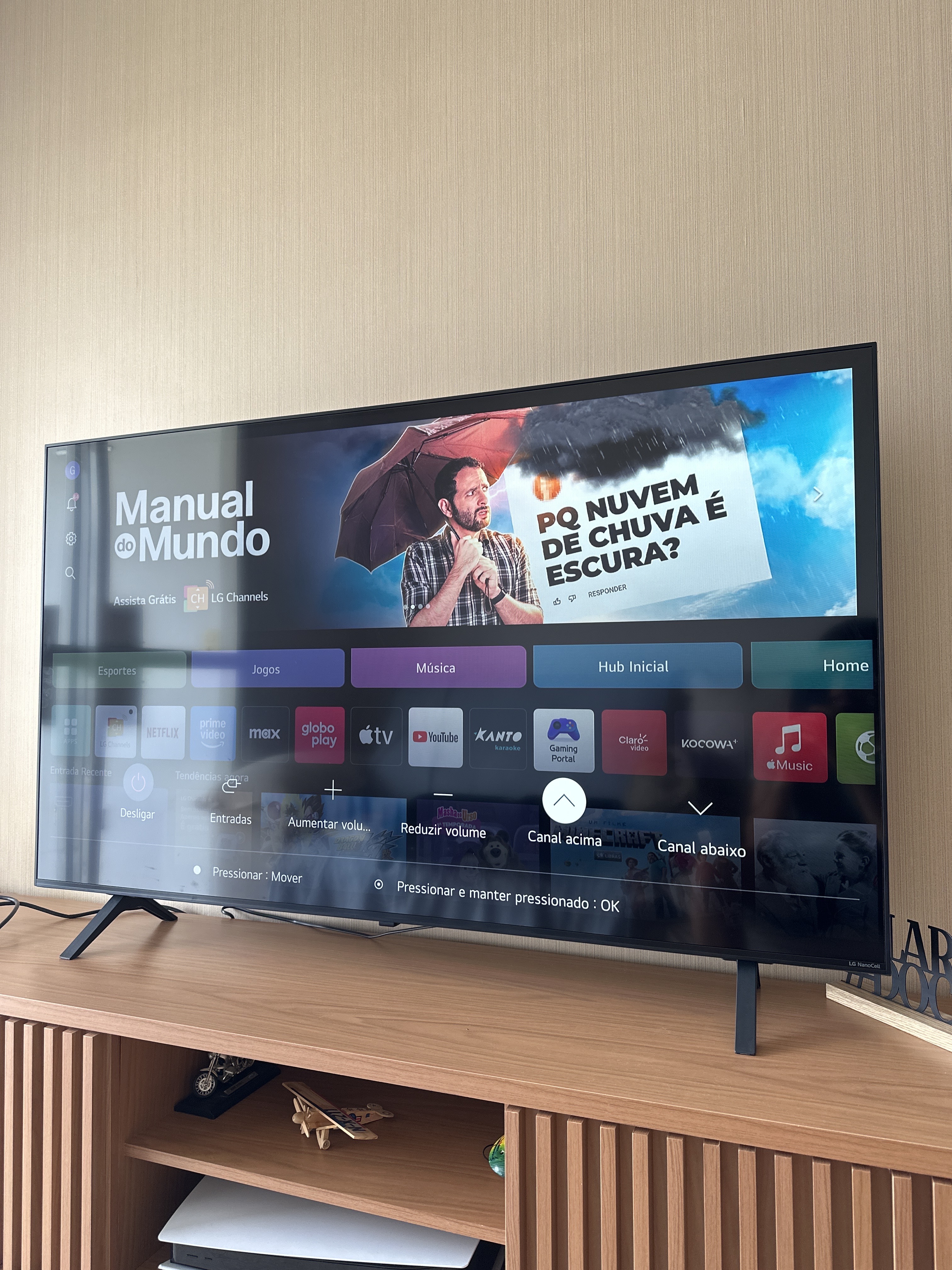

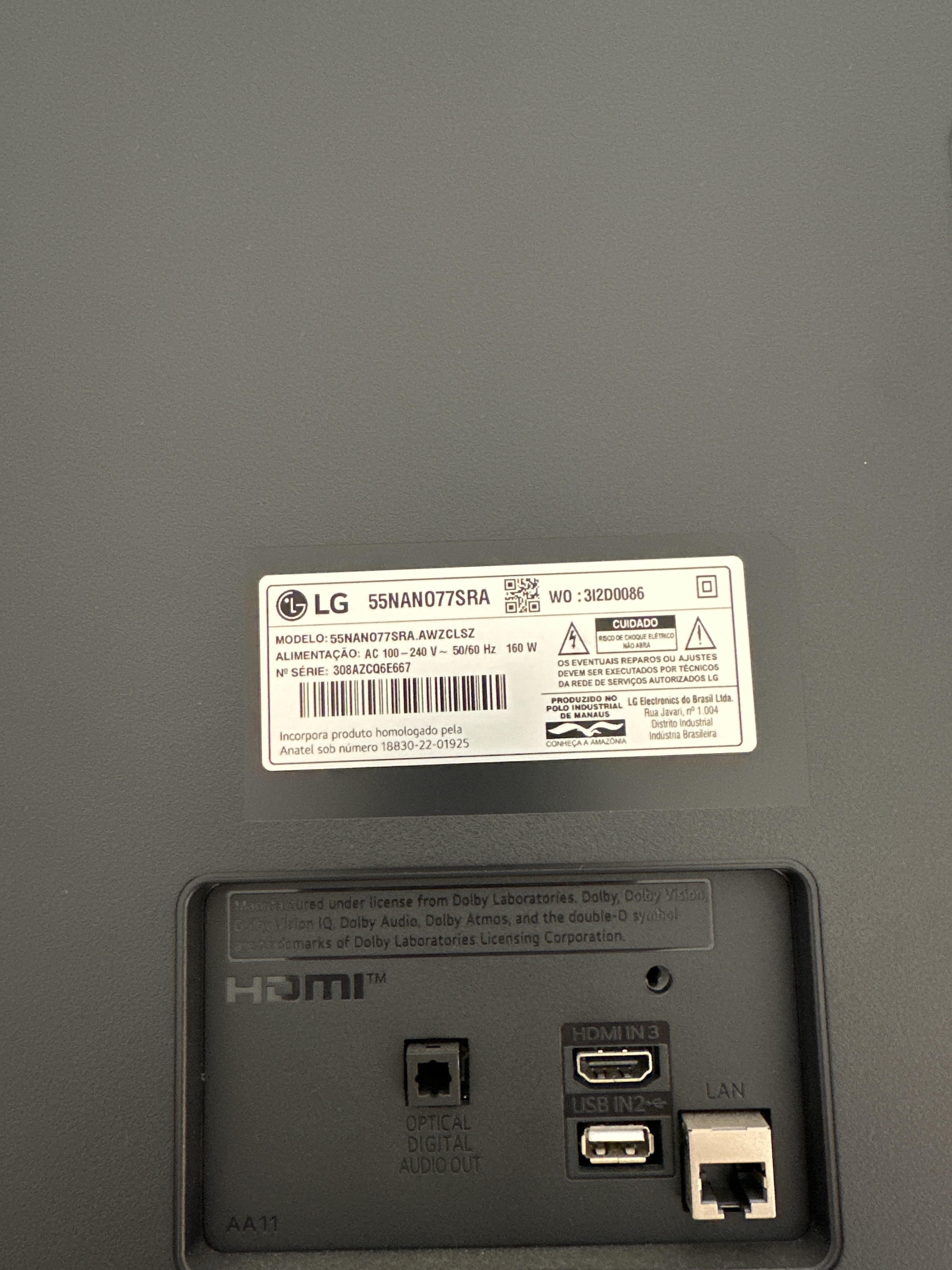

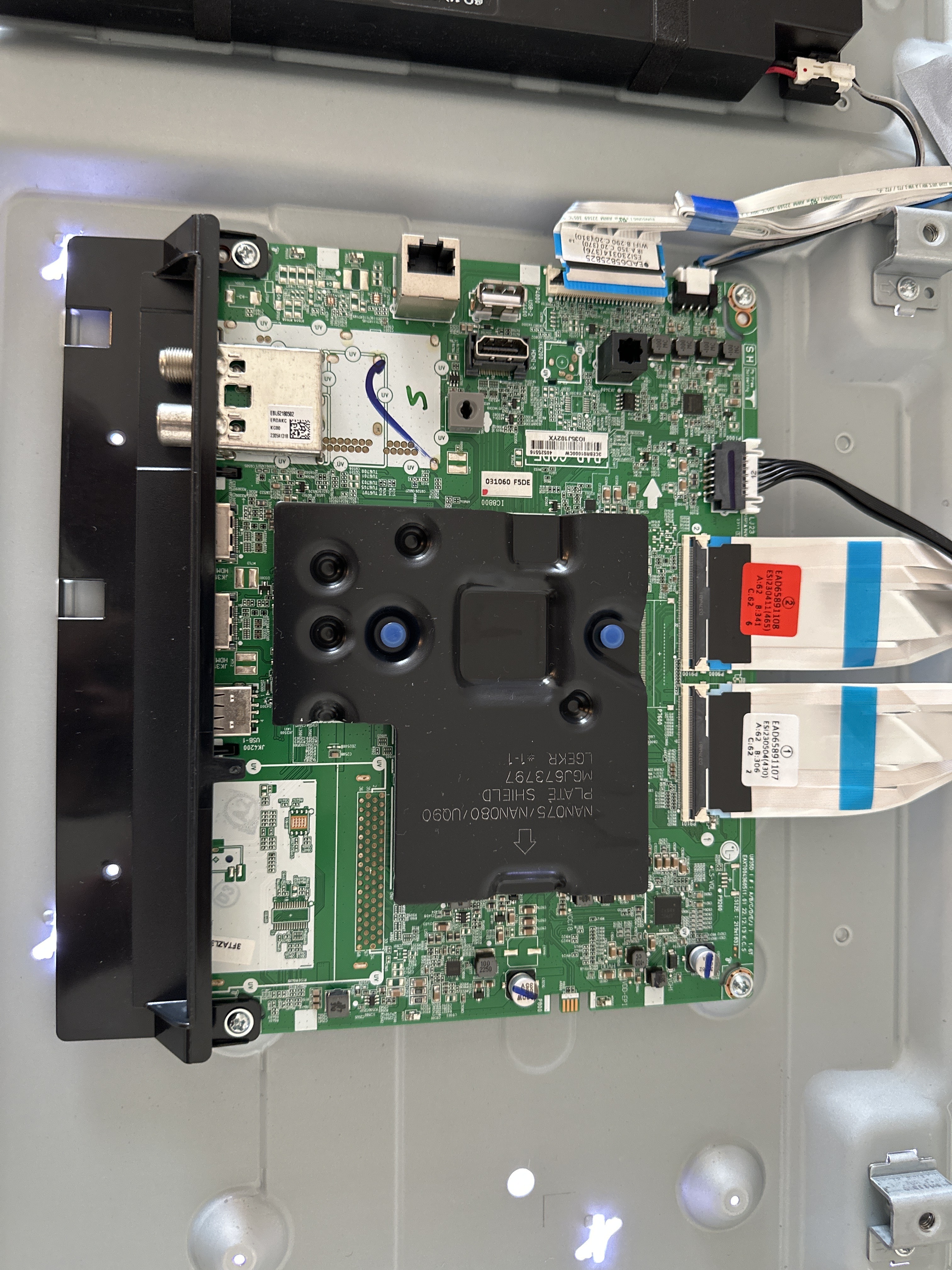

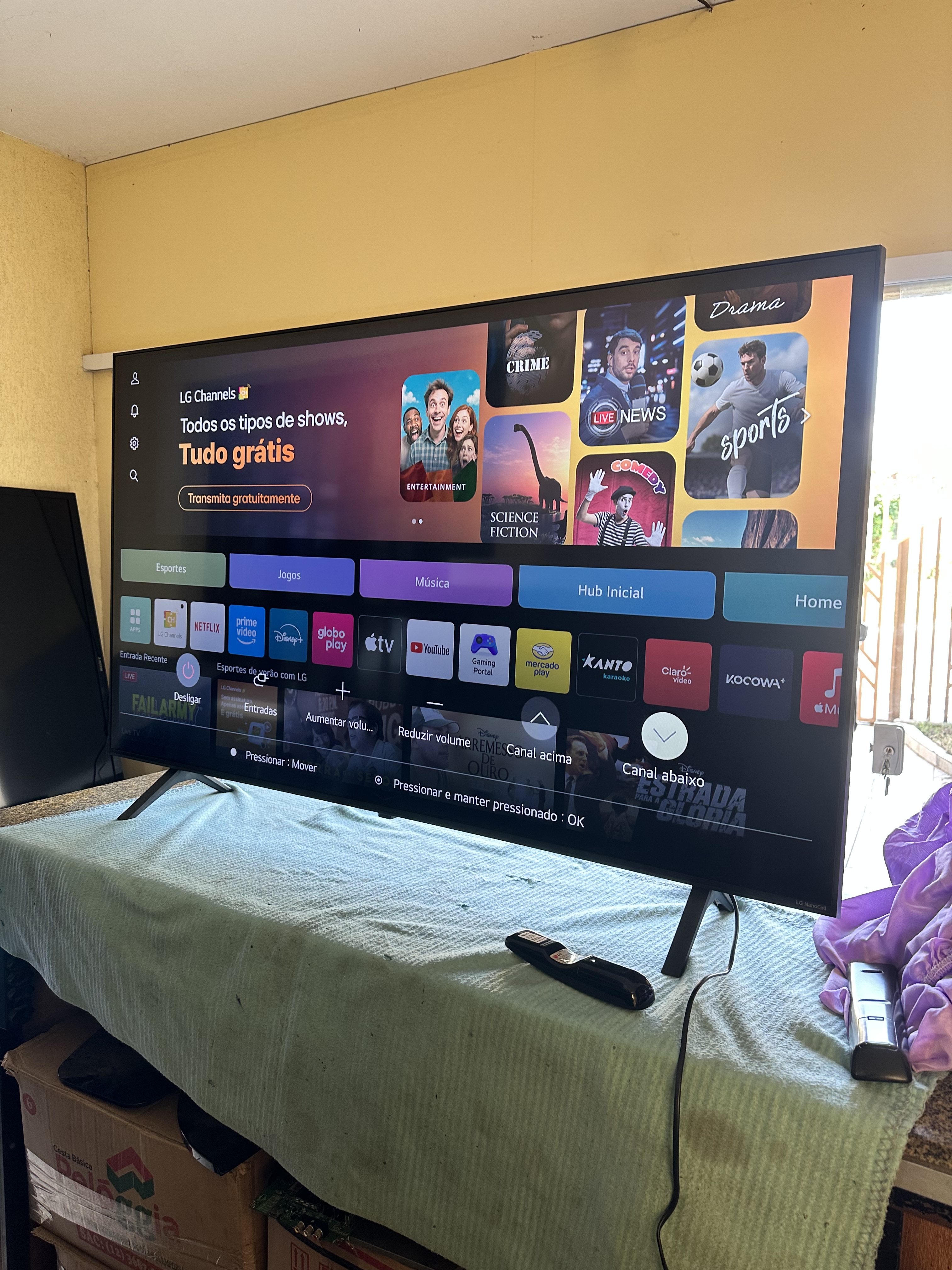

    Hi everyone,
    I’m looking for help with a persistent issue on an LG TV model 55NANO77SRA, which uses the main board EBU66792103 (also used in LG UQ80 and NANO75/NANO80 series).
    🧩 Problem Summary:
    • The TV keeps scrolling through the menu or selecting items by itself.
    • I removed the physical button board (the entire panel with power and volume buttons) and also disconnected the flat cable (CN202) from the main board.
    • The remote control is not in use (batteries removed), and the TV still shows the same behavior.
    • I did a factory reset, and it didn’t help.
    ⚙️ Troubleshooting so far:
    • Verified no damage or oxidation on the main board.
    • Completely disconnected the button board (confirmed no connection to KEY_IN or IR_IN).
    • Tried disabling potential ADC input by removing the flat cable that includes KEY_IN.
    • Planning to remove the pull-up resistor on the KEY_IN line to isolate any residual voltage or short.
    • Also considering checking ESD/TVS diodes on the same line, as well as the 3.3V LDO that powers the ADC input circuit.
    ❓ The main question:
    • Could the KEY_IN or ADC input circuit still generate phantom signals even after removing the flat cable?
    • Would removing the pull-up resistor and/or TVS diodes actually eliminate the false signal?
    • Is there any known issue or workaround specific to this LG board (EBU66792103)?
    • Any chance the SoC itself is interpreting noise due to a faulty capacitor, LDO, or grounding issue?
    Any help, schematics, or technical advice would be really appreciated. I’m trying to avoid replacing the entire main board unless absolutely necessary.
    Thanks in advance!
