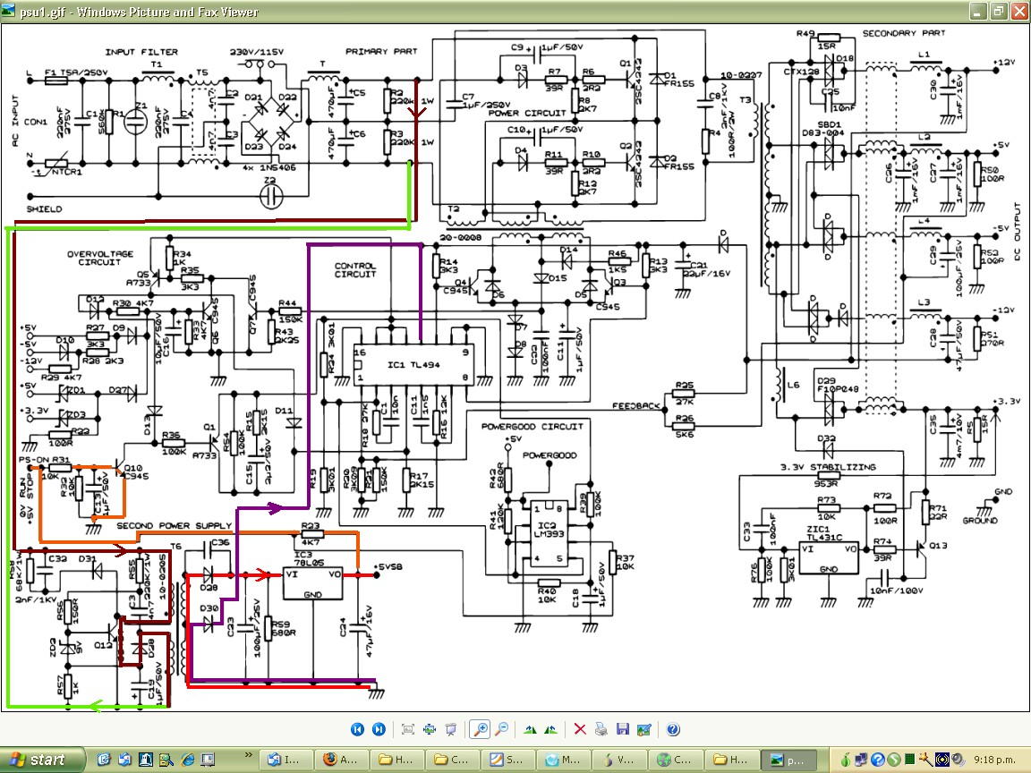

              #46
              Re: Crack & Stink Gigabyte GA7N400 Pro 2
              Thanks momaka,
              Just to make sure i've got this straight...
              Looking at the example schematic (in attachment below),
              the 'circuit' (orange) that goes to the ps-on terminal, is teed-off from the 5vsb output.
              Also there is an independent 'circuit' (purple) that originates from the transformer, that feeds one of the pwm controller (TL494) terminals.
              Am picking that the "secondary-side auxiliary rail" is the purple path - since the ps-on output is already live, along with the 5vsb output.
              i can see that the orange circuit also powers a transistor, so am guessing that when the PC power button is pressed, that that transistor must liven up the TL494 controller.
              Does all of that sound correct?

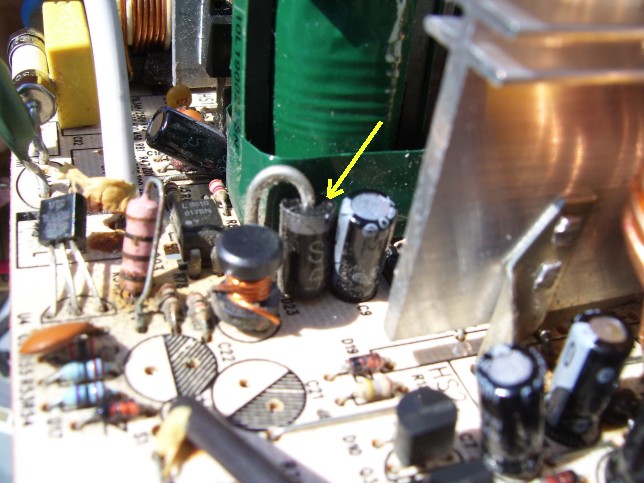

              i also checked this iso psu pcb with a continuity meter, and see that the 5vsb output comes from a inductor and then a diode, and then from the transformer.
              there is continuity from 5vsb output to one side of the diode, but no continuity across the diode.
              forward or reverse bias, multimeter displays 50ohms
              Should this diode have continuity in one direction, or is it faulty?
              (photo of this diode in attachment below)

                #47
                Yes, all of that is correct.
                If your multimeter has a diode test function (usually, but not always, combined with continuity on most multimeters), then the diode should show a reading one way but not the other. HOWEVER, most 2-transistor 5VSB circuits tend to have a load resistor to keep them stable when there is not much load on it from the motherboard. 47, 51, and 100 Ohms are very common resistor values here. If your PSU has one, that can easily mess up your readings.
                Looking at the last picture you uploaded, your load resistor seems to be 100 Ohms. Remove it and double check that diode again (that would be D23). If you still get 50 Ohms, then the diode could as well be bad.
                ... Or, remove the diode out of the circuit and measure it. It's almost the same work as removing the resistor (though, the diode has thicker leads, so naturally, it is easier to remove the resistor).

                  #48
                  Good day to you.
                  i had trouble seeing those resistor colors with a magnifying glass and a torch!
                  (wouldn't it be easier for all if they just wrote some numbers on it?)
                  It looks like black brown black gold
                  But since it tests as 50 ohms, i guess the first black must be "green"
                  Yes, the multimeter has diode test mode
                  What does that do, that the continuity tester doesn't?
                  What does the voltage reading indicate?

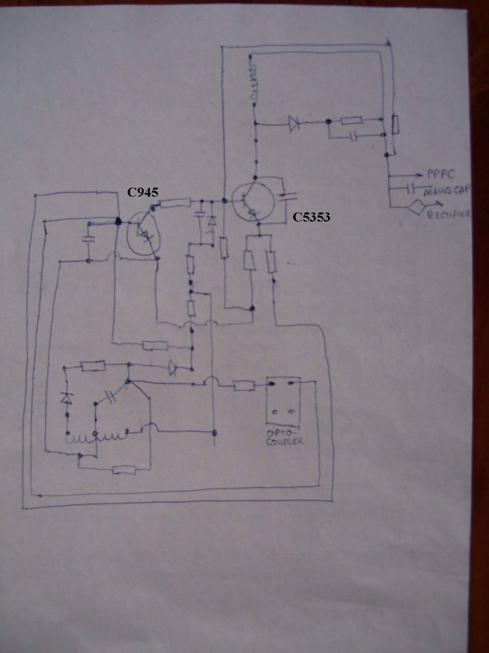

                  i cut the resistor
                  now readings across diode are:
                  forward bias = 0.154v
                  reverse bias = 0.588v
                  Also the resistor that is between the emitter of C945, and the emitter of C5353, had a hard short
                  (diagram attached)
                  As can be seen, for educational purposes, i spent the day tracing out some of the primary side circuit, after being inspired by everell's thread on the 311 mod:
                  https://www.badcaps.net/forum/showthread.php?t=16071
                  There could possibly be a mistake in it, even though i went over it twice.
                  Does it look right?
                  Both of the windings are on the same transformer.
                  i think the drawing could be tidied up by removing the 2 long bottom lines, and replacing them with symbols for common, but i'm not sure if they are actually "common"
                  i have another iso psu, similar to this one, and also a dm311 chip out of a dead psu that i found.
                  Finding this quite intriguing, and am keen to give the mod a shot, sooner or later.

                      #50
                      Good point.
                      Probably a 51 Ohm resistor then as that's a standard value (i.e. Green Brown Black Gold).
                      i cut the resistor
                      Not quite the results I expected, but I will check my ISO PSUs and let you know. Did you make sure to leave the multimeter for a few seconds before nothing down the measurements. The capacitors on the output of the 5VSB can take some time to charge so that can mess up the results.
                      I'd expect to see about 0.5 to 0.7V in forward bias and higher (if any at all) reverse bias results. But again, I can check.
                      (diagram attached)
                      Could be just a low-value resistor. Did you check its color bands? Resistors almost always fail open circuit. I haven't actually seen one fail as a short circuit. With diodes, it's the other way around.
                      Does it look right?
                      Hard to tell without the resistor values, but many parts of it look about right. I'll trace mine when I can and try to post it here.
                      They could be "common", but it would be the primary side common (which could be 160V lower than ground). Secondary side common, on the other hand, is ground (or should be unless you are running ungrounded outlets).
                      Yeah, everell's 311 mod is neat! I bought two 311 chips but haven't used them yet. A lot safer and a little bit more efficient than 2-transistor design. Should be easy for the most part, though.
