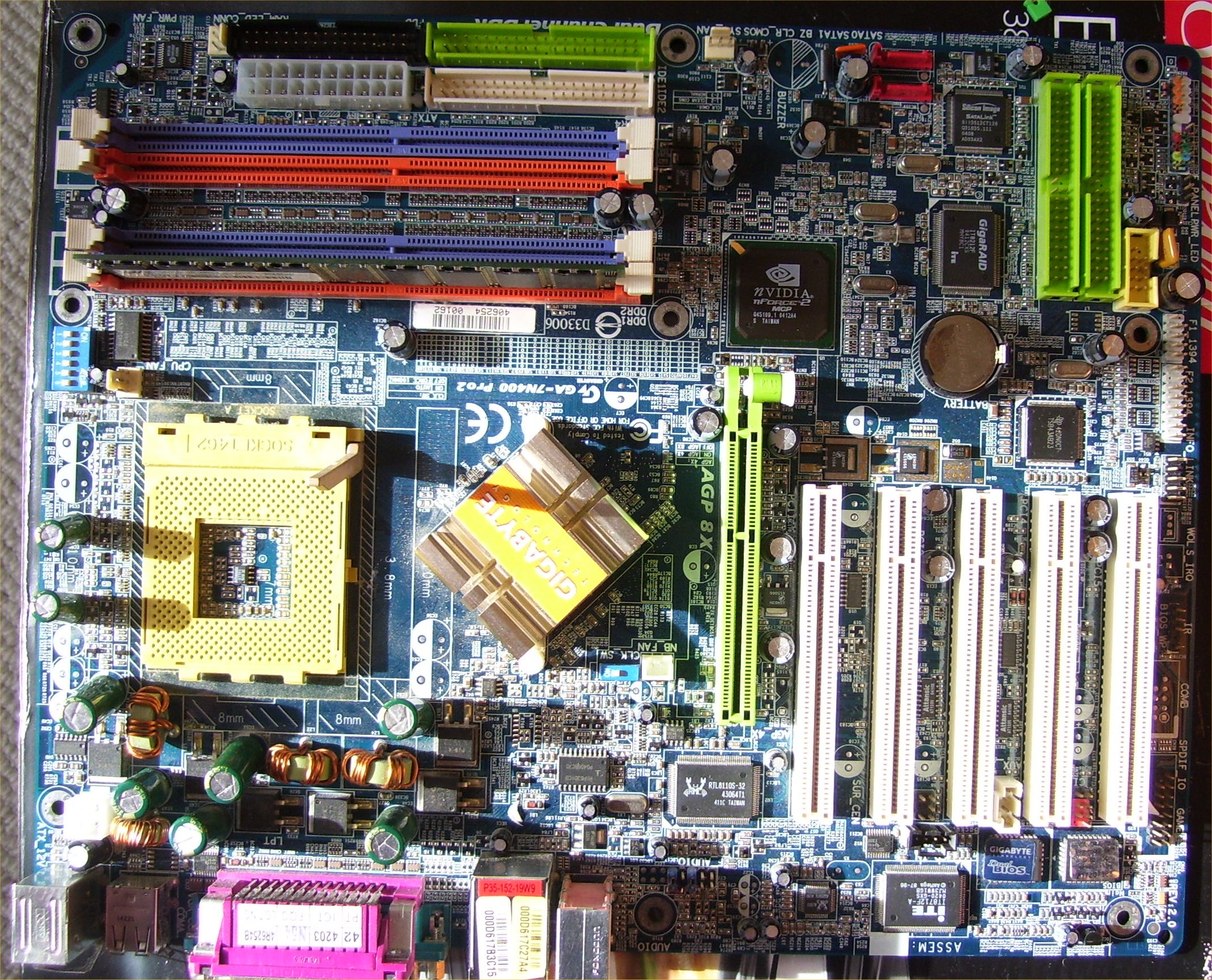

    pictures top and bottom - what surface are you working on.

      Working on cardboard
      Photos here http://www.stillflowing.comze.com/gigabyte.htm
      (Have put the 3 X 6.3v caps back in - the 3 at the bottom of the heatsink)
      And have tried again with new ram/different slots/no ram,
      still now power-up
      you can see the green jumper on the top RHS, the placement of, which fails to activate the psu

              As requested, here is a photo of the motherboard

                  Is it just me, or does the southbridge look slightly brown on top?
                  If you're only running the board for a few minutes, then the southbridge should hardly feel warm. If it's getting too hot to touch, then it's cooked.

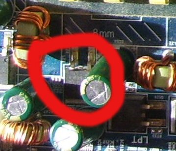

                    the southbridge has defintely been hot.....but that's not uncommon for a nforce chip.....but its definitely scorched.
                    The fet circled in this image appears to be cracked....but it was hard to tell from the low res photo.

                      That fet is not cracked,
                      i think you might be looking at the shadow.
                      Also note that the photo didn't show the short middle drain pin (but it's there).

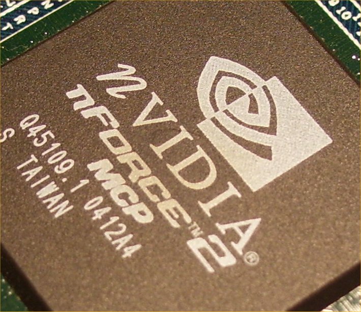

                      However, then had a look at the south-bridge
                      Rubbed finger across it and felt a very fine ridge on it's surface.
                      At first, thought it was the printing on the surface, but upon closer inspection there is, what appears to be, the tiniest little crack in it.
                      Previously didn't get spend too much time over it, thinking that the south-bridge controlled the peripheral ports - not the on/off switch that starts up the PSU
                      So is that a good sign that it's knackered?
                      Can i test it with a meter?
                      Can a such noticeable odor, come through such a miniscule crack?
                      Also tested the big mosfets, 3 of them had shorts, from drain to earth and from source to drain.
                      All 6 of them had shorts from source to earth
                      So are these last 3 OK because they don't have shorts from drain to sink and perhaps have their sources connected directly to earth?
                      For the sake of completeness, here is the visual of the suspected crack, that might have resulted from the audible crack - it's between the V and the I
                      • c_hegge
                        • Sep 2009
                        • 5219
                        Re: Crack & Stink Gigabyte GA7N400 Pro 2
                        That southbridge is well and truly cooked (and yes, that crack is all it takes to let out the magic smoke and give off that burned electronics smell). I'm afraid your board is cactus.

                            Yes, it's blown, unfortunately. There is no test you could do that would tell you anything you don't already know. The only thing you could do is replace the chip (not worth the time and expense, unless you are rich and want to do it for 'fun')
                            And yes, burnt silicon always has that strong smell. You'll never miss it if you ever smell it again!
                            In general the VRM circuits have at least two MOSFETs (some have extra in parallel) in a totem-pole configuration, and the lower one has its source connected to ground, so that is normal - plus the other MOSFET would have its source connected to ground through the shorted one below it.

                                      Yup, you let the holy smoke out of the SB chip. its quite clear in that second pic.
