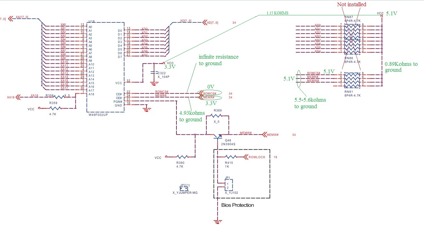

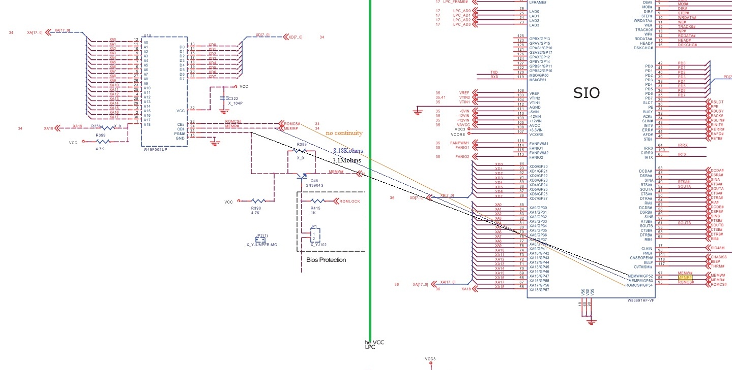

    Replaced ATTP1 thermal protection chip (had higher than normal resistance between VREF and ground pins), and the CPU fan now spins after pushing the power button; but don't have any BIOS activity (checked with a scope)
    There is 3.3V on VCC and 3.3V on OE# pin,
    OE pin is connected to R686 (4.7K ohms)
    but no voltage on CE# pin, and no resistance to ground either, and can't find where it goes to (probed all of the nearby components).
    5.1V on all pins of RN91
    (i don't have a schematic for this version board - the schematic for the "KT6 Delta rev 100" has major differences from the ver 2.0 board that i have - even the BIOS chip has a different board identifier "U32")
    Comparing to a similar BIOS chip on another board:
    The chip on another board has 11Kohms resistance to ground on OE and CE pins
    5.1V on Vcc OE# and CE#
    Maybe there is an internal layer that is damaged at the area of the burned VRM SMD cap?
    Am tempted to just run 3 jumpers from RN91 (located just under the CPU 4-pin socket) to VCC, ROMCS# and MEMR# in accordance with the schematic, and see what happens; but i think that it might destroy the BIOS.

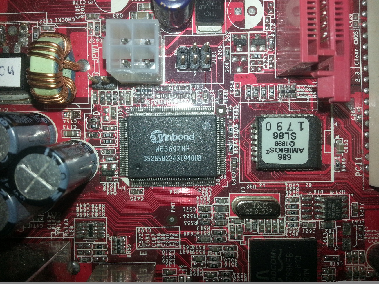

      I removed the BIOS chip and noticed that the chip enable pin was soldered to a pad that went nowhere.
      Since CE is 0v (Low) i'm assuming that that's OK, and that it's not being utilized;
      but the Output Enable pin doesn't go low, so no data is read (and no codes appear on the PCI analyser card, although the voltages, and CLK, LEDs are lit up.
      "The read operation of the W49F002U is controlled by CE and OE, both of which have to be low for
      the host to obtain data from the outputs."
      Could that mean that the BIOS chip needs to be reprogrammed?
      I'm also thinking that the 3.3V that is on the Vdd pin is OK, because it's directly connected to the 3.3V rail, even though the data sheet says that it's a 5V chip
      Thoughts?

        Well, i was looking at the wrong datasheet for the flash chip
        It's the same package type, so i assumed that it was the same flash chip as in the schematic.
        The flash chip is an SST49LF040
        So i compared it with another exact same chip that's on a good board, [Standby power only/PSU turned on]
        --------Faulty board--------Good board
        OE---0V/3.3V---------------1V/3.3V
        Vdd---0V/3.3V--------------1V/3.3V
        WE---0V/3.3V--------- ----1V/Continuous signal from 0V to 3.3V
        Clock signal is on both pins of LCLK, on both chips
        Does it look like there is something wrong with flash chip?

          Well, i finally reflashed the BIOS and put it back on the board.
          Turned on the power ,and no response whatsoever.
          The CPU VRM was running before i removed the chip, but there was no code on the PCI analyser card.
          But, as i moved the board, it started up, and halted after the second analyzer code
          So that was a good sign
          Then i noticed that i could cut power by flexing the board
          After some more flexing, it went through the entire POST sequence, and the BIOS screen appeared. Yay! 😀
          So, after many years, it appears this board is finally fixed (well, close enough)
          Looks like the original power surge took out that VRM SMD cap and also corrupted the BIOS
          I had a look at the CPU socket solder joints on the backside of the board, they all appear to be ok
          Reinserted the CPU, but the board still turns off (or on) when i flex it

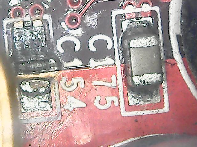

                  All that is left to do is to replace the initial VRM SMD capacitor back on to the tiny bit of copper that remains
