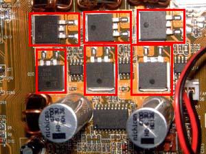

                      I'd be thinking failing MOSFETS - do you have a multimeter to check the VRM's output voltage?

                          Re: First recap MSI MS-6312/Gateway Flex System w/ problems
                          just measure acros vrm output cap near cpu.
                          see if the voltage 1.7-1.75 goes out of spec.
                          also make sure the heatsink is tight against the die.
                          those things are cheap and nasty.

                              In the below picture is what I need to test with my multimeter right (this is not my mobo this is just a pic I found off google)?

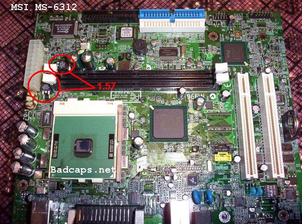

                                How do I measure the voltage? Please help me out, I am just figuring out this stuff.
                                Also I got this multimeter, will it do what is needed?

                                  Simply by choosing the DC voltage range at the multimeter, then put the plugs into the multimeter as shown in that pic at the shop.
                                  Now you can put the black wire to any ground (e.g. some of the motherboard`s screws or the tinned area around them on the pcb) and measure the voltage at any point you wish with the red probe.
                                  Edit: be careful to not make a short if you are measuring device which are running (this is obviously necessary).
                                  Do not measure devices carrying high voltage, unles you are knowing what you are doing (e.g. PSU`s, a PC board`s vrm is not dangerous, at the least if we are considering the voltage. The high currents in PC systems can easily heat any metal parts up till it is brightly glowing).

                                    I tested the board and got the voltages I found them to be around 1.57 on the below screenshot. Also I think I killed the board because I touched 2 points together on the FETs and now when I start it up nothing happens, so did I kill the board or can I just replace the FET to fix it?
