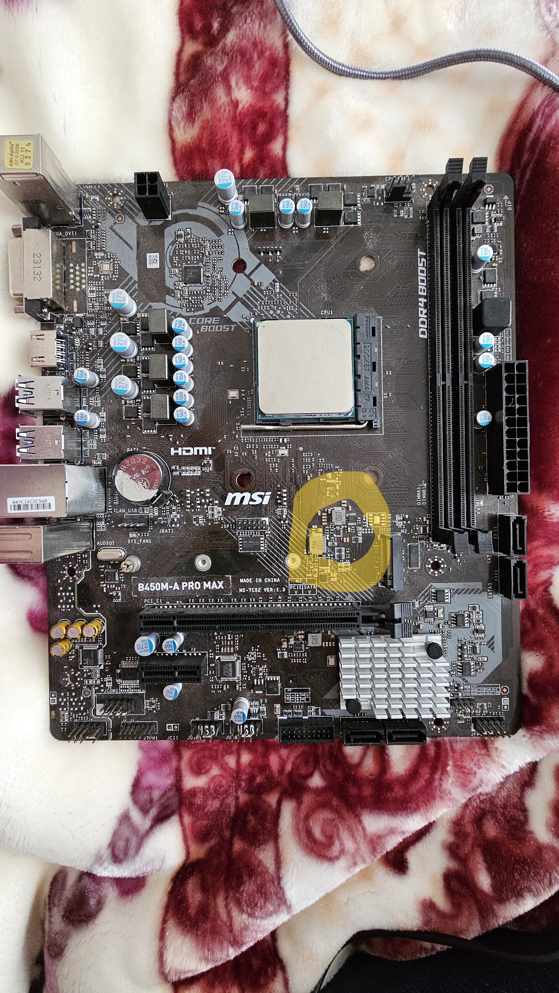

msi b450m-a pro max ram issue
  • ineedschemes
    • Oct 2023
    • 17
    • united kingdom
    booting up this mobo with different ram cards to see if its a ram card issue. speaker gives 3 long beeps and with AMI it means a ram issue. i was probing around there and 1.2v is present. there's 2 inductors (see photo) lower right of the ram slots that 1 gives 1.8v fine and the other doesn't read anything, DuRIng boot up!! what could this power lie be and what could be the fault. when looking over it with a thermal camera there's no heat coming from there at all.
    any help is appreciated.
