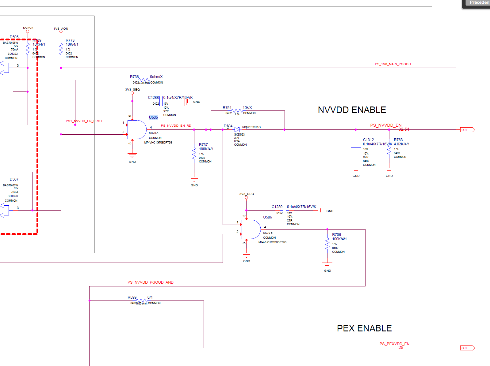

    I bought this faulty card for me and I am trying to repair it.
    There was missing components in one area so I replace them (I found some boardview and pictures so I figured out the values).
    The missing components were C1311, R625, C1221 and R759.
    But the card is still not recognized.
    I have 12v, 5v, 1.8v on the board but NVVDD_ENABLE is missing.
    But the strange think is that the voltages on U505 are good (pin 1 => 3.3V, pin 2 => 1.8V) but pin 4 is only 0.36V !
    Do you have any ideas ?
    Thank you in advance.
    PS : I used the schematic of this post because it's exactly the same on my board.
    Link to schematic https://www.badcaps.net/forum/troubl...67#post3315767

    i think u505 have problem if the require at pin 1 and pin 2 was pass, should be voltage leads from pin 5 to pin 4

      you can test by using wire connect pin 5 to pin 4, if gpu block coil not have voltage, maybe some fet was broken

        Sorry I didn't see your message.
        I ordered replacement parts for u505 / u506 I will see.
        • sauce
          • Sep 2013
          • 149
          • France
          I replaced U505 and U506 but still 0.3V on pin 4 of U505 even if I have 3.3v on pin 1 and 1.8V on pin 2 !
          How is it possible ?
          • sauce
            • Sep 2013
            • 149
            • France
            Yes I just changed Q501 and everything works ! Q501 was not a 2N7002DW but another reference.
              check for resistance to ground. something must be pulling it down.
              • sauce
                • Sep 2013
                • 149
                • France
                Yes it was Q501 after U505.
