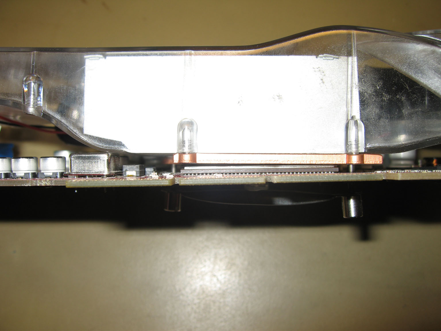

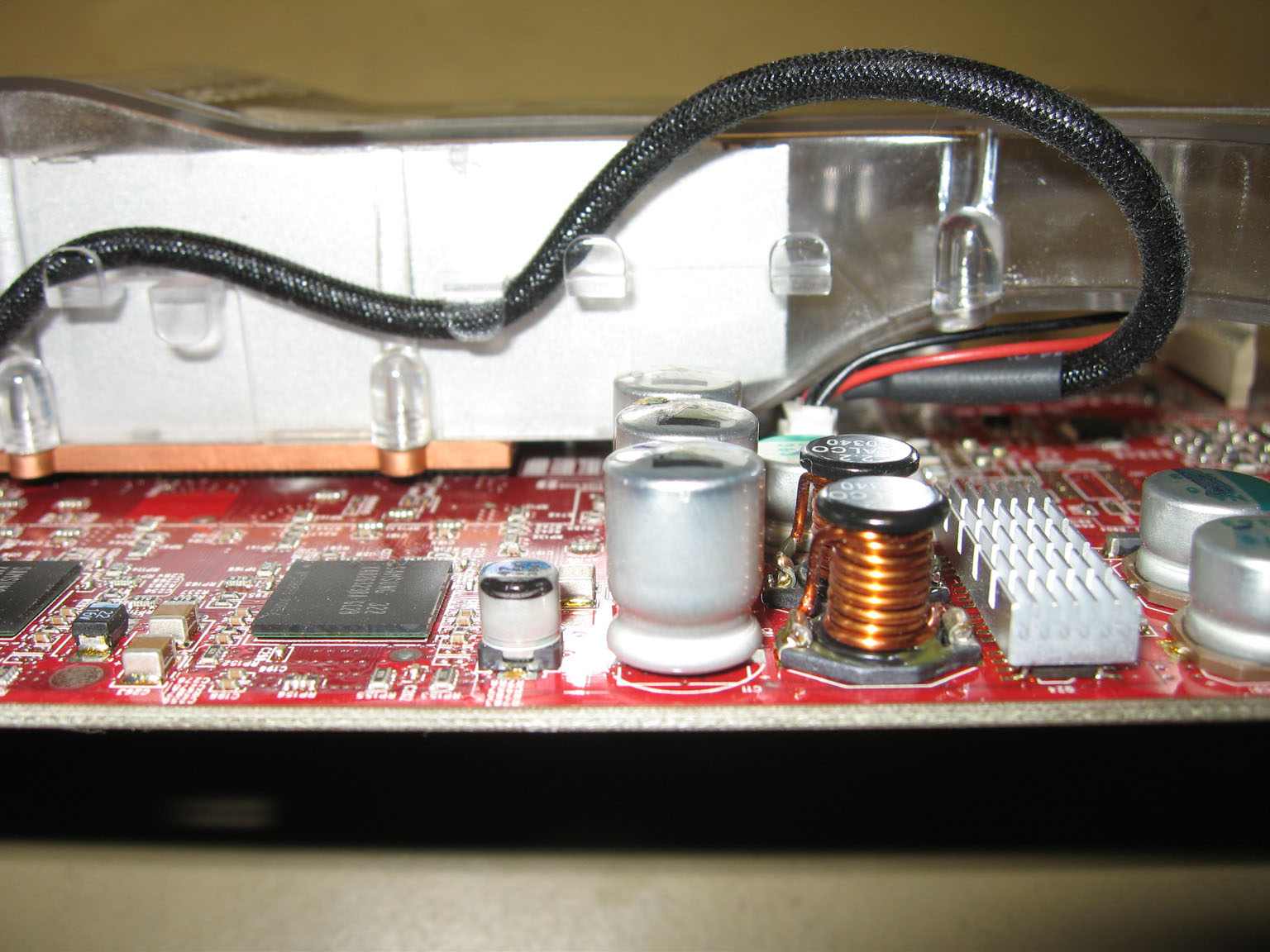

I just got an ATI 9800 Pro card from a friend which he said were showing a lot of artifacts in the picture (blocks and such). It seems to have both swollen caps and a heatsink not being properly flat against the GPU. The caps looks to be Nichicon HC caps. The cooling funnel for the heatsink fan hits the crystal oscillator, preventing it from sitting flat, so I guess I will have to modifiy it somewhat. Enclosed are a couple of pictures of the caps and heatsink. Are these three caps probably bad?
