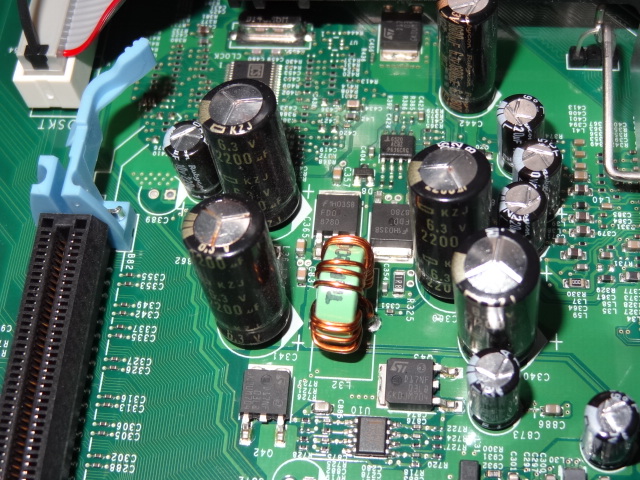

    I've been here before when I was researching a Tivo power supply but I'm back cause Dell got me. One of my dells started throwing errors, I rebooted however it wouldnt turn back on. I started investigating (visually) and googling and found I've got some bad caps. I've got another two Dell's that I'm going to recap preventively but that's another thread, I found they are starting to show bad caps (1 bulging currently). First I need to get this completely broken one back up and running though. I would like to add that fixing these is a must, I know they aren't the best and may have problems in the future, but for now it's what I've got so I'm going to fix them. I've done recapping before (4 tivo power supplies) so I have the tools (Hakko FX888D) and feel good that I can do this.
    So for the one that needs to get back up and running, it's a Dell optiplex 745 full size tower. The bad caps (that I see) are 4 2200uf 6.3v on the motherboard. Definately bulging. Darn Dell

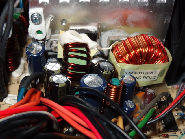

    I also (based on the second thread) opened up the power supply.
    Man, what a mess. I think they are all bulged!! It's going to need a total recap. Question is, do I completely recap it or get a new one? I'm leaning towards recap, much cheaper and I figure it will last a lot longer if I do it right, but it's going to be some work. I can't find any details on recapping that power supply and I see in lots of posts that capacitors in power supplies must be a specific type. Can someone give me a push in the right direction here? I can't even see half of them to order, does anyone have a list of all of them in this model?

    Re-cap both the entire motherboard and the PSU... I think those models have Sanyo SEPC polymers for the CPU VRM... PSU looks like all OST and LTec. Check those small 10V 220uF Rubycon caps on the motherboard. If they are 105C, leave them. If they are 85C, replace them all (You can use 6.3V if you want).
    First I would start with the PSU. What you want to do is remove the PCB from the enclosure, and you can do this by desoldering four wires. Two are the thick AC wires (Usually blue and brown), and then you might have another two skinny red wires for the on/off switch. Now you want to draw up a list with the Voltage, Capacitance, Brand, Diameter, and Series. An example would be:
    16V 3300uF OST RLX 12.5mm x 20mm
    Make sure to include -ALL- the caps, even those tiny 5mm ones. Post the list here and someone can direct you further.

      Recap the entire moboard? As in everything or just those 4 2200 6.3v's?
      The small (and there's tons of them) Rubycon 220uf 10V's all appear to be 105c. Letters on them are PET if it matters.
      The other moboard caps I see are:
      Rubycon 1800uf 6.3V MCZ's (thought those were ok).
      Rubycon 660uf 16v MCZ
      I don't see any Sanyo's, but there appears to be those (maybe) surface mount caps under the heat sink? There's one top left corner that looks like ones under the heat sink shroud, it has 652 SEPC 560 4 on it. Ok, just re-read your post, is that one in the top corner and from what I can see underneath the shroud what your referring to on CPU VRM's? And is that surface mount or through hole soldering? Cause I can do through hole, however surface mount ain't my forte.

        You can leave the Rubycons on the board, but redo all of the KZJs.

          So don't worry about the Sanyo's? And what should I get to replace those KZJ's? Thanks!

            Here's what I can see on the PSU. Boy that was fun trying to see that

              Good job. Yes, listen to c_hegge, just the KZJ. The Rubycons are OK because they are 105C. Dell sometimes uses 85C for the small caps on those boards and only then do they need replacing. The Rubycon MCZ and Sanyo SEPC are high quality caps, although I myself have a similar Dell board a year older than yours with a vented 10mm MCZ, yours are probably fine.

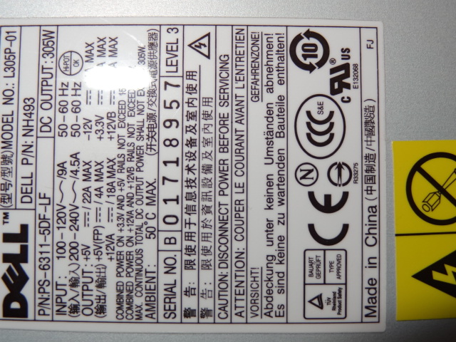

              I think PSU is made by Lite-On and it's a 2006 model judging by the capacitor datecodes. Model is L305P-01. It's worth replacing if it's a custom size. Otherwise, you're stuck with a replacement that also uses lousy caps. If it's a standard ATX PSU, then a quality replacement runs at about $50-$60.
              Don't worry about the measurements... I'm going to list you replacements from Newark/Farnell in the same order that you listed them. I can't use Digikey because they don't stock some of what you need. Here we go:

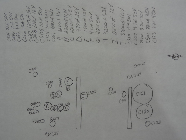

                        Here's the diagram I made in case anyone else takes this project on. Don't laugh to hard, I'm not an artist, but it serves the purpose

                                Well after reading the followup posts (thanks btw, very good info!!), I think it may be my technique. I believe the tip I was using was a T18-D16 or a T18-D24 and the temp was set at 750. I don't see a "TK" tip for my station (FX-888D). I do have good chemtronics soldier braids (several different widths) and a flux pen (both from digikey). I fluxed the legs of the cap and then started to apply heat to each leg individually. I may not have the station set high enough, or maybe need to use a bigger tip, but I was concerned with burning the board and cause irreversible damage. I didn't add solder as there were traces really close and that may have been part of where I went wrong. I kept the heat on one leg at a time trying to rock that side out. The positive leg seemed to free easier than the negative leg. The negative leg's had me getting the cap burning hot before I could get it free. Once I got it out I worked with the soldier braid (60-2 I believe) on cleaning out the hole, and after alot of messin I was able to get the holes clear.
                                My process worked, but it sounds like it's not the best way. What's the best heat setting? I don't want to melt the board. And I was afraid on using a bigger tip as the one I had was already wider than the pad, so I ended up pushing the braid in to the hole at an angle to help clear it when I got to that stage.
                                Hopefully by the time I'm done with all of this I get better
                                • LDSisHere
                                  • May 2012
                                  • 727
                                  • U.S.A.
                                  Re: Got Dell'd - Optiplex 745
                                  The actual tip number for your model would be T18-K. The tip is huge and when I first got one I did not think I would ever use it for anything because of the size. Trying to recap motherboards is when I came to see the value of this tip. Well a lot of the caps on the motherboard are soldered directly to huge ground planes which is why you found the negative lead harder to remove. This is also why a lot of people heat the boards before hand as it reduces the amount of heat required from the iron.
                                  It is about heat transfer and the time it takes. A big tip will hold heat better than a small one. Adding more solder when the tip is touching the cap legs and pads improves the heat transfer by adding more contact surface with the iron tip.
                                  Power supplies are much easier as they do not have ground planes like motherboards.
