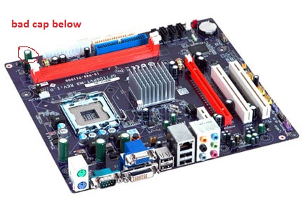

    MCP73-T-M bad caps
    I was upgrading harddrives and noticed one bad capacitor 6.3V 1800uF next to 24 pin power connector on motherboard. Other 16 V Sanyo capacitors looks fine.
    The motherboard is working fine, do I need to replace this capacitor and what is the purpose of this capacitor?
    please review the attached image

    Re: MCP73-T-M bad caps
    replace the cap.
    since you have an invidia chipset mobo, as a preventive measure out a small fan on the chipset heatsink.
