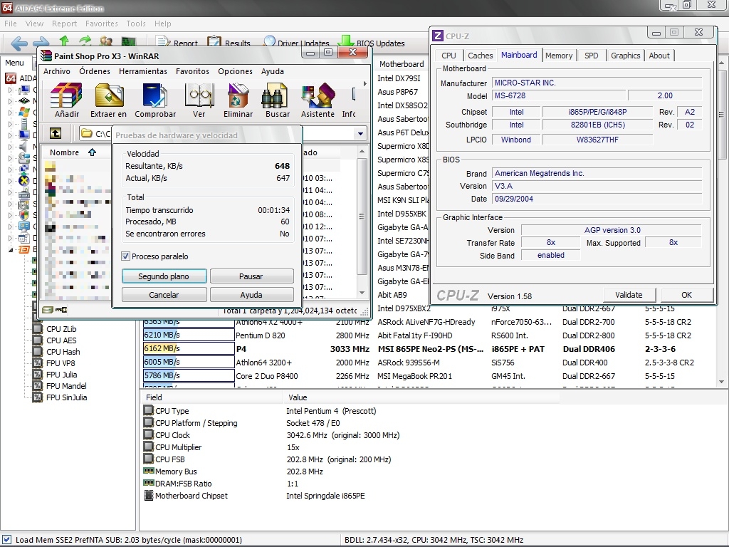

865PE Neo2-P Platinum Edition It's aliveeee!!
  • SIDMX
    • Nov 2010
    • 165
    • Mexico

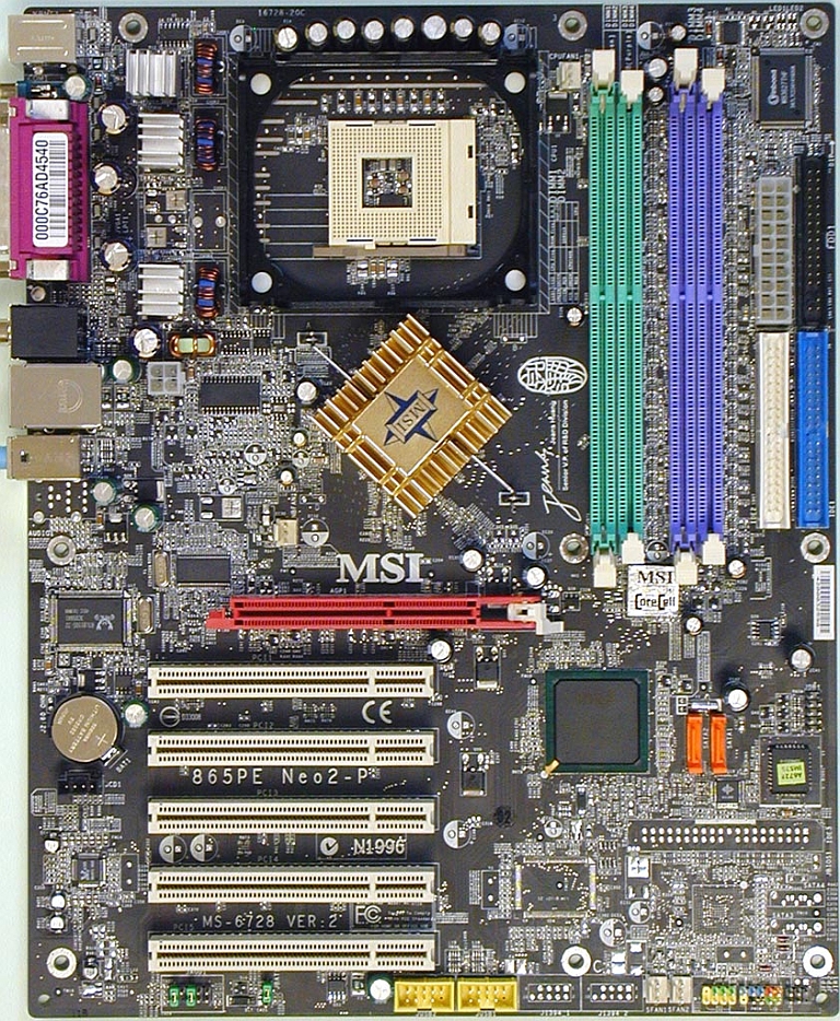

    Get this freebie from a friend a few months ago only thing he said was "that POS doesn't work", about a week ago i got some free time and decided to look at it, grabbed an old P4 Nortwood 1.6GHz, A-Data DDR400, a GF2 MX 420, WD 40GB IDE HD, new battery and a known good PSU HP-D3057F3R to test the board.
    Nothing gets abnormally hot and it always turns on but not always post, sometimes doesn't beeps if no RAM or VGA is installed and a few times when turned on it turns off and back on 2 times before finally post.
    Then i went for testing if vcore, vdimm and AGP voltages were present all the time, all were present and according to my DMM they were fine: 1.35v vcore, 2.53v vdimm and 1.51v for AGP, i've proceeded to go for a partial recap of just vcore and vdimm caps and it did resolve the on-off and no beeps issues, but was still very unstable.
    Replaced the crystal oscillator near the clock generator (it looked really bad), but it didn't get better, so WTH full recap!! ...well, full recap using scrapped caps from several boards that are running perfect because i just want to know if this board can be saved from the dump. You can see some OST caps in some places and TK caps in VRM input, for VRM output i put some good Panasonic FL and a single Rubycon MCZ for vdimm.
    Well finally all issues were gone (or so i thought) and i was able to install XP, so maybe some or all caps in NB, SB or AGP VRMs were bad (who knows), anyway i discover (or uncover) a new issue: board didn't holds bios settings if PSU is turned off, or disconnected in this case.
    Rechecked battery ...3.19v so it is good then i put back the battery and proceded to check the voltage at cmos pins... bingo! 0 Volt, tried to trace the path back from cmos to battery holder and found 0 Volt all the way to the holder, visually inspected the holder and it looks good , i mean, it does show very very light dirt in the contacts but that is, after cleaning the contacts same result 0 Volt in the pins, so battery holder was replaced and it's done! 3.18V at cmos pins and finally get rid of all issues!!

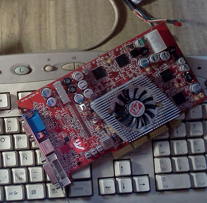

    Then stuffed the board with 3GHz P4 "Pres-hot", 2x512MB GeiL DDR 400 2-2-3-6, Radeon 9800 Pro and a WD 320GB SATA Drive, installed all drivers and some software, enabled PAT in Bios and ...oh boy! ...this thing bigtime ! Look at those RAM read speeds, they are pretty much in DDR2 lands!! I need better cooling, this thing is reaching mid 60's °C under heavy load easily, almost forgot how much heat this Prescott's generate!!
    This board will be waiting for all new caps for at least 1 month, and will not be used until then.The board uses 8x 1800uf 6.3v 8x20mm KZG caps in VRM output so if i want to go poly i need to halve farads and keep the total ESR as close to or slightly under the original right? or ...is it safe to go below the original total ESR? Any feedback like recommended brand/series for recap, good and silent cooling for P4 or anything else will be really apreciated !

            Then i went for testing if vcore, vdimm and AGP voltages were present all the time, all were present and according to my DMM they were fine: 1.35v vcore...
            That's too low. Should have been an indicator of bad caps in Vcore. desktop Northwood and Prescott (S478) CPUs are all 1.5V. I overlooked this issue about 2 months ago on a crappy ECS P4IBMS board. Had no post and no beeps. Board acted totally dead. CPU Vcore was reading similar to yours 1.35V sometimes and 1.4V other times. I though the board was completely dead, but then I decided to recap it anyways despite all of the G-Luxon caps looking good. As soon as I did that, the board booted just fine.
            In the CPU VRM (and generally all buck-type regulators), you can go below the ESR of the original caps. Actually, the reason the half-capacitance "rule" with polymers works is because the very low ESR of the polymers is able to make up for the lower capacitance in that circuit. So you don't necessarily have to go with half-capacitance per cap; you can have it higher. But with polymers it's no necessary. 820uF 2.5V polymer caps (like the ones that badcaps.net sells... i.e. these) should work fine, even though they are slightly below half the capacitance of the original.

              Originally posted by momaka
              That's too low. Should have been an indicator of bad caps in Vcore...
              Dammit! you're right I forgot to spec the processor before taking the read with DMM.
              In the CPU VRM (and generally all buck-type regulators), you can go below the ESR of the original caps...
              Thanks for the explanation, then i'm gonna use polys for CPU VRM.

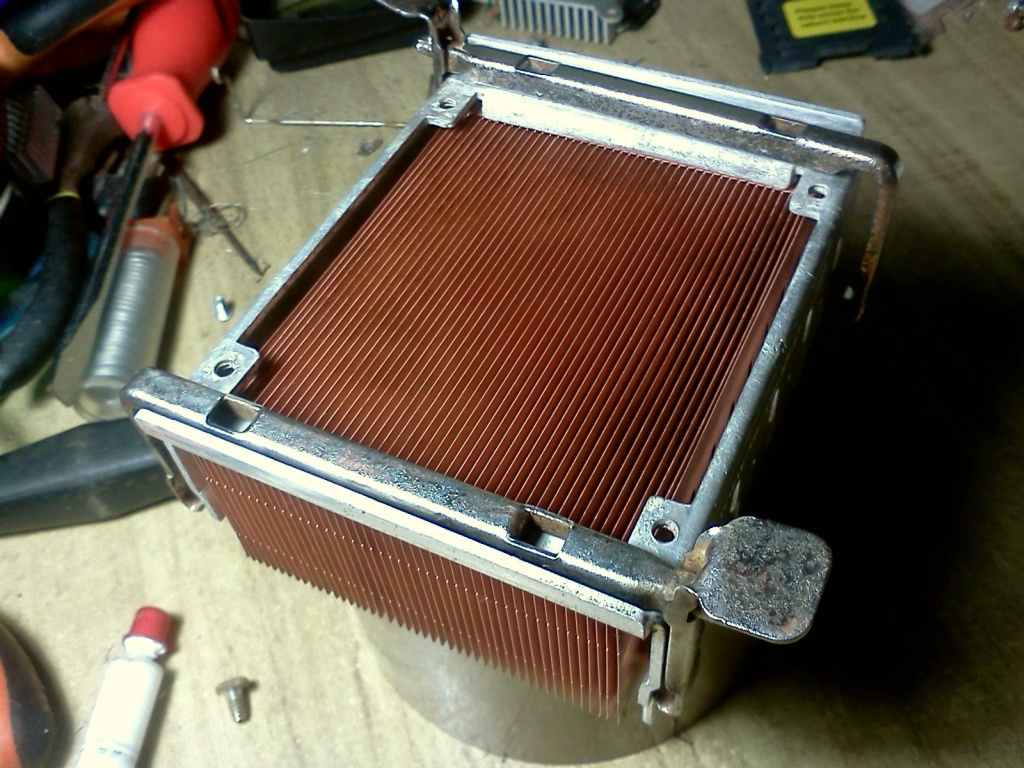

                  uh-oh:

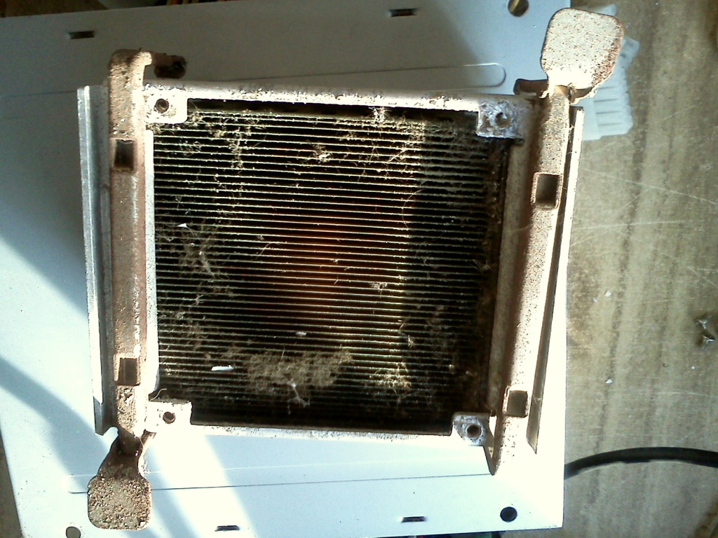

                  finally found it but looked ready for the trash can, where i live humidity is around 80% most of the year but sometimes it goes really high, in rain season it is above 90% and that can last for weeks, so I learned my lesson: "never store a heatsink without cleaning it first or without throwing some desiccant inside the box"

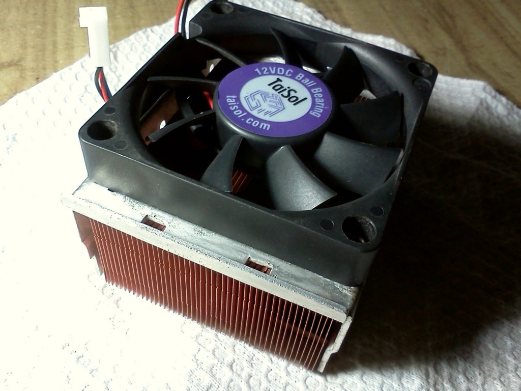

                  The fan was missing however i have a TaiSol fan (rebranded Delta) that can push 40cfm but it is as loud as the original so i need to test all my 70mm fans to find the best option.
                  I've done my best to get it clean but the clips were so much rusted, that aside i think it is pretty clean now.
                  TaiSol fan attached:

                    Re: 865PE Neo2-P Platinum Edition It's aliveeee!!
                    Do not expect a gold metal for your cooler.
                    I still have the best of that era = Thermalright SLK900-U

                      BTW, how did that heat sink work? I'm curious as I have a source of more of those Xbox 360 copper heat sinks I mentioned.
                        I haven't done any testing yet, except for the 70mm fans, i think i'll be using the TaiSol fan, it's not as loud as the datasheet shows, i will be doing some tests in this weekend and will let you know how it perfoms, I really have high hopes in that cooler, beeing all coper with thick base i'm sure it will lower my load temps at least 5-8 °C.
                          Definitely. I've seen smaller but similar all-copper heat sinks in HP DC5000 and D530 SFF boxes with squirrel-cage fans, and they still manage to keep the CPU cool just fine. (and those usually have P4 2.6-3.2 GHz Prescotts with HT).

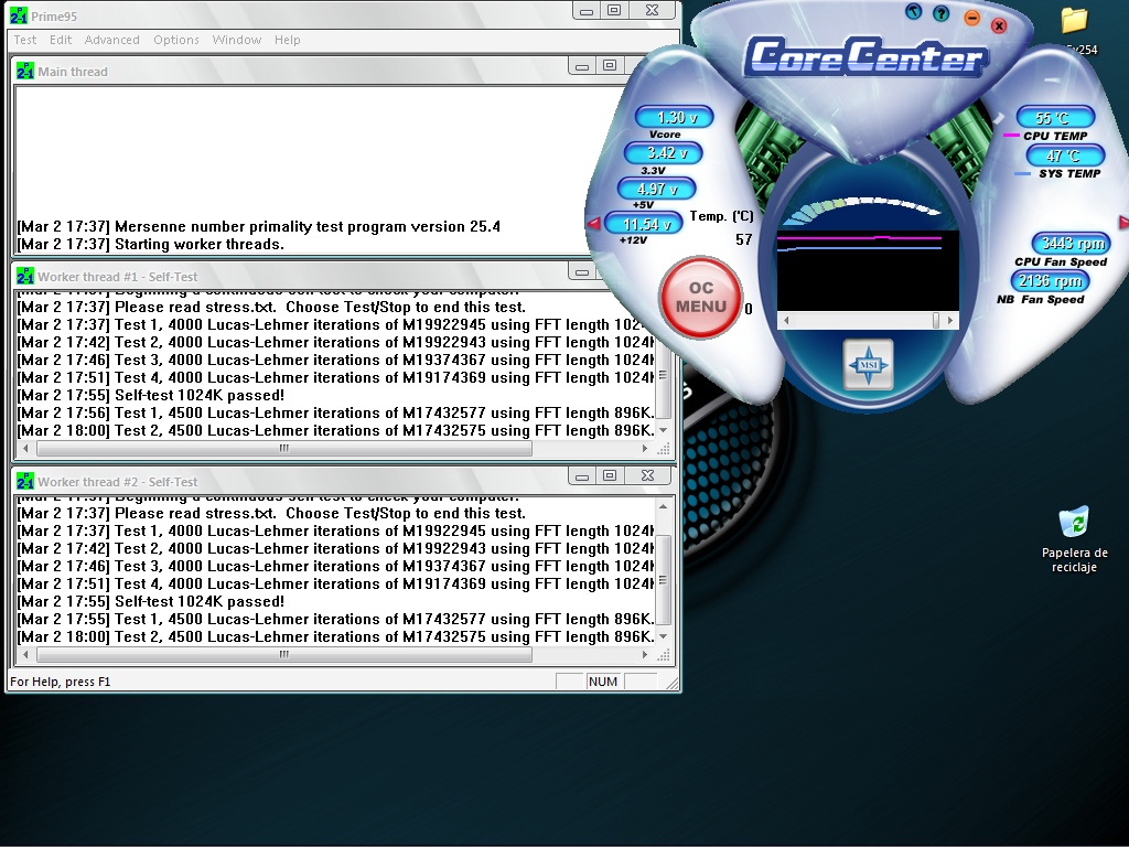

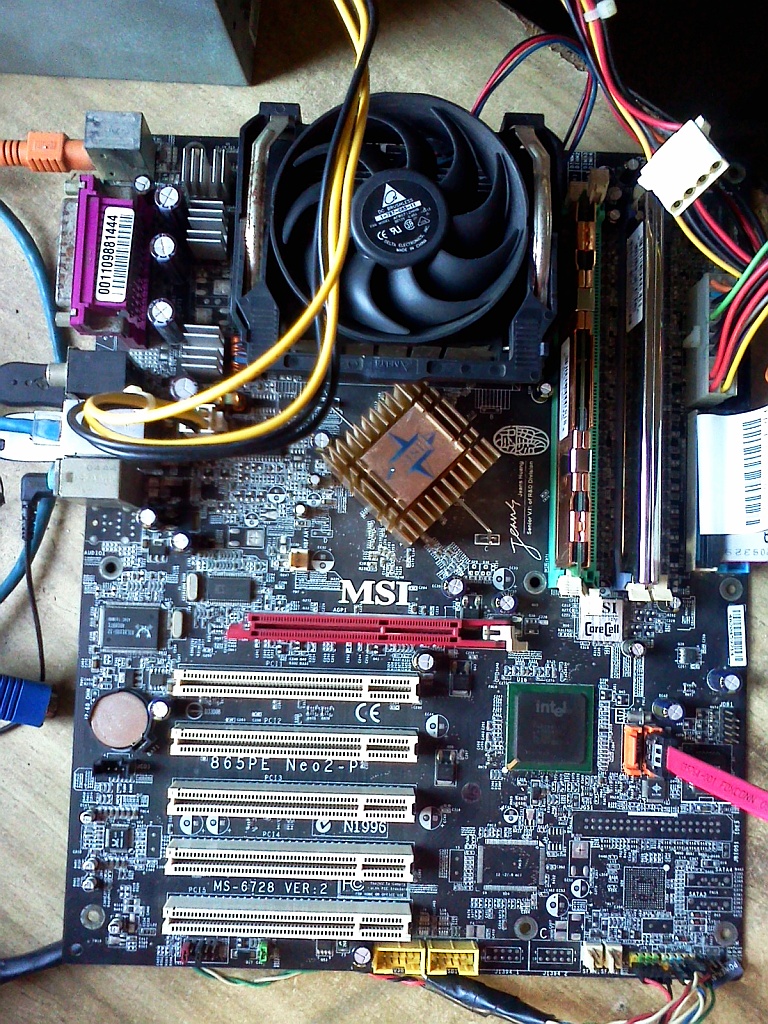

                              Just finished testing the cooler, results exceeded my expectations a bit, load temps went down 10°C, from 65-67°C to 55-57°C
                              Core center shows CPU and 12V voltages unstable, but software readings are known to be very inaccurate, my dmm reads a steady 11.88V from 12V line under load and 12.00 in idle state as for the Vcore i could't take any readings because the test was made with motherboard inside a closed case to get realistic results, once i get new caps will do proper tests for Vcore if required.
                                Nice!
                                Copper heat sinks are indeed the only way to go with these "PressHot" P4's . The HP DC5000/D530 SFF boxes have nice copper heat sinks and after running CPU intensive stuff, I get similar temps as well (usually topping out in the mid 50's Celsius).
