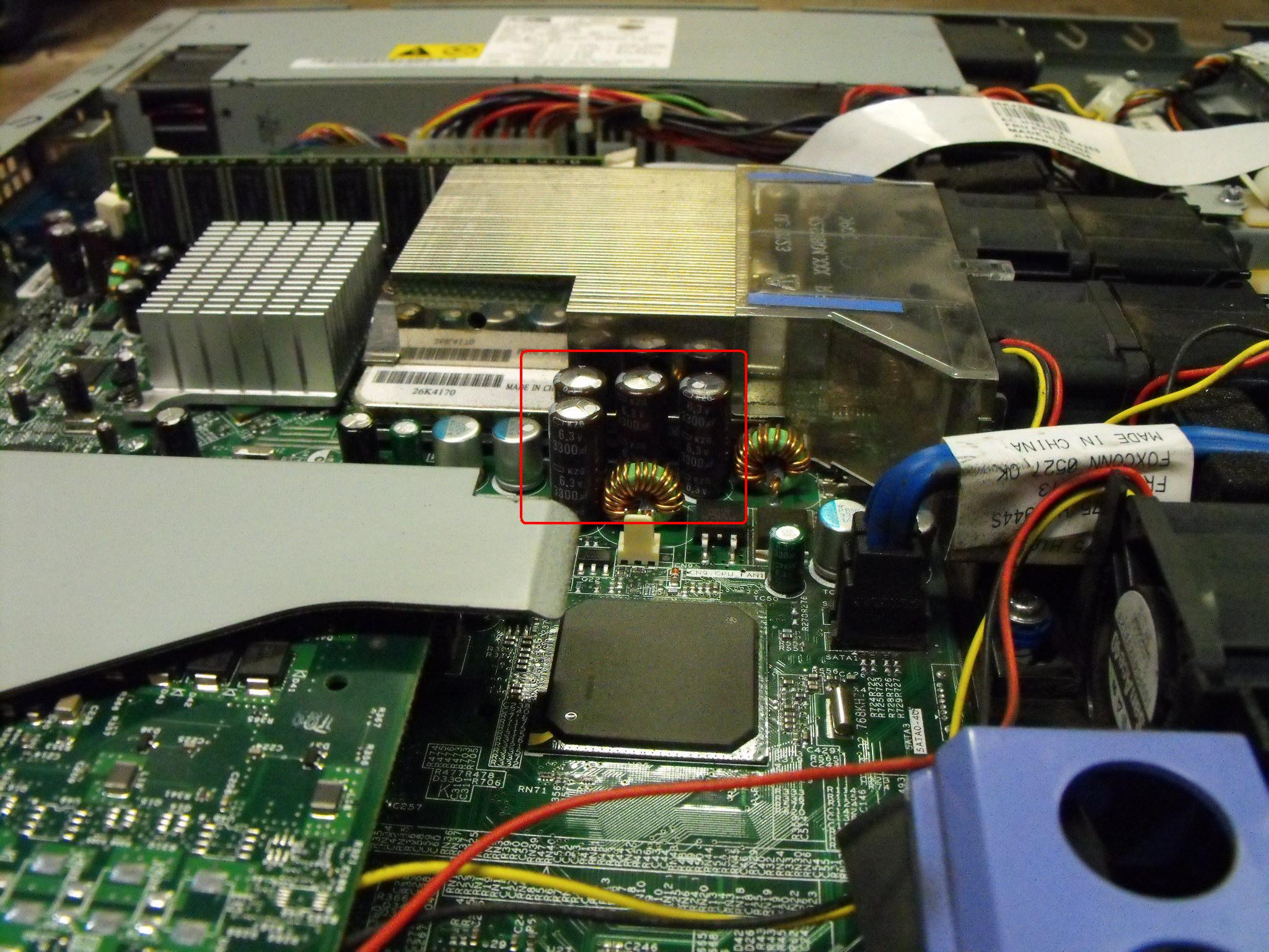

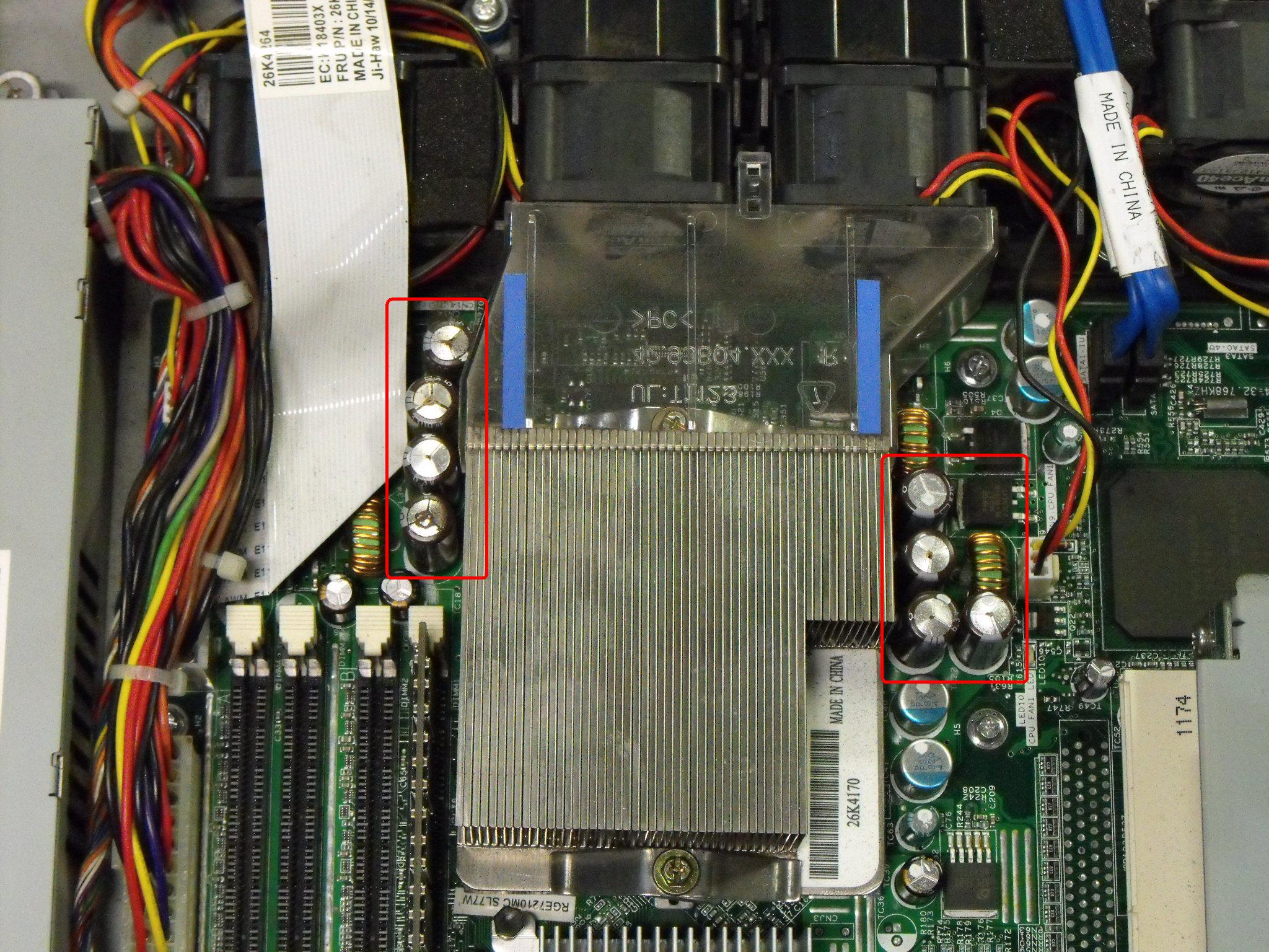

    I've got an IBM 8836 1U server that's shutting down abruptly;
    It has 8 Chemi-con KZG (I think) bulging around the CPU;
    3300uf 6.3v KZG (M)105c 5(7) Brown
    Being it's a 1U server, even though it's got several fans, it probably gets pretty warm.
    What do you guys suggest I replace these with?

    Re: need suggestion for replacing KZG caps
    Nichicon HM 3300uf 6.3v will be the same size and spec.
      Thanks, sorry for the delay; haven't been online.
