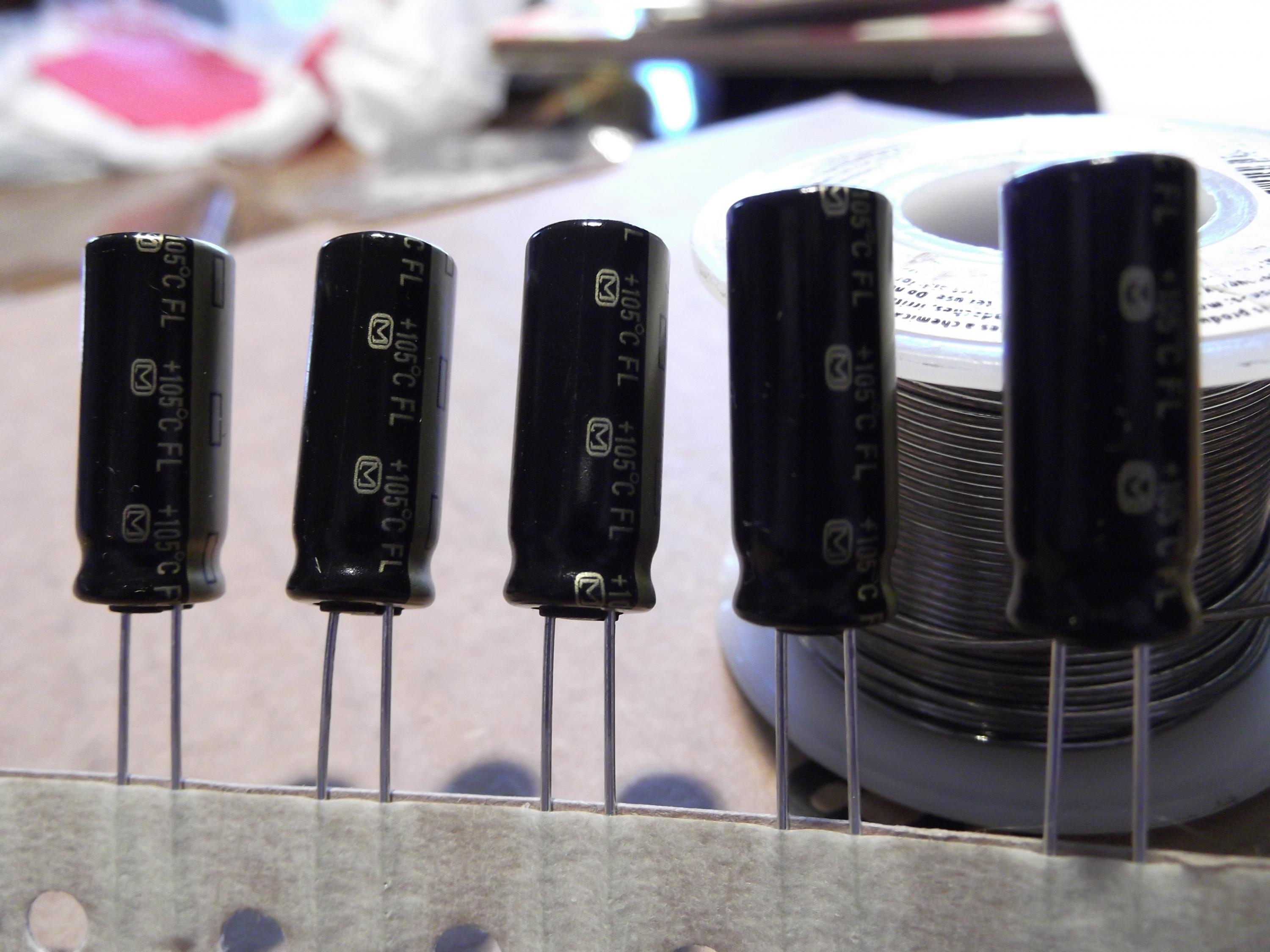

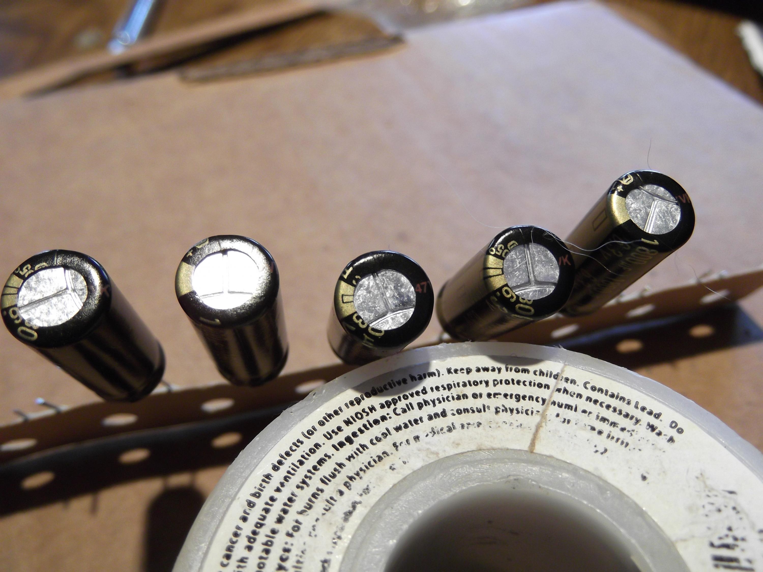

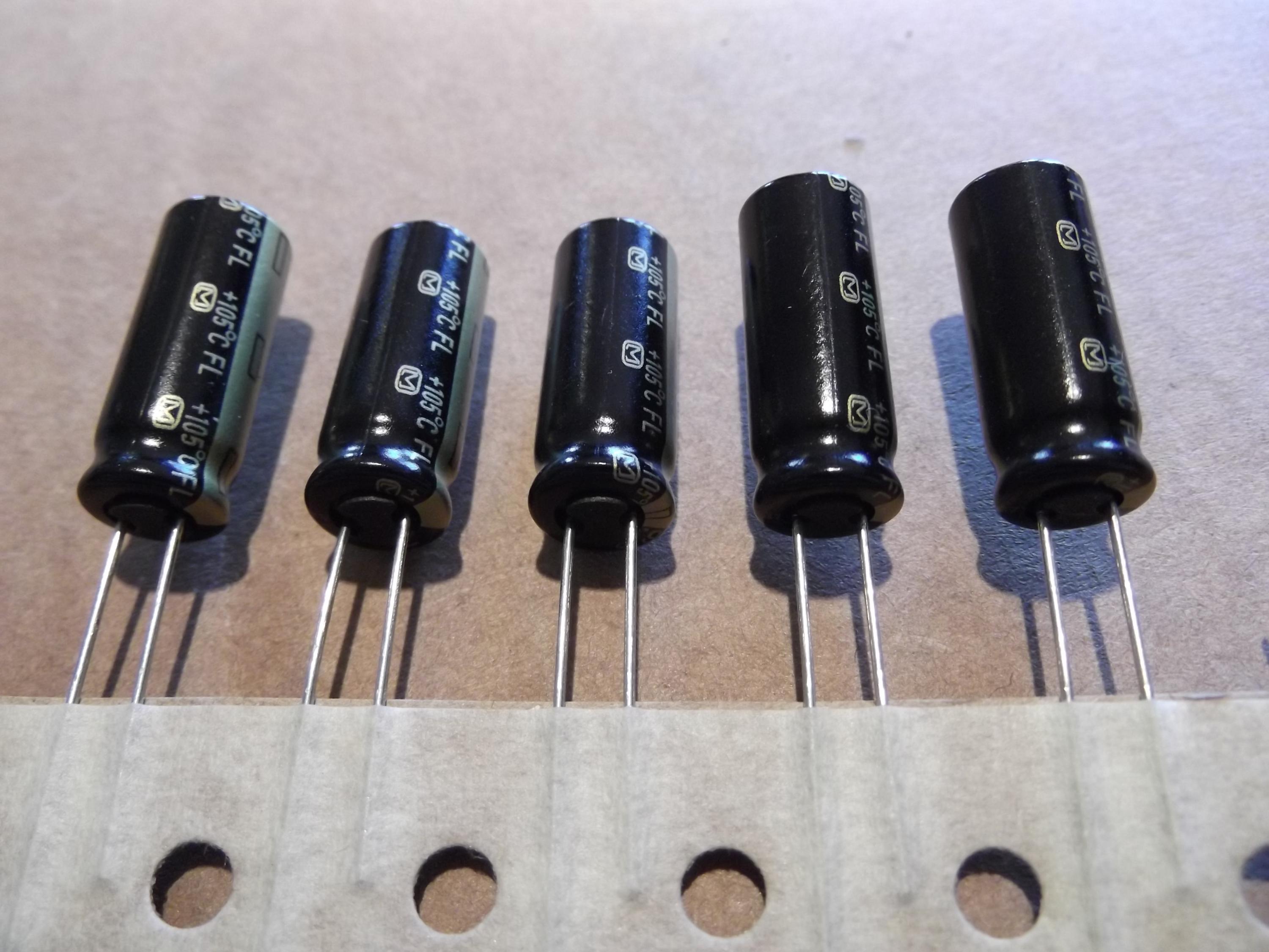

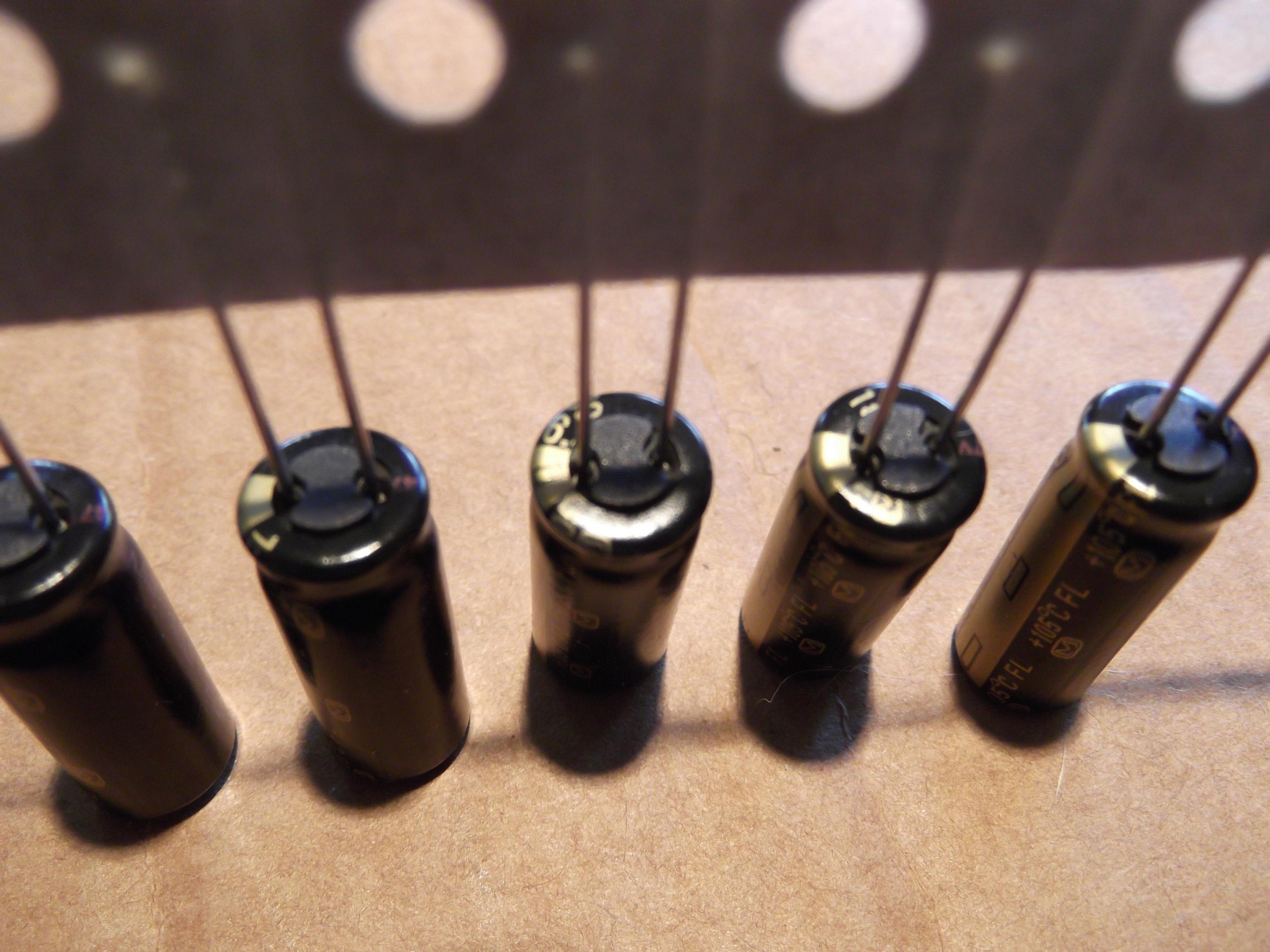

            Where did I get the Panasonic FL from? I don't remember. They are some I had, they came from some electronics store.
            They are black with gold printing.
            Some of them have a "squished" [M] logo, like it is much shorter than it should be. The same width, but not as tall (the logoo). They aren't all that way, but some are. Does that definately mean fake? Or do real ones sometimes vary in printing like that? They are all in the same cardboard roll, so they all came together.
            They all have a strip of red lettering down the side, it says 47VVK
            Anyway, is there somewhere on this motherboard that I should check for certain voltages?

              Whichc electronics store would stock Panasonic FL? Most likely they are fake, but post a picture.

                Re: MS-7548 Replaced Caps - No Fix
                Here are the pictures.
                • mockingbird
                  • Dec 2008
                  • 5484
                  In my opinion, they're the real thing. The next thing which comes to question is the quality of your work. Did you do a good job? Did the solder take? Also, check the other caps on the board... I notice a variety of caps scattered throughout, but what I'm particularly interested in are those Toshin Kyogo caps near the memory slots.
