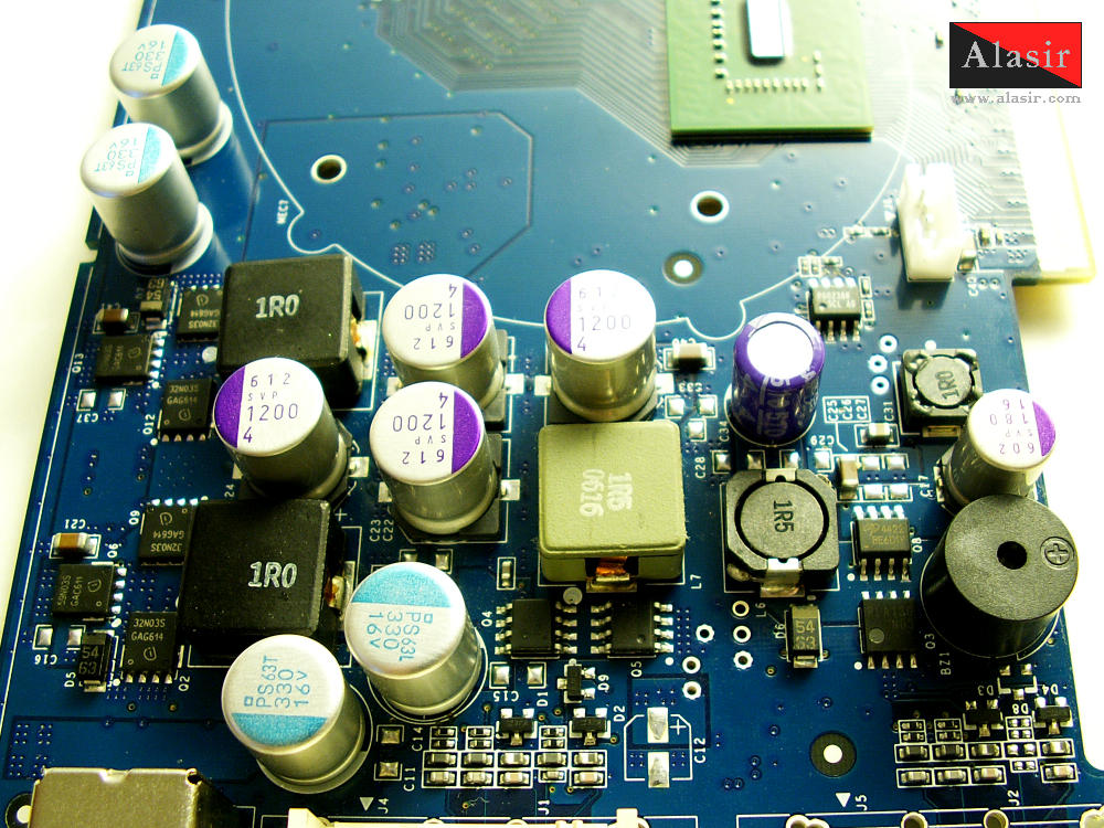

Hey folks, I bought a graphics card at a garage sale for 3 bucks, and all I have found so far is it is missing a cap, I have been able to determine the can is a 1200uf 4volt, What I do not understand is the top number, The picture I am using I borrowed, but it is basically the same. On My card the top number reads 601 then under that it is SVP and then 1200 and finally 4, I have located several caps that are 1200uf and 4v, but all have different numbers at the top and I do not have a clue as to what they mean. Thank you very much for your help
Nvidia GF 7800 GS Sanyo SVP Caps question
Re: Nvidia GF 7800 GS Sanyo SVP Caps question
Sanyo surface-mount 10mm x 12.6mm polymer capacitor.
Series: SVP
Ripple: 5440
ESR: 0.012
Topcat has no stock, let me check around...
Here you go:
http://www.digikey.com/product-detai...2-1-ND/2242502
