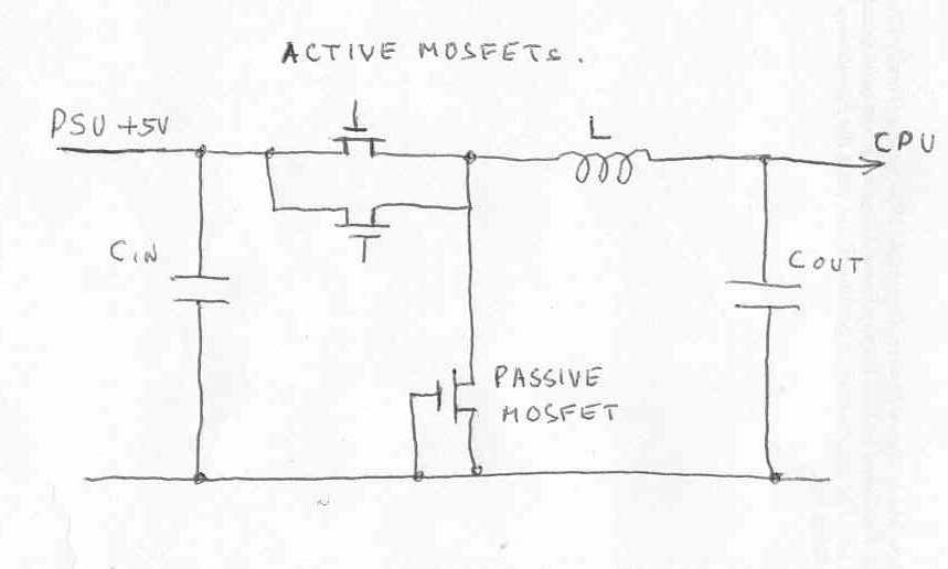

              Hi Trodas,
              Yesterday I thought that I would explore the actual loss differences if the load was shared by two MOSFETs.
              I aborted yesterday's posting because of a mistake. Also it seems that it is better to attach a document with a table.
              Please see attached.

                  Hi Trodas, I have been waiting for someone to respond to my calculations. The calculations were just to see what losses can occur in a MOSFET. In actual fact the values are not directly related to any motherboard VRM because it is my understanding that in a VRM there is normally two MOSFETs per phase, one connecting the supply to the choke and switching OFF then the other connecting the choke to ground during the OFF period. This MOSFET connection is often called totem pole, both connected in series between supply and ground with the choke connected to their mid connection. This is the usual method and this means that the ground connected MOSFET does the job of a diode in the OFF period, therefore there is no diode loss in the supply side MOSFET, that leaves only switching loss and Ron loss.So less dissipation in a VRM MOSFET.
                  10A load in one 20 milliohm MOSFET = 2 watts loss + switching loss. Not much really.
                  As you are no doubt aware the risk in a totem pole method is that if any one of the two MOSFET fails short then the other connects into a short circuit when it switches ON. Why everybody changes both MOSFETs when failure occurs.
                  The 15N03L (should read 42N03L) seems a very adequate device for this system. I suspect that the currently available 15N03L devices are upgraded (42A) replacements for an original 15A device.

                        Like I say, I'm not very familiar with the calculation around the switching loss. The resistance loss is, however, very simple thing Just if we know, for how much time it is opened...
                        And for two mosfets in parallel? 5A per each = 1W for both + switching loss?

                            Hi Trodas I have attached my reply. So that formatting is not lost.

                              Trodas, now that I have a good idea of your VRM type better calculations and conclusions can be drawn. See attached

                                I agree to that equation, the loses aren't that high in those Mosfets. I belive, the failing caps has lead to an very high duty cycle and may be to other side efects, the controler chip forced the whole vrm, due to the high noise and fluktuating voltage at the output with bad caps. In the edn, the weaker or hotter mosfet had been died. So i think replace the caps, take two good mosfets and let it go back on duty.

                                    davmax - thanks for the explaination, mate. So, in conclusion the efforts making the mosfets run in parallel aren't worth the 14W VIA C3 scenario, probably not even running fanless. However the last mosfet you find rock
                                    IRF3709ZS is not only rated at 87A, but mainly has a very small resistance - 6.3 miliohms and also the total gate charge 17nF is nice.
                                    The one I found have twice the resistance (12 miliohms) as well, as it is "only 64A and has gate maximum charge 33nF (dunno why there is not the average one listed, it could be bellow 20nF, as the IRF3709ZS show 17nF typical and 26nF as max gate charge...
                                    But mainly the resistance is FAR FAR lower, witch give - in fanless operation - enough adwantage to make me want it. There is only problem - Non Stock...

                                      Trodas , Have you had any success searching for IRF3709ZS? AERI have the DPAK version in stock (smaller). I have requested a search for the right part from AERI. See what happens.

                                        Sucess!!!
                                        A BIG thanks to Big Pope - package from him, containing two 15N03L make it today, thanks a lot! I replaced the mosfet and the mobo did not kick in - it allways shut off immediatelly. So I checked the bottom mosfet better and it seems to be conductive real well (0.4 ohms, while the wires used to measure has 0.2 ohms itself) between it's collector and emitor, so I replaced it (thanks a lot Big Pope for the second one!) and the mobo then kicked in w/o a glitch
                                        Fantastic! Now just the cursed PSU and my server is kicking back again.
                                        Anyway, after a quick look and re-setup into the bios the mosfets are hardly warm. The chipset is the hottest part - about 50°C quite fast. CPU is 42 (passive) and board sensor say 40°C, however it is close to the voltage regulator for chipset - another relatively hot thing.
                                        Conclusion - the mosfets are hardly even loaded and replacing them with better ones might not be worth the hassles - Pannyes should not fail so miserably and when they does, it should - thanks to the ceramics now everywhere - be with some crash-warnings before, so I could replace them in time. I hope.
                                        Still, having two of these IRF3709ZS is worth the bucks Digi-key asked me for it, however it is not yet worth the troubles with customs, so I better wait till my contact in Canada wake up...
                                        I would definitively feel safer with them on hand
                                          You were lucky with that. Even one remaining bad MOSFET is enough to get the smoke out again. That's why you should always test all MOSFETs. When in doubt, desolder the legs of all of them (leave them soldered by the tab only) and test.
