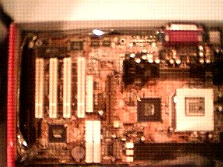

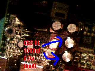

    As you can see I've a Jetway 993AN with two busted GSC RE-series 1000uf 6.3 volt caps around the VRM. The question I'd like to ask is, would it be alright if I use Rubycon MBZ 1500uf 6.3 caps in the place of the GSC? (Please note the difference in capacitance...)
    Thanks,
    urabahn5

    In generall it is safe to use larger caps (in destinnct limmits). I think this should be no probelm there.

      And if there are any other GSCs, don't forget to replace them all. Sooner or later, they will fail all.

        OK, I replaced all but one of the 1000uf 6.3v GSC RE caps on the board with Rubycon MBZ 1500uf 10v caps. (I ran out of caps before I could get to the last one. Of course, I replaced the two busted caps.) I'm currently testing the board, it tends to flake out occasionally under Windows 98SE but that's only to be expected of an el-cheapo board based on a very old VIA chipset anyway. Once I get all the caps changed out I'll probably start seeing an improvement in stability.
        Thanks for your help (again), guys.
        EDIT: I forgot to mention, there are a bunch of GSC M-series general-purpose(?) caps all over the board. I'll probably try changing those out too once I get some more caps.
