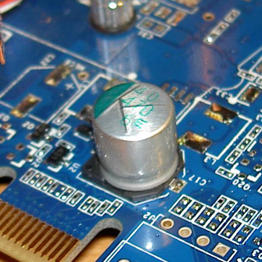

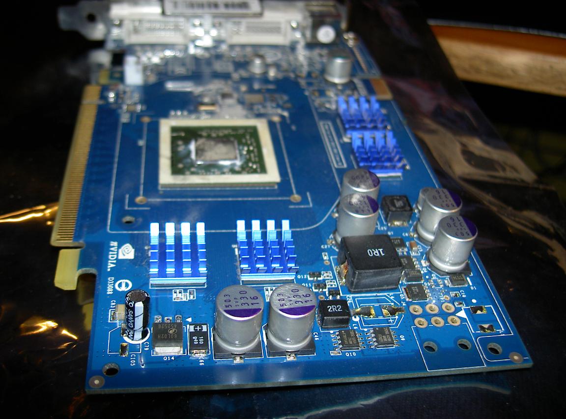

    XFX Geforce 6600GT
    Running ca one year, not 24/7, but close too...
    The cap looks very clearly bulged, because you can see the "K" mark, the other caps (in the VRM section) looks fine... What make/model of caps is this? I though solid polymer caps where not supposed to leak??

    Re: XFX Geforce 6800GT
    well if they have vents they are not polymer. they might be sanyo CV-EX with hybrid cathode electrolyte as this looooong relevant thread suggests

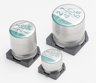

      Hmm, was looking for the cap on Elfa and found it...
      The "K" vent is visible when they are new...
      But the cap on the card is also clearly bulged, about 2mm I'd say... The cap is 10mm wide and 10,5mm high...
      Thnx for the links... I had read that on the 6800le cards before, the info about the CV-EX caps was not in it then though...
