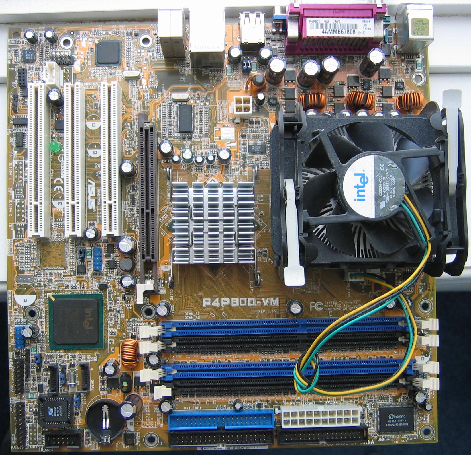

    Got this Asus P4P800-VM recently.
    There is no standby power light on the board. There is also no 3.3V DC on the PCI slots.

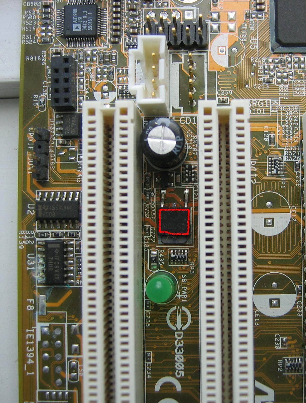

    The transistor C5706 is shorted between B-C, C-E, and B-E. I'm used to seeing the shorted C5707 in Benq monitor boards.
    Here is a shot of the c5706 chip. It is sandwiched between the PCI slots and I'm not sure how difficult it is to desolder or even possible without destroying the surrounding chips. I thought about cutting off the legs (inner and outer) and just "stacking" a c5707 on top, but I can't fit my side cutters in between the PCI slots.
    Any ideas on how to remove this c5706 chip? I don't have a solder station, chisel tip, or liquid flux to remove the tab. If this is removable with proper tools and technique/skills, then I'll try to find someone else to remove it.

      I think it should be do-able with a regular iron. Just preheat the area around the transistor with a hair dryer or heat gun to make it a little easier to desolder it (don't make it too hot, though - after all you want to be able to hold the board). It may also be helpful to remove that green LED so it's out of the way.

      Not really. It has a dead transistor and a OST RLP cap next to it. When you use such fantastic components, you ought to get fantastic results .

        Removing that transistor takes less than 30 seconds with hot air in one hand and an iron in the other. No parts will be bumped off and the PCI slots won't be damaged. It comes off in good shape so you can test and reattach as necessary.
        It can also be removed with two irons and two people. Unfortunately since neither of you will be any good at soldering and won't know how much heat needs to go where, it will be like two bulls in a china shop. The legs will be bent, pads ripped off, and nearby parts will be dislodged. Many of the nearby parts are too small to reattach without hot air. Very small parts like C135 next to the skyscraper are difficult even with good equipment.

            looks like u31 on the left edge got wet.
                I did notice that after I looked at my photo.
                The person who I got this from said it wouldn't power up one day and then it was put away for about 10 months (presumably somewhere inside their house) before I received it. The person didn't say anything about power spikes or spilling any liquids on it.

                    I desoldered the OST RLP cap (1000uF 6.3V) next to the c5706 since that is I all I can do for now. It read 1013uF on my multimeter. I don't have an ESR meter so I don't know the value.
