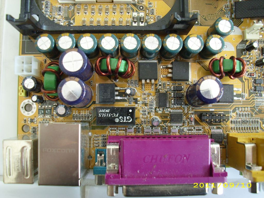

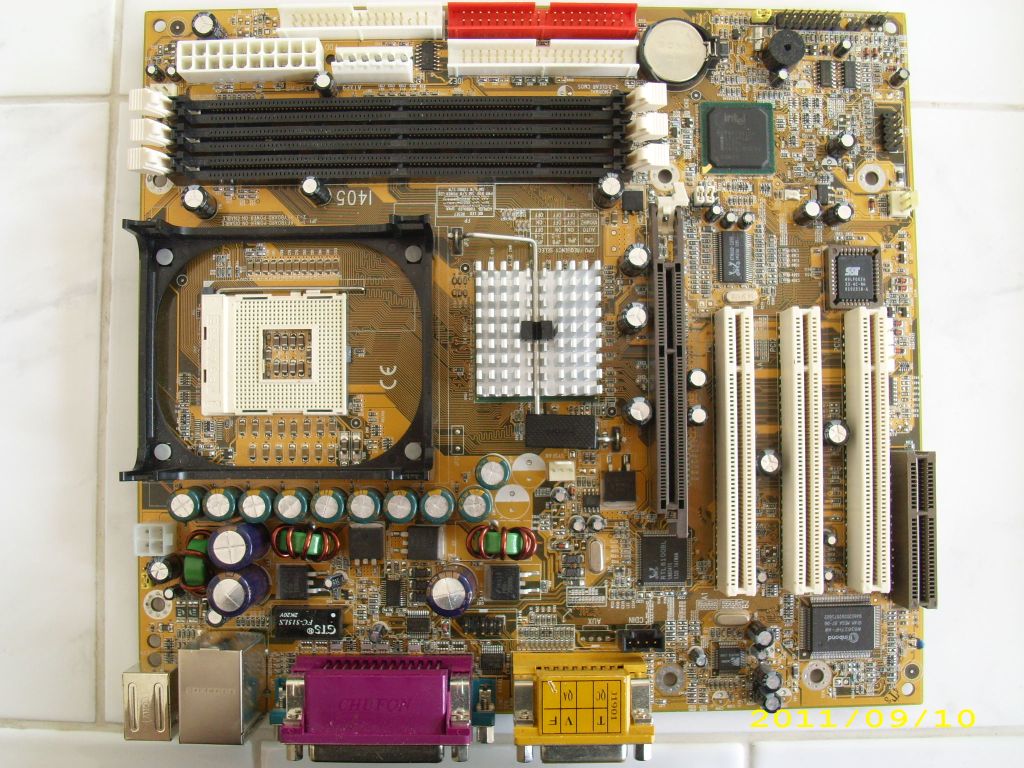

    Jetway i405 is a P4 Socket 478 MoBo. It died because of 2 two large bulging purple caps marked "GSC 2200micF 16V". The 10 medium green caps by the 478 socket marked "TAYEH 1500micF 6.3V" are OK while on another Jetway MoBO type 350DF, these caps by the 478 are "GSC 1500micF 6.3V" and most of them are bulging/oozing.

    Ah, good old GSC. They also go by the name of Evercon, and more recently, Sacon. Sacon are notorious for failing on video cards.
    Tayeh aren't stellar either, if you're using anything higher than a 2.4GHz on that board i'd advise to replace all of those as well.
