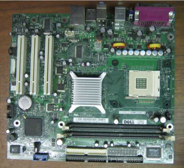

                  Here I stole this from an eBay ad.
                  - Where is the bad cap?
                  BTW: Nice board.
                  An i865 chipset, a VRM with 8 MOSFETs and most Vcore caps poly already.
                  I'm not surprised there aren't may broke ones.

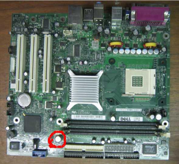

                  • ajcox1234
                    • Feb 2011
                    • 57
                    Re: Bad Nichicon HM(M) on Dell Dimension 3000 motherboard.
                    Here is the bad cap.

                        I can just buy a bad Dimension 3000 board on eBay and steal the cap by the dimm slots on it. LOL
                        • PCBONEZ
                          Grumpy Old Fart
                          • Aug 2005
                          • 10661
                          [Guessing] I think that's on 5v.
                          Short of just a dud cap it probably died due to ripple.
                          If those Lelons in your PSU happen to be on +5v I'd consider replacing them just in case.
                          - Can't actually test it properly with what you have, that's a shot in preemptive dark.
                          - And it's optional.
                          Other than that just replacing the one mobo cap should be enough at least for a while.
                          [If it blows again go back to looking at the PSU.]
                          Just in case the problem was high Ripple I would use an HN or an MCZ.
