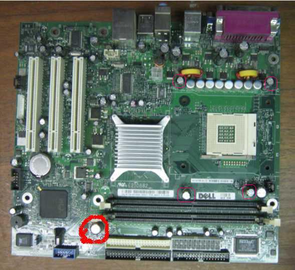

Bad Nichicon HM(M) on Dell Dimension 3000 motherboard.

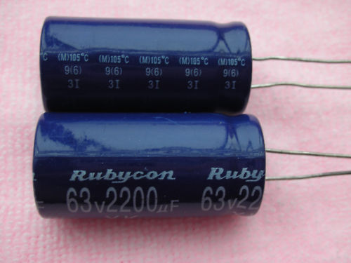

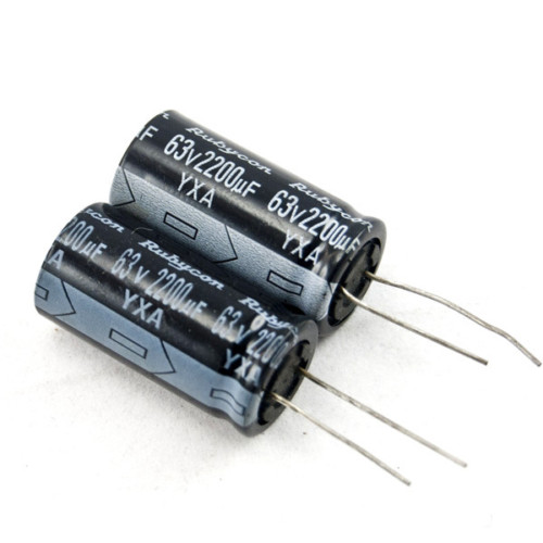

    Are these real?
    The font on the voltage doesn't look like it should. And the label on Rubycon YK's isn't blue.
    What do you think?

      The blue Rubycon is easy to pick out as a counterfeit. Rubycon does appear to vary a few things in their print layout and sleeve coloring but never as bad as that. While searching for a comparison pic I ran across a picture of identical twins.

            The braid seems to take it all, I had a 6.3v 3300uF Chemi-Con something laying around and replaced a bulging HM on my Dimension 4500, after I recapped it, it didn't POST, than again, it was a b1tch trying to get the old cap off, the holes were really small and the board didn't take solder well at all.
            I hope the 3000 takes solder better.

              Thought I would jump in on this thread as just last night I attempted my first ever soldering job, and it was on a Dell Dimension 3000 motherboard too. Last night I did the removal process, which was 95% successful (more below). I had 2 KZG 6.3V 820uF caps bulging/leaking, but I decided to replace all 4 KZG 6.3V 820uF caps, along with a single KZJ 10v 1000uF caps. Interestingly, the single KCJ is in the same location your Nichicon is in. Mine was not bulging, but I had read they could be prone to failure so I decided to replace it.
              I was able to remove all 5 caps last night and clear 9 of the 10 holes. I am still working on the 10th as it appears the one cap lead broke off inside it. I am having a bear of a time getting it out now.
              See attached picture of the caps I replaced (in addition to yours).

                Heat from one side and push the lead chunk out with a needle from the other side.
                Be advised that needle is going to get HOT so don't hold it with fingers.
                Push from side where the cap body was.
                The other end is probably slightly bent under the solder which is why it didn't come out so easily.

                                  Recapped my Dell Dimension 3000, the Dell Dimension 3000 lives on!
                                  It worked! It booted right up, I had to set the time and date because I took the battery out of it before I recapped it.
                                  I used a Rubycon MCZ 16V 1000uF
                                  Thanks for your help BadCaps.net!

                                        I am still having issues after the recap and I am actually considering re-doing the recap to see if that remedies it. The computer randomly fails to turn on (or turns on for a few seconds then shuts down) or it will boot up but fail during the Windows load with the "Session5 Initialization Error" (which is the error I had prior to the recap). Sometimes the Dell lights on the back will indicate that a memory module is bad, other times they will be all green. I did get it to boot into UBCD but it took forever to load it and do anything in it. When it does attempt to load Windows (always resulting in the Session5 error) it also takes forever to load.
                                        I tested the PSU last night and that seems fine. I am going to run a memory test today to verify the modules are okay (if I can get the computer to stay on).
                                        • PCBONEZ
                                          Grumpy Old Fart
                                          • Aug 2005
                                          • 10661
                                          #60
                                          Re: Bad Nichicon HM(M) on Dell Dimension 3000 motherboard.
                                          Do you have those 85C buggers too?
                                          Intel [builder of this board] randomly uses those so some boards get them and others don't, even in the same model board.
                                          Most of them are for EMI.
                                          EMI = Radio Frequency Noise from cell phones, CRTs, microwave ovens, and so forth.
                                          Sometimes they end up in smaller local VR's for things like the chipset sub-circuits or Vtt.
                                          If one of those goes bad all kinds of crazy 'unexplainable' things can happen.
