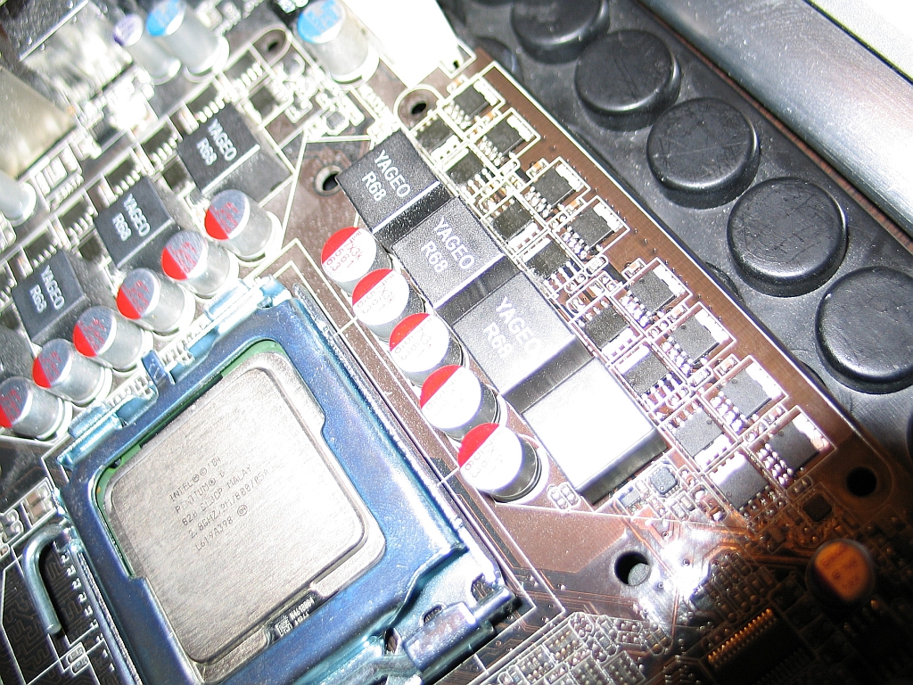

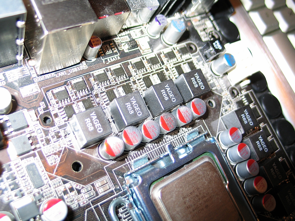

    Ok, got this mb - it does power up but does not post.
    I thought this was the perfect time for me to measure and understanding the vrm circuit.
    I did read the guide for vrm testing written by AK0R but did not understand everything.
    There are two rows of voltage regulators, the inner row is 5525L and the outer row is 9025L.
    Here are my voltages with mb on, I used gnd in the p8 plug on all of these.
    Outer row towards back of mb.
    Drain - 12.01V (mounting base)
    Source - 1.27 V (pin 1,2 and 3)
    Gate - 2.31 V
    Inner row towards back of mb.
    Drain - 1.27V (mounting base)
    Source - 0V (pin 1,2 and 3)
    Gate - 10.47V
    Outer row top of mb
    Source - 1.26 V (pin 1,2 and 3)
    Gate - fluctuate between 1.289 to 1.296V
    Inner row top of mb
    Drain - 1.26 V (mounting base)
    Gate - fluctuate between 0.255 to 0.231V
    Does this seem right or should I be worried ?

    You aren't going to get any useful readings from the gate unless you have an oscilloscope or a meter with frequency reading. Also when you read the gate you always read between gate and source, not between gate and ground, because what you have there is a synchronous buck converter where the high side MOSFET is some volts above ground.
    Measure voltage at the CPU caps. If you get 1.something volts then Vcore is okay. If Vcore is okay, it's most likely failed BIOS.

        Ahh did not know the right steps for measuring gate, I updated my measurements.
        Gate - 1.041 V
        Gate - 10.47V
        Outer row top of mb
        Gate - fluctuate between 0.023 - 0.030
        Inner row top of mb
        Gate - fluctuate between 0.255 to 0.31
        I have 1.265 over the cpu caps.
        Bios is ok, I know for sure.
