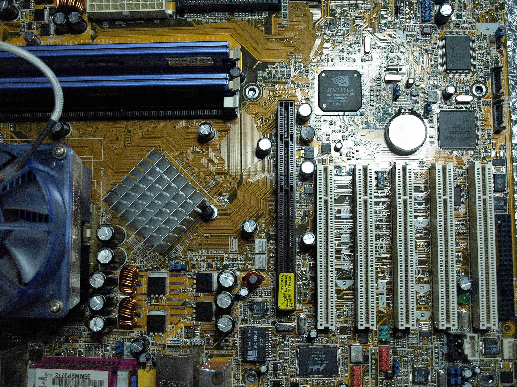

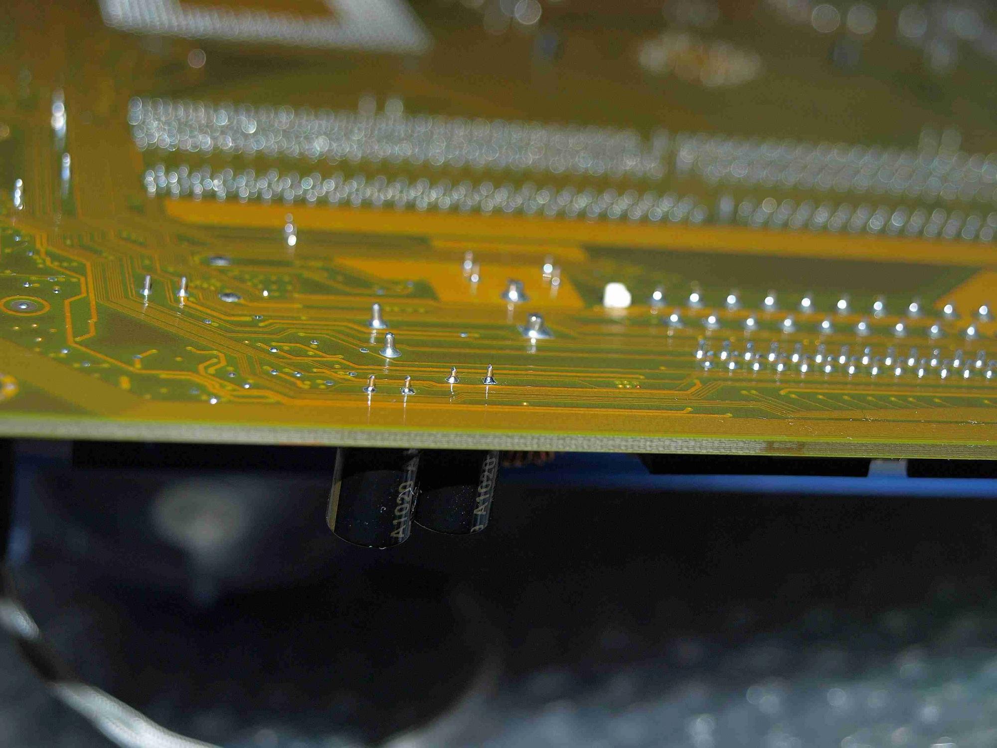

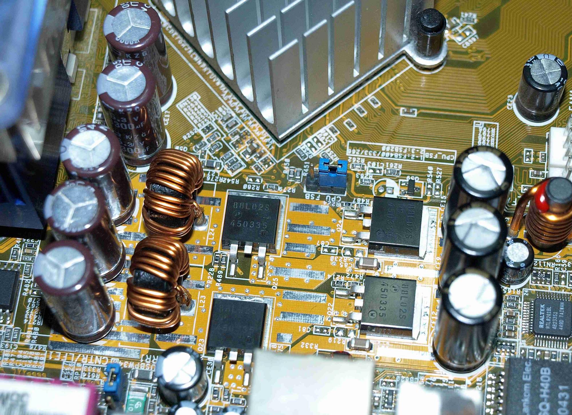

    It is my first post on this forum. Till now i only fallow some topic.
    Yesterday I decided to recap three 3300uf/6,3V Nippon KZG capacitors (form one branch of vrm) despite mobo works stable. I replaced blown caps for MCZ Rubbies. Recapping went without any problems, soldering pads looks relay fine but board didn't start. only collers of CPU and GPU are working).
    Could You snuggest me what went bad? May be MCZ is to good and i have to use MBZ series of Rubbies (MCZ have too low ESR than original KZG). I dont wont to solder and desolder to many times before i'm sure of reason why mobo don't start.
    Thank i advance for help

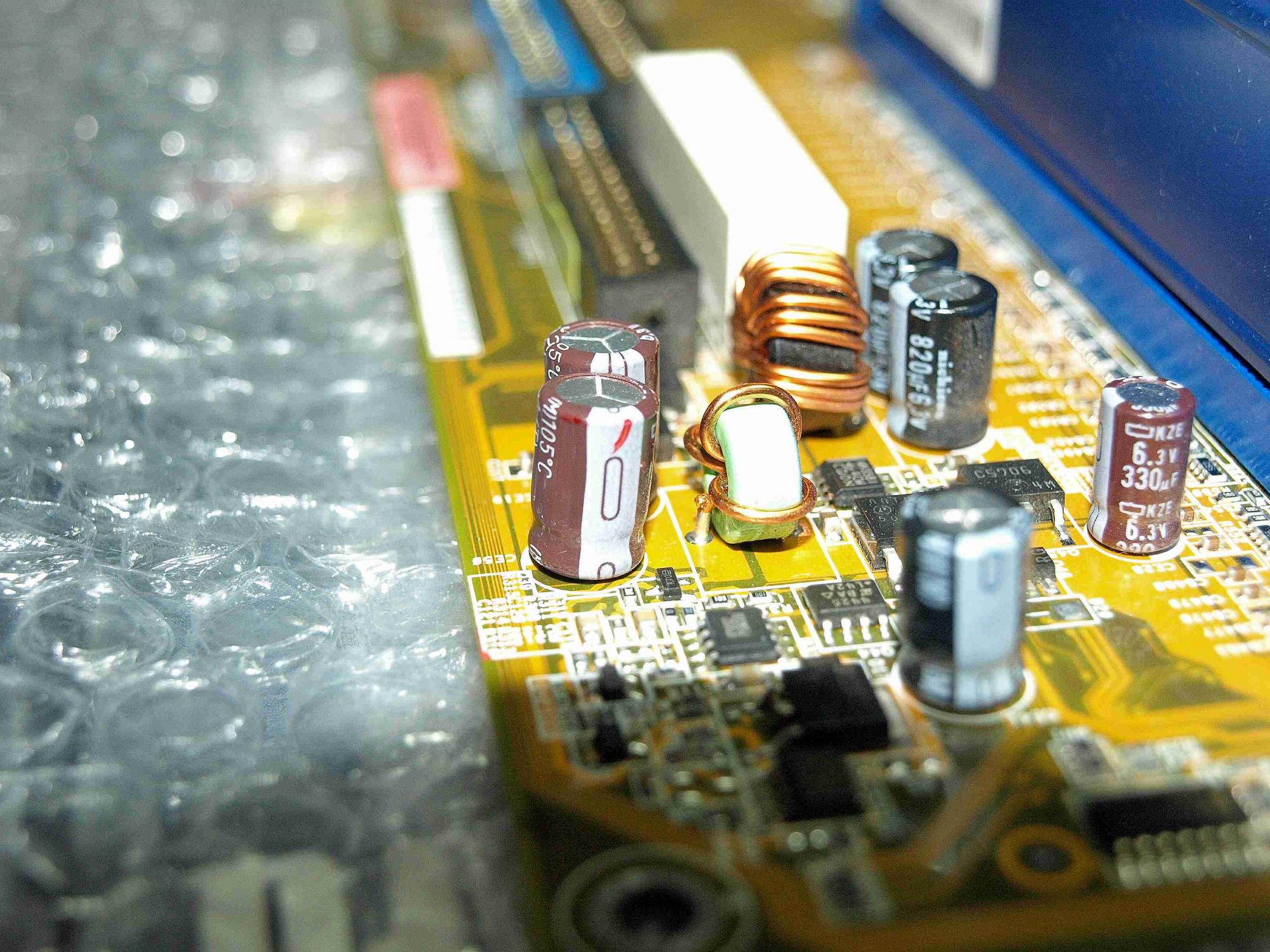

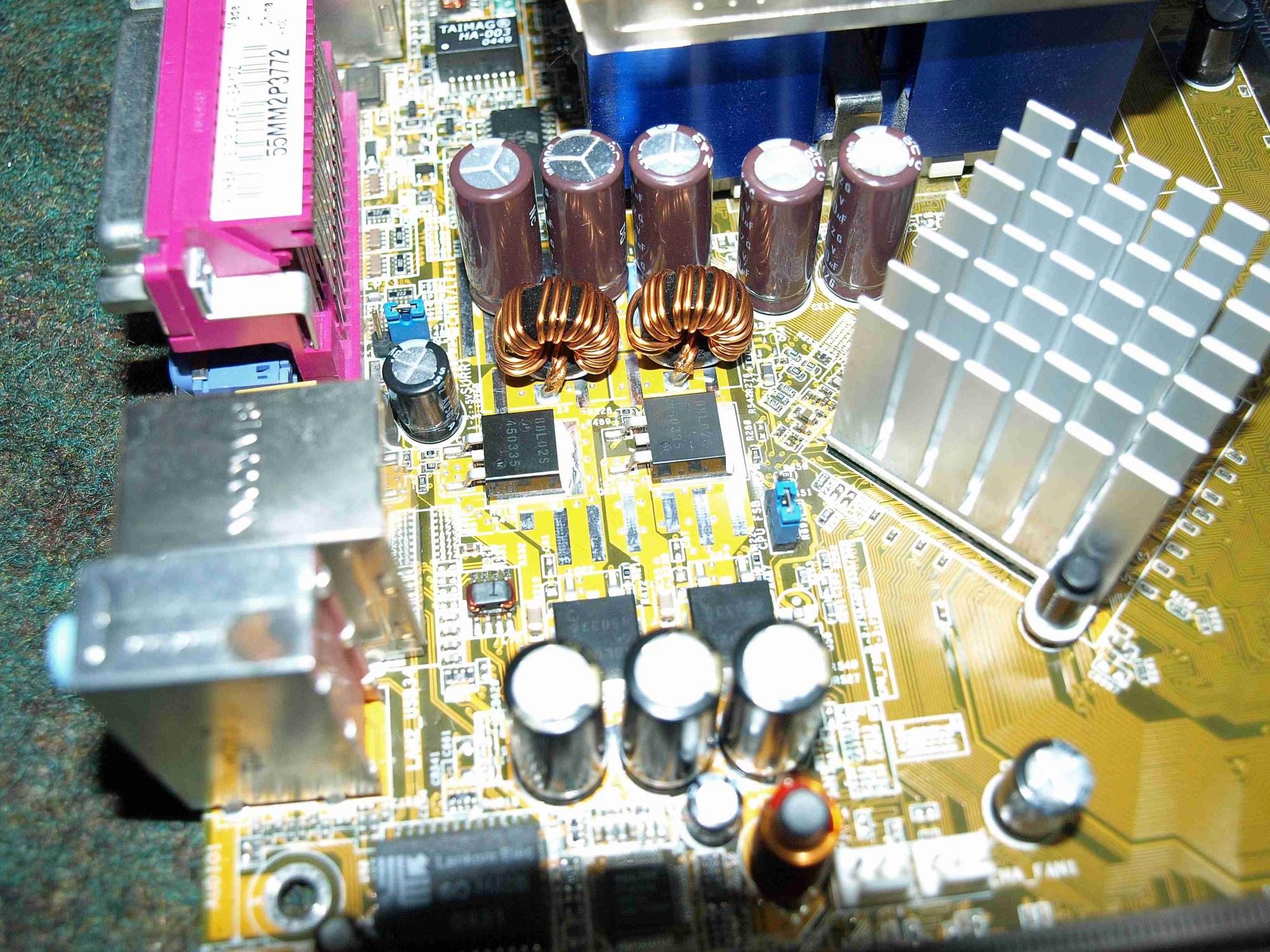

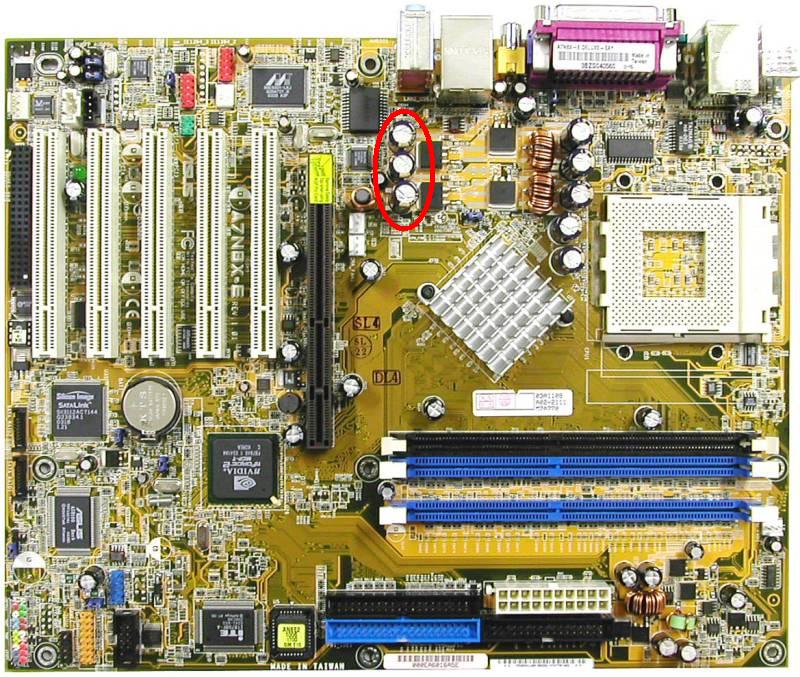

      Re: Asus A7N8X-E don't start after recapping
      I reseted bios. It changed nothing.

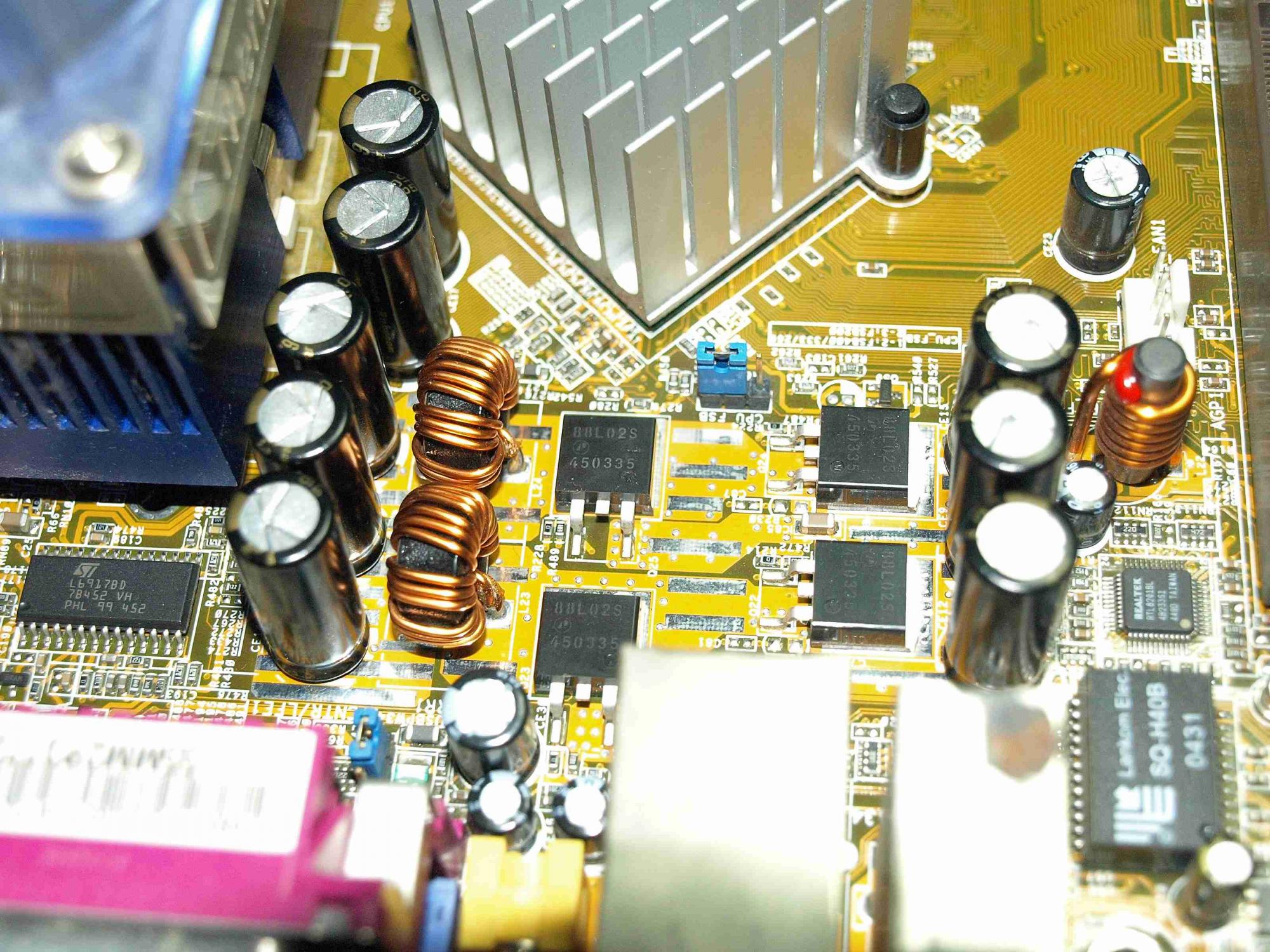

      KZGs was repleace form one of VRM line. I marked them on picture:
      Does replace rest 5 of KZGs form second branch of VRM change something?
      I can't understand relation between replacing all KZGs and starting board, however before replacing this tree among one was blowed board was starting.
      Could you explain
        KZG's fail without bloating at all.
        You had some bad KZG.... the rest are most likely bad too.
        Take out the battery when you are changing caps to reduce the chance of zapping your BIOS.
        Looks like you may have some Nichicon HM on other parts of the board.
        If the dates on them are from 2001-2004 they are bad too. [Factory screw-up]
        Dates on those are like "H0233" -- That would be week 33 of 2002.
        - I dunno what the H means but it's usually an H or an A.

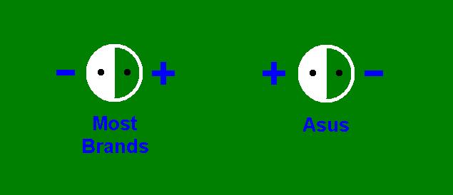

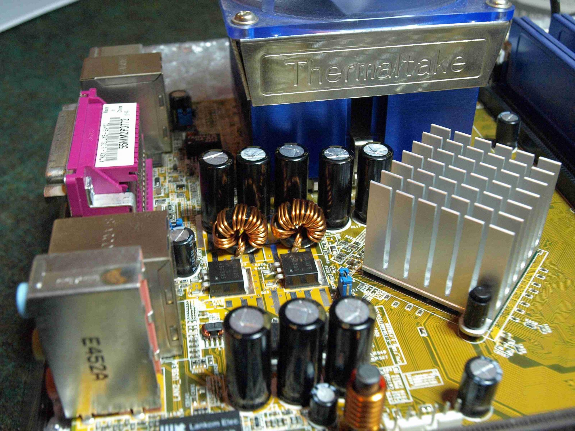

          keep in mind, with a lot of asus boards the circut marking for caps is reverse. don't put the negative side of the cap on the full half moon

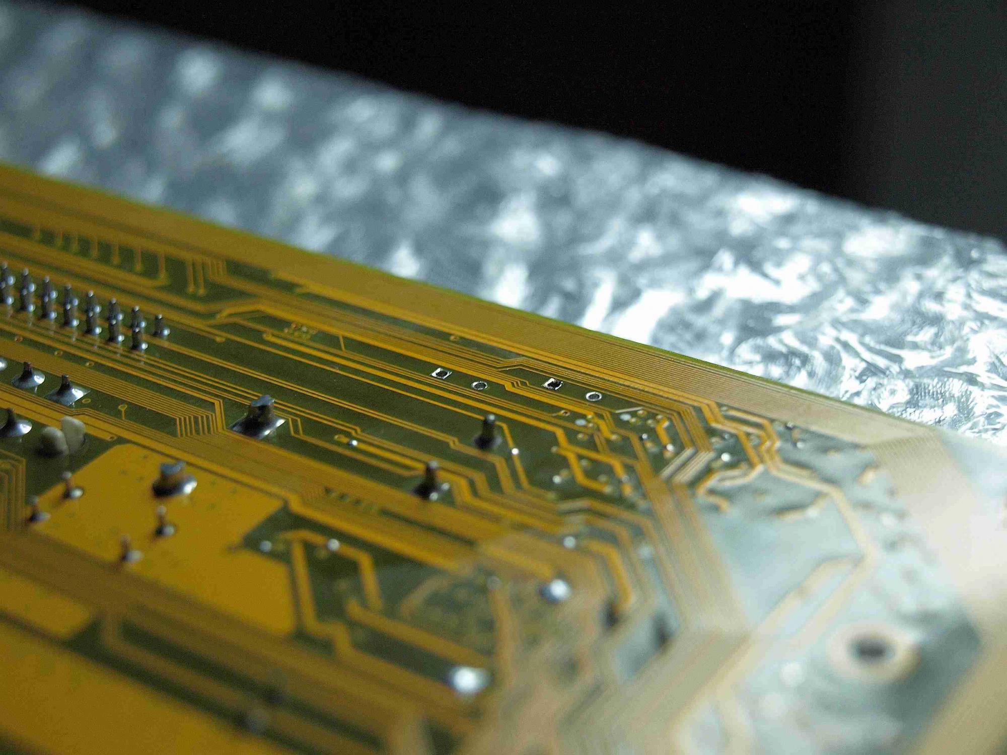

            Attached is not real but for sure there are KZG.
            My english isn't so good and I don't understand what mean "zapping BIOS" - something like destroy or damage? But for sure I didn't take out battery.

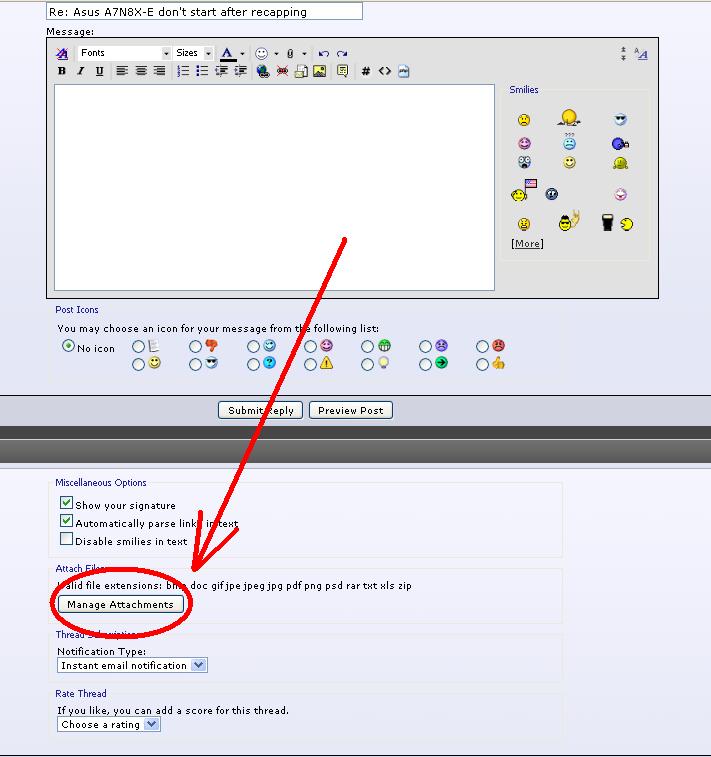

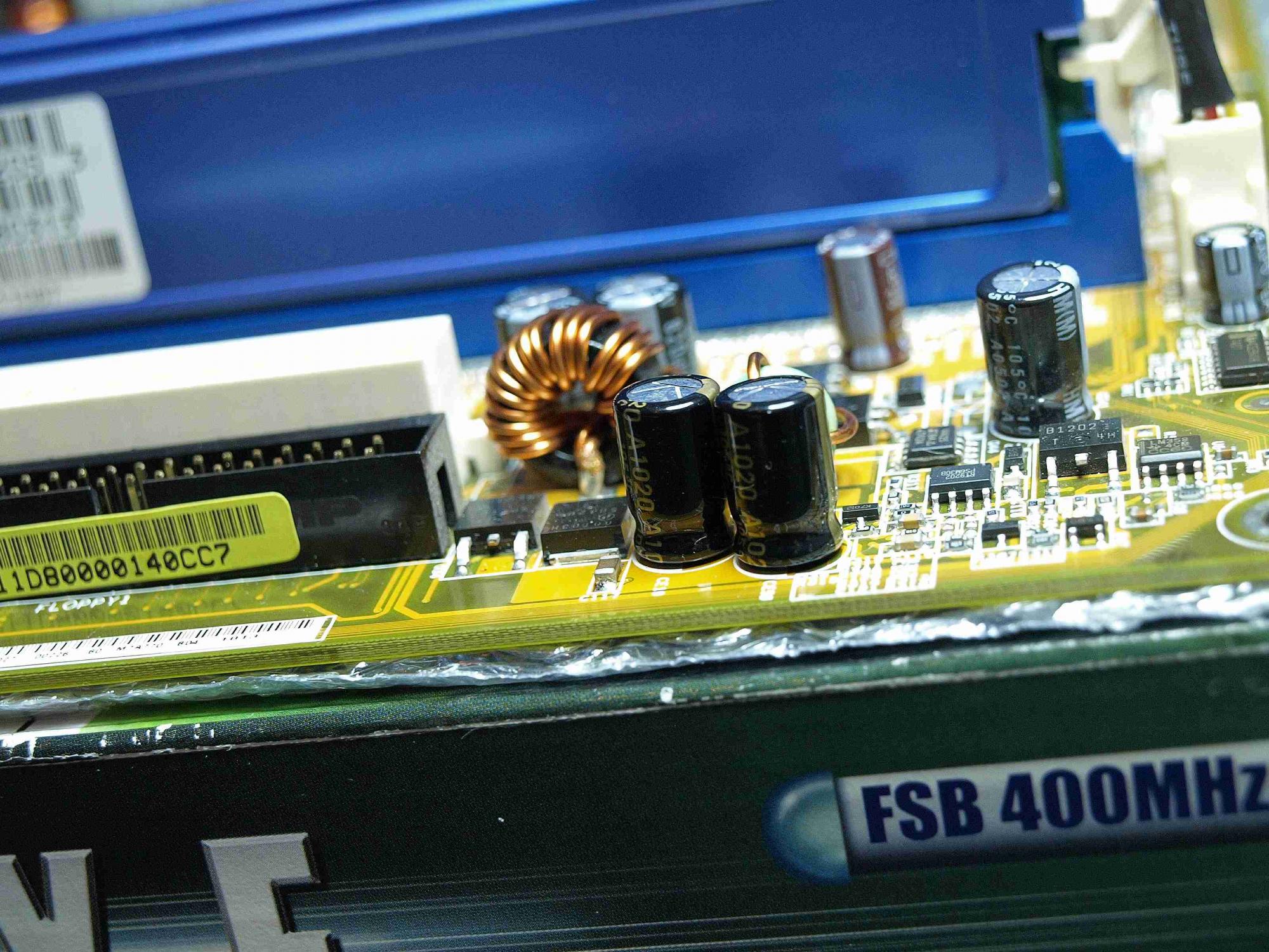

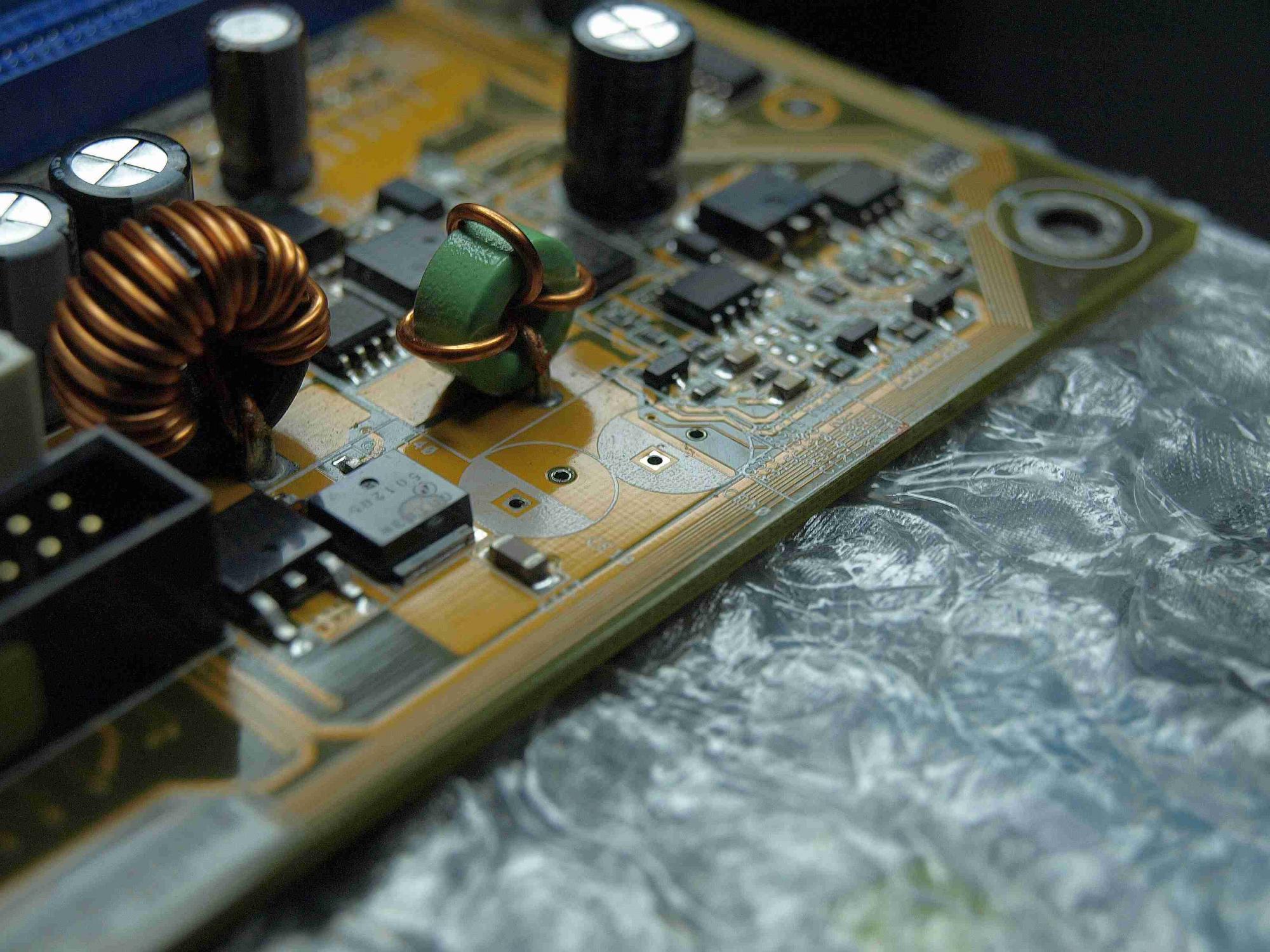

                    Zapping = Static Damage.
                    It is a slang expression.
                    Replacing KZG with MCZ should be fine.
                    What Uranium-235 is saying is that Asus marks the + and - backwards from what is standard.
                    -- See pic
                    Your attachments didn't attach.
                    -- See other pics.

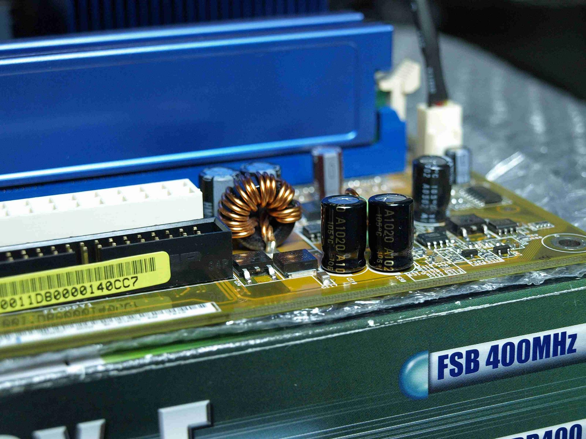

                        Thanks for all suggestions.
                        Now motherboard is starting. Probably problem was with zapping bios. I took out battery and move the cap on pins for CLRT and keep it in this position for half minute, after that mobo started.
                        But I'm afraid of recapping rest of KZG. Should i recap all or use board with recapping 3 of 8 KZGs?
                          you've gone this far, so why not, just remember they're reverse
                            Remove the CMOS battery and replace the rest of the KZG.
                            You already had some KZG completely fail.
                            The rest of the KZGs are not far behind. [Won't last much longer.]
                            You are doing very well.
                            Don't get discouraged now, you are almost done.
                              Should I replace two KZG 820uF 6,3V near DIMM slots to?
                              • PCBONEZ
                                Grumpy Old Fart
                                • Aug 2005
                                • 10661
                                Yes.
                                I would replace any KZG that are 6.3mm diameter or larger.
                                [Data sheet only shows 8 & 10 mm sizes but I've seen smaller ones.]
                                If you can't find 820uF then 1000uF should be fine there.
                                KZG not only fail without bloating, they have a habit of failing suddenly.
                                System works fine one day and the next day it just won't boot.
                                That has happened to me -personally- twice with KZG and many other people have reported similar experiences.
                                  Yesterday i recapped rest of KZG on my A7N8X-E. Five 3300uF and two 820uF near dimm. Now mobo working great and is stable as rock. I can run CPU on higher FSB then before without loosing stability.
                                  Thanks all for help, and double thanks for PCBONEZ.

                                        What is reversed on Asus are the 1/2 circle marks on the board.
                                        There is no official standard for that marking but about everyone except Asus marks them the other way.
                                        When you recap ANYTHING make a cap-map before you start removing caps.
                                        Mark the polarities of the originals [as well as what goes there] right on the map.
                                        [I take a snap-shot and print it big, but you can just draw it out too.]
                                        There are other good reasons to make a cap-map.
                                        - If your project gets interrupted while you have a bunch of caps out, all the holes [even the 'spare' holes] look the same when you come back to it.
                                        - Sometimes there are random errors in the polarity markings [on any kind of board] such that one or a few caps are marked backwards from the rest on -that- board.
                                        - Not so much on motherboards but, once in a while you will run into bipolar caps which don't have a polarity at all. By making a map you won't make the mistake of installing a polarized caps where bipolar caps were. [And you won't waste time trying to figure out which way the 'missing' polarity mark [that actually shouldn't be there] is supposed to go.]
                                        People come in here -all the time- with "I have a bunch of caps out and I dunno where they go!".
                                        Sometimes someone can help them but other times not.
                                        - The ONLY time I ever skip making a map is when I have more than one of the same board, in which case the other board IS the cap-map, so I'm not really skipping using a cap-map at all. I'm just not printing one.
