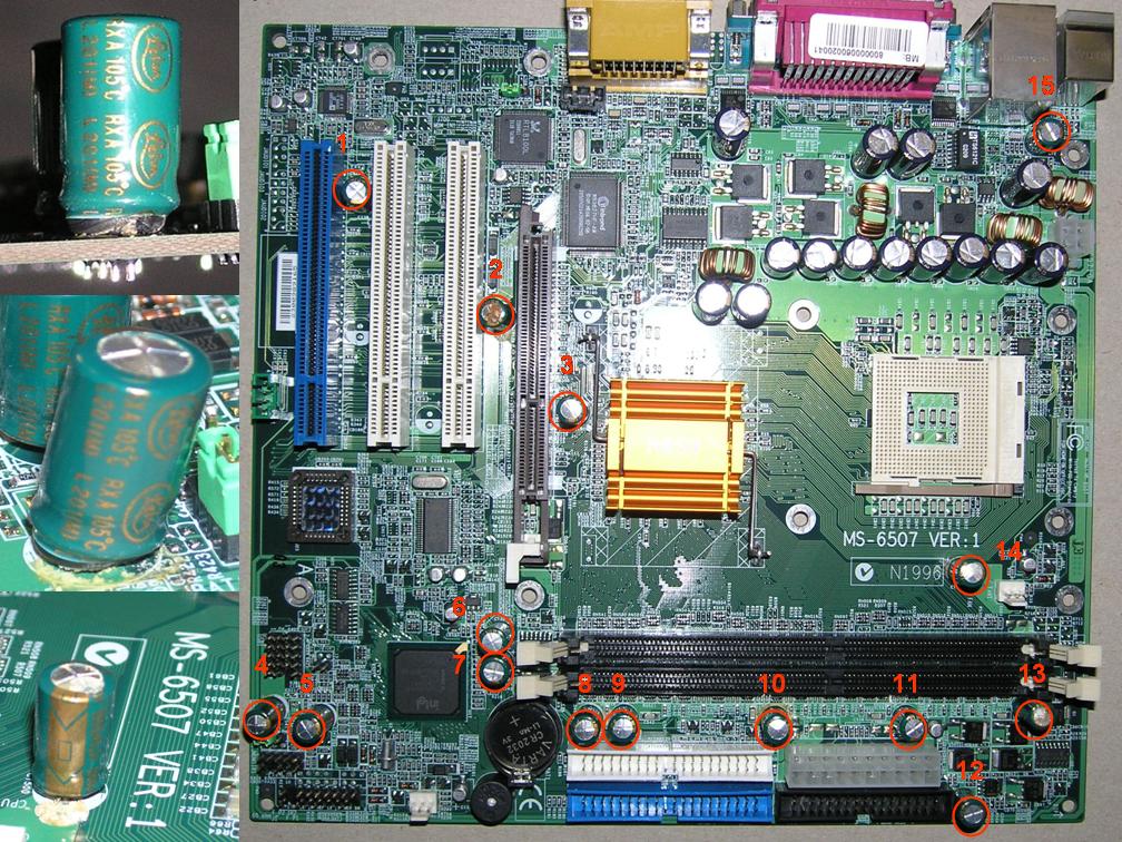

    MSI MS-6507 Rev1 Medion
    all 15 piece (1000uF / 6,3V) condensers failed!
    MSI MS-6507 Rev.1 (OEM for Medion Aldi MediaMarkt in Germany)
    MSI wants to supply replacement!

    Re: MSI MS-6507 Rev1 Medion
    how long before fail?
    photo?

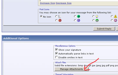

        Where can I insert the photos here?
            bought to: 04/2002 - MediaMarkt, Germany
              nice photos
              the K condenser are Rubycon (very nice)
              the green are Lelon (worst)
              if MSI give you another board with Lelon condenser it will fail again in 3 years.
                MSI supplied only 15 condensers to me with.
                That is better than nothing.
                  ah you will fix the board yourself
                  good luck. i hope you succeed.
                  what brand of condensers did they send you?
