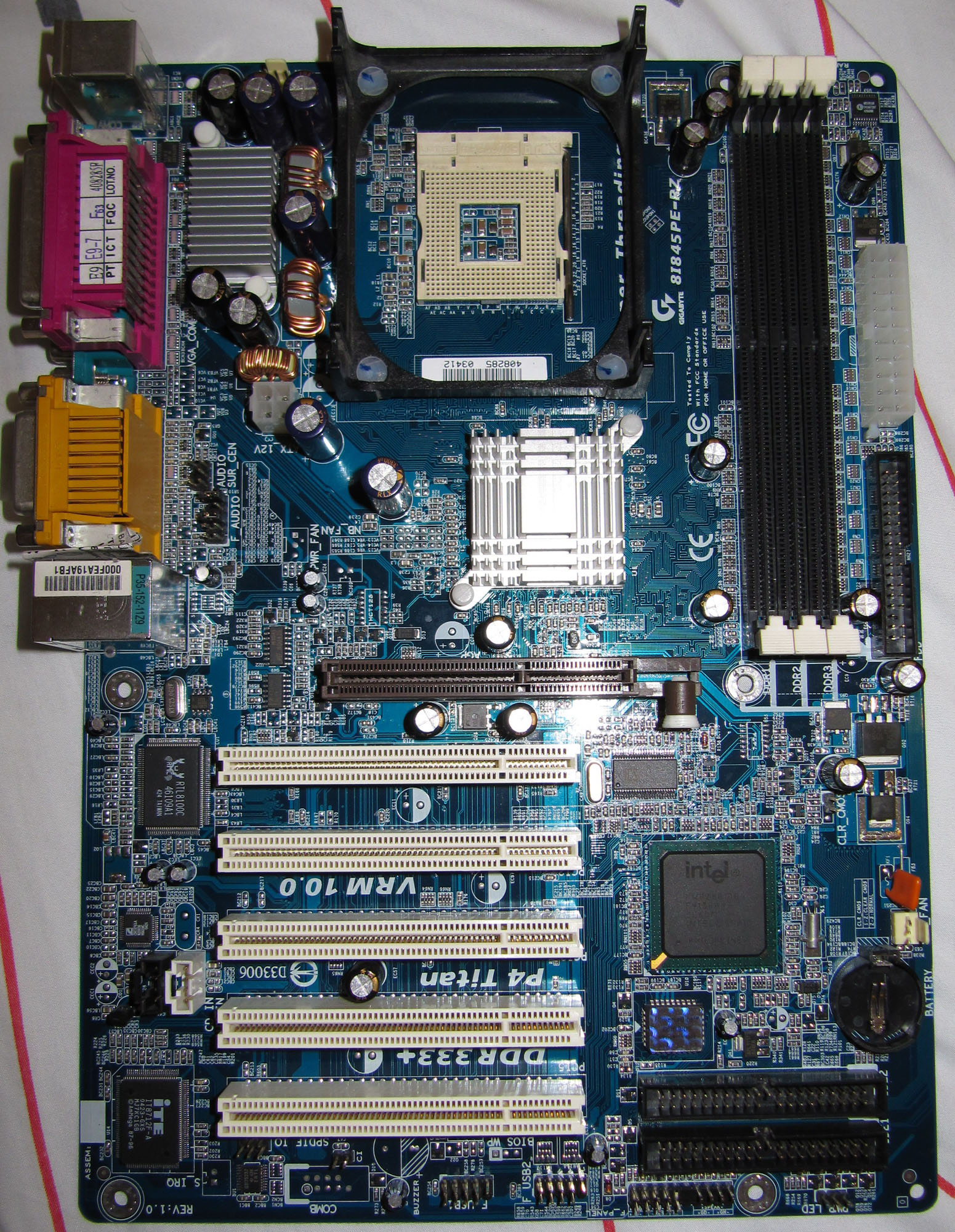

    One of my recent findings, that motherboard was in its original antistatic bag and had no dust at all, so I thought it might be unused and good.
    But I was wrong. When I power on the psu, the cpu fan spins, but there is no other activity, no beeps or boot...
    I noticed that the southbridge gets extremely hot, more that 10 seconds being powered, it starts smelling burnt silicon.

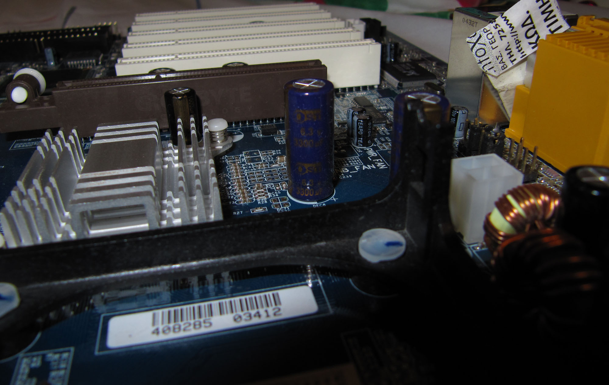

    The big caps are all OST, the medium are G-Luxon and the tiny ones are Teapo.
    What do you think? I don't think that bad caps can cause this.

    Sounds like DOA - probably why it was put straight back in its bag. Could be caps though... Have you got an ESR meter?
    Also, I've seen a couple of 845 chipsets on QDI motherboards go up in smoke for no "apparent" reason.

      DOA is what I think too.
      There were complete PCs near the motherboard with same model installed. Those were dusty and had some caps bulging. That's why I chose to take this one...
      I have an ESR meter and I tested the big caps in circuit and found the total capacitance to be ok.
      edit: I would use it for caps but it doesn't have any quality caps on it

        Maybe it got Bestec-ed/Antec-ed (over-voltage on 5vsb) .
        Check how much current it's pulling from the 5vsb in the off state when a PSU is connected to it. Then power it on and check again.
        Yeah, you can't use it for the caps . Not for anything serious anyways.
