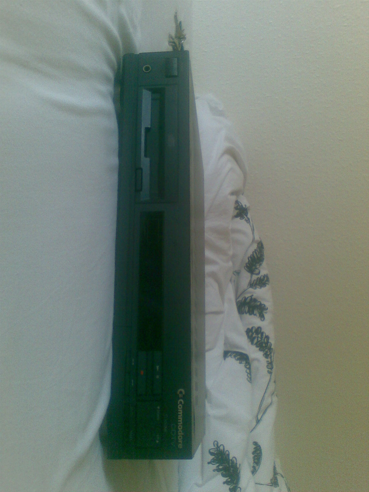

        Mind posting a few shots of your CD-TV? It looks like an interesting machine.
        • Rob Northen
          • Jan 2010
          • 137
          • Denmark

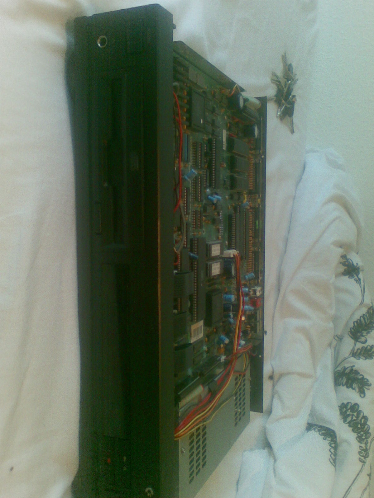

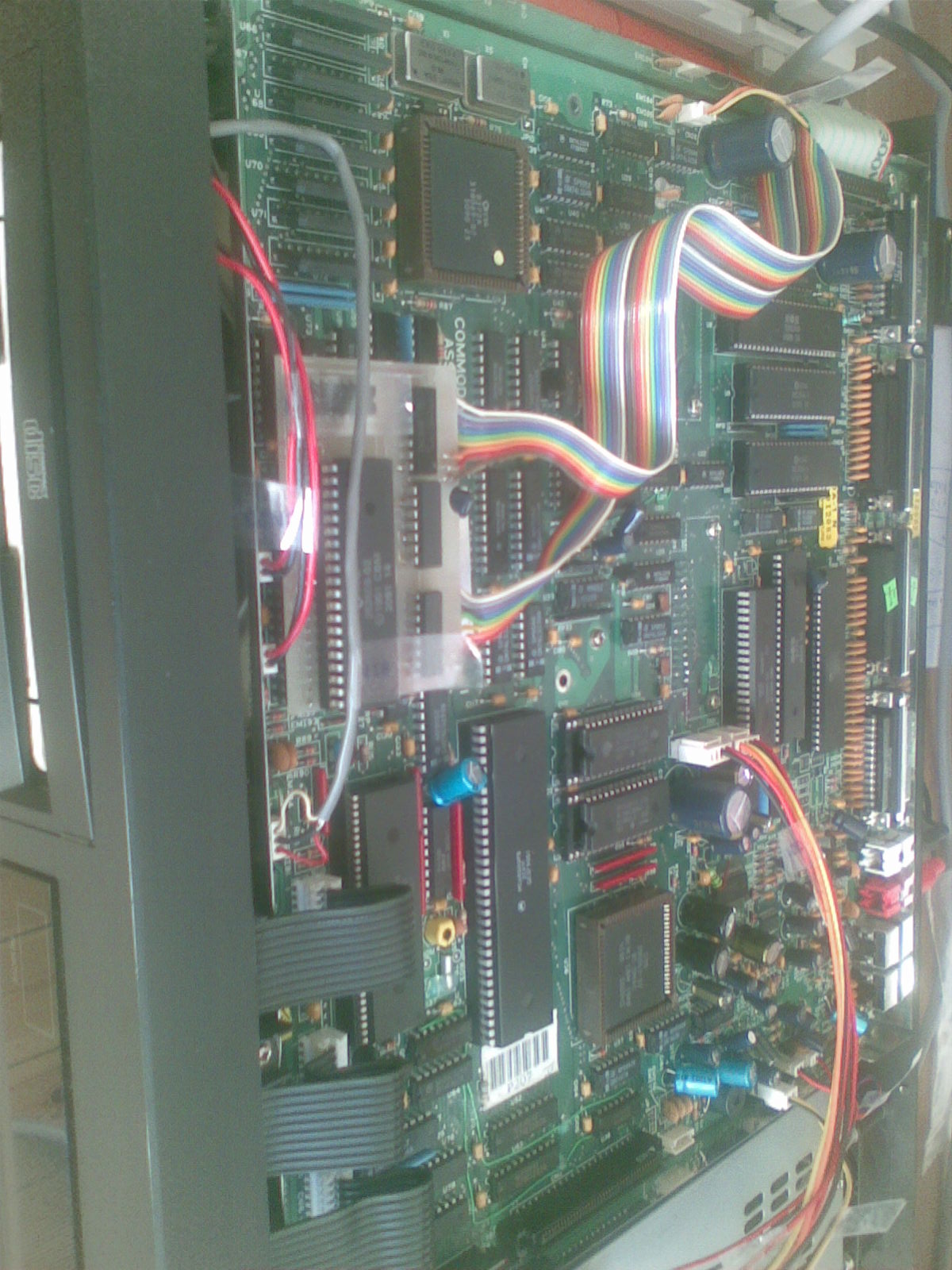

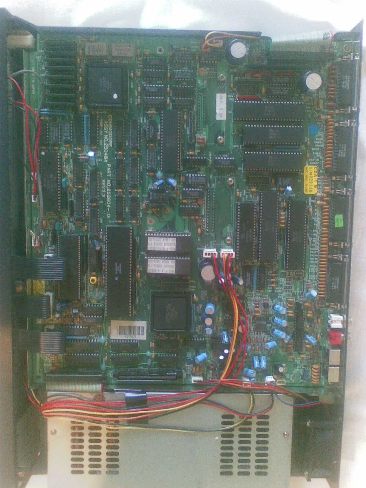

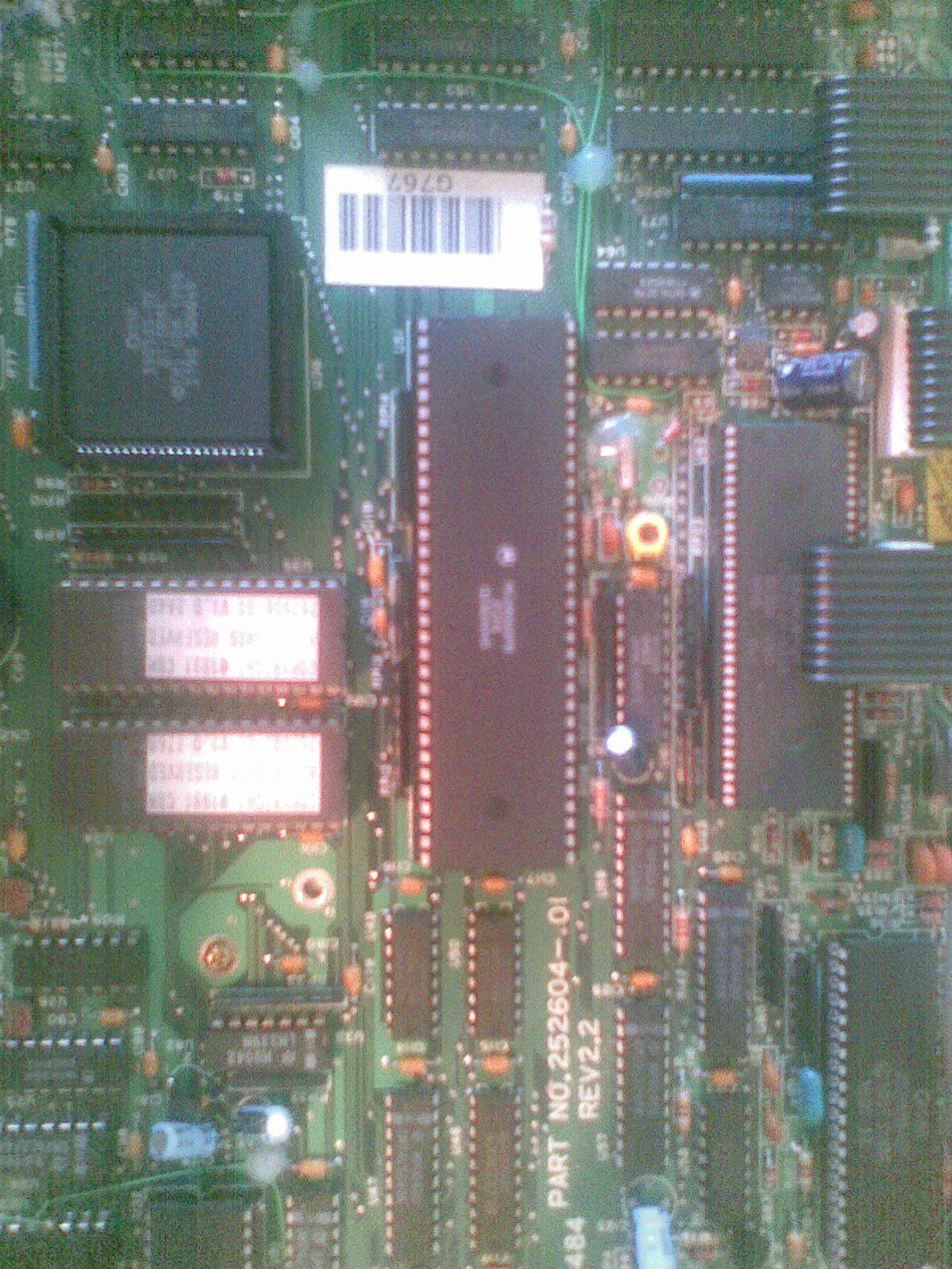

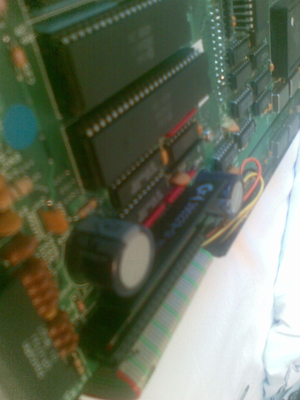

          Re: Amiga CD-TV caps questions
          Its my pleasure
          I only have a camera-phone, so pics are not so good, sorry.
          This is pics of my spare unit, the other one is disassembled for re-capping.
          Most of the caps are "SHOEI", I've seen them in a lot of Commodore computers. It can't be that bad a brand, these caps are still working in units
          from as early as 1988!
          At this link: http://www.amiga-hardware.com/
          You can find find good quality pics of the CDTV

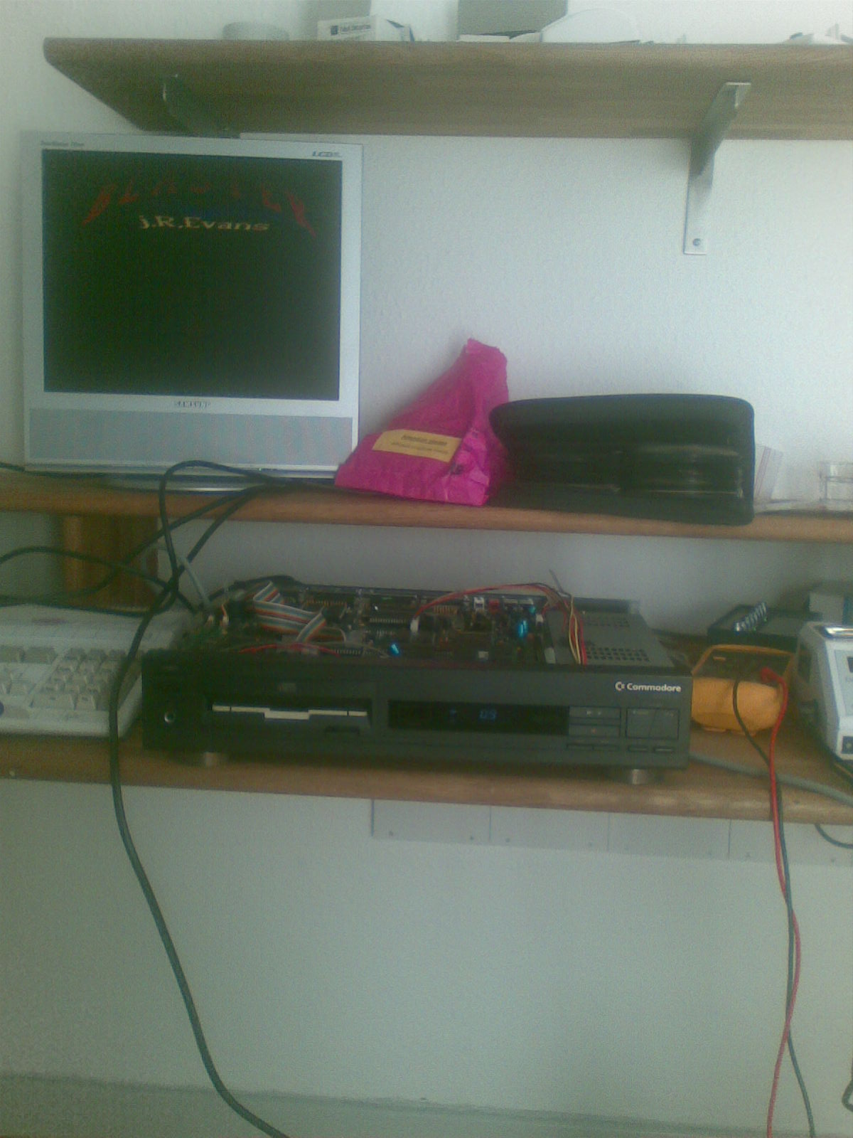

                Recap is done, and the machine has been on for two hours now.
                Just need to fix some loose leeds for the joystick expansion.
