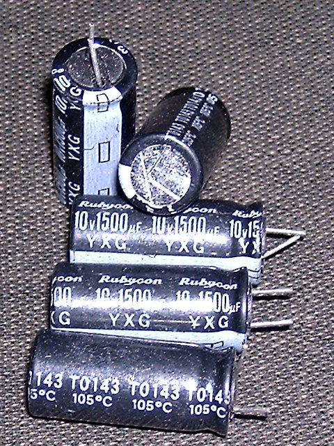

This is another one for the books.... Sadly, it was packed with Rubycon caps that had failed. The failed caps were all ZL series, 105* 2200uF 6.3v and 1000uF 10v. It's hard to tell from the pics, so I marked the ones that vented. The tops are very slightly domed, and one had the classic electrolyte crud coming from the vent. Only about 5 of them had actually vented, the rest looked normal.
Rubycon being my most favored brand of capacitor, this one was really disheartening to see...
In Rubycon's defense however, I do not know the working environment of this board, nor how it was treated. It's definitely a server board (obviously), so most likely its been in a rack case, running non-stop since it was new. To hypothesize, I'd say the most likely scenario was the system was allowed to run too hot, classic of a dual AMD with inadequite ventilation.
Anyway, some pics:
After recapping with more Rubies (MBZ Series this time), and some Sanyo's:
I just hope this one was an isolated case. The board is solid as a rock now.
