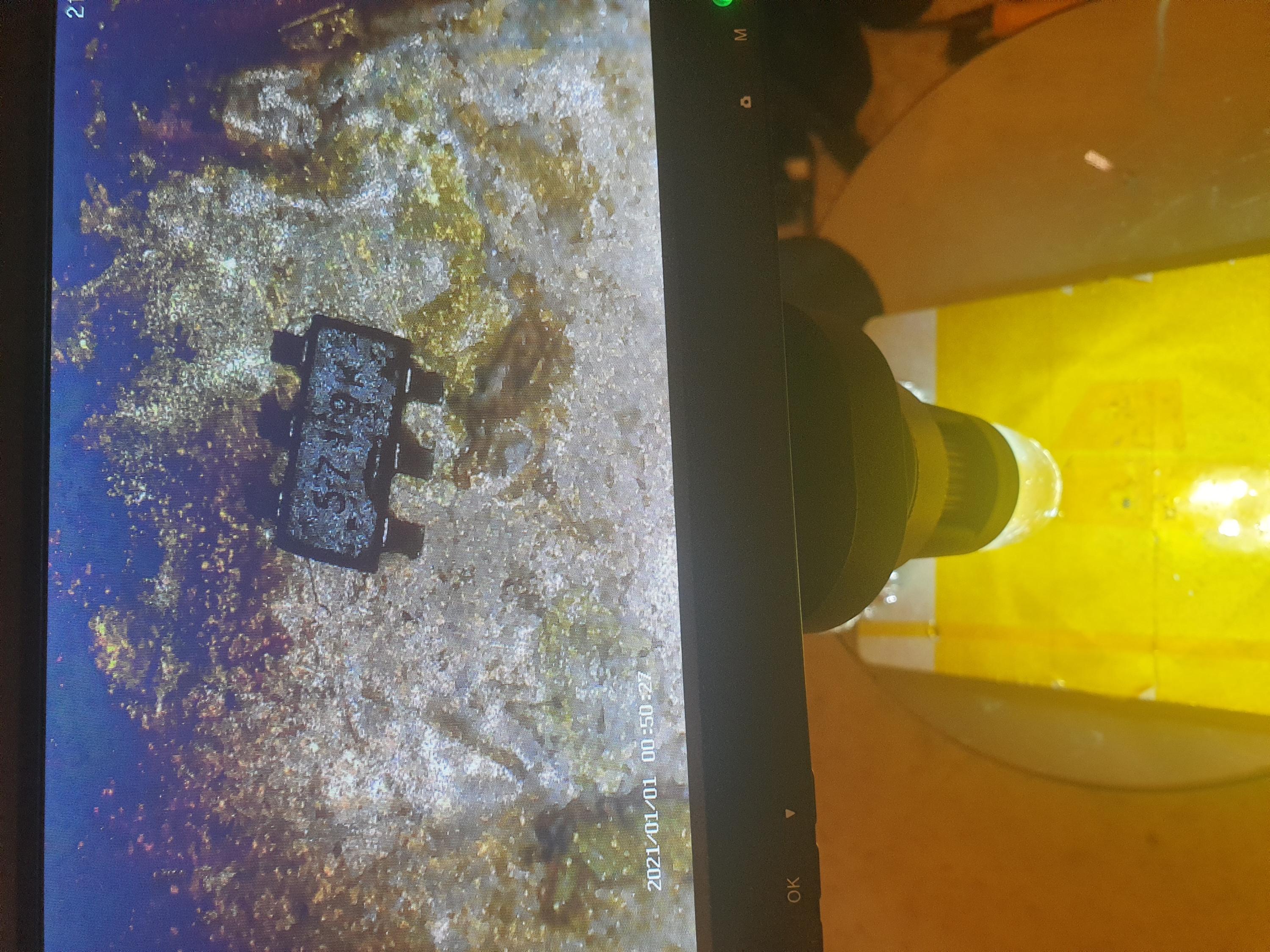

    While trying to identify the source of a short circuit on a satellite receiver (Nasatronic NTC-02), I found the component causing the short as a 6-pin SMD chip in an SOT23-6 package with marking 5719k.
    Does anyone know what this chip is ?

    C/P
    19. lis 2012. ยท The G5719 is a high efficiency monolithic synchronous buck regulator using a constant frequency, current mode architecture.
    G5719 Datasheet PDF
    www.datasheet-pdf.com โ€บ G5719
    Part Number, G5719. Description, 2A Synchronous Step-Down Regulator. Info, Global Mixed-mode Technology G5719 1MHz, 2A Sync.

      Re: Need help identifying an SOT23-6 with marking 5719k
      Dear harp,
      Thanks a lot, it seems to be also fitting the circuitry on the board
