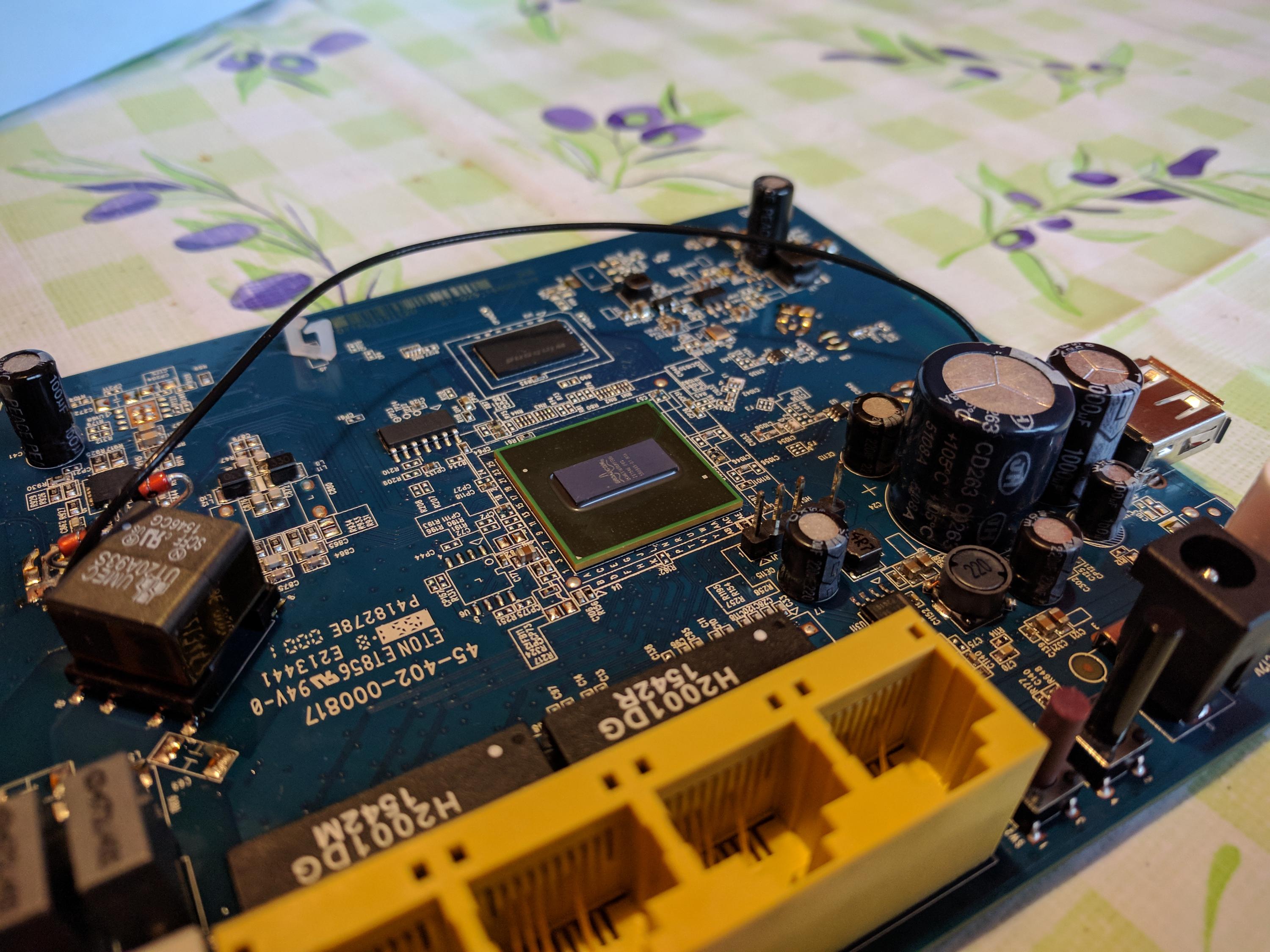

    Hello guys,
    may I ask you for confirmation whether to use solely low ESR capacitors in a Wifi routers ?
    I would like to replace these cap. because they are showing higher ESR.
    I dont know the brand, neither the datasheet was found. However on the caps is written: PEACE, either CD11XH or CD263.
    It is from zyxel router "vmg 1312".
    Caps are warm but not hot. These are close to power cord.

    Re: Type of capacitors in Wifi router
    i use panasonic FC for it, i also notice cisco products uses FC capacitors
    solid capacitor is okay to use, like oscon
      fc or for longer life fr.
