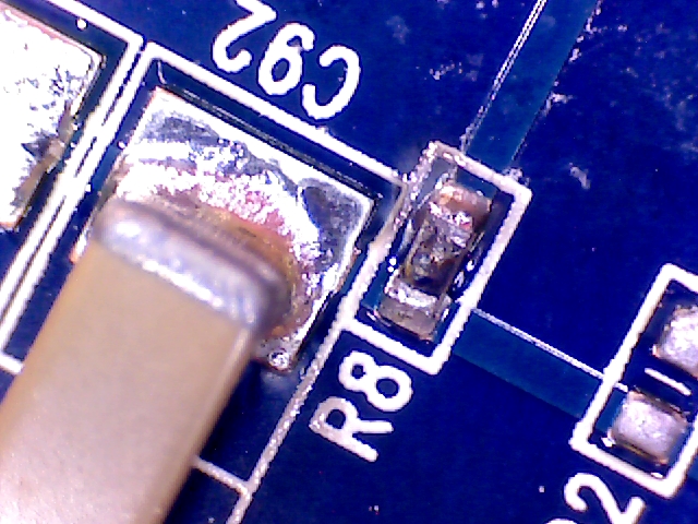

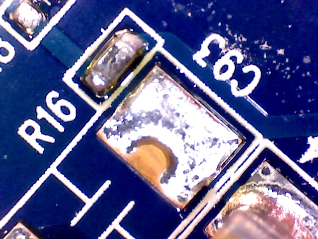

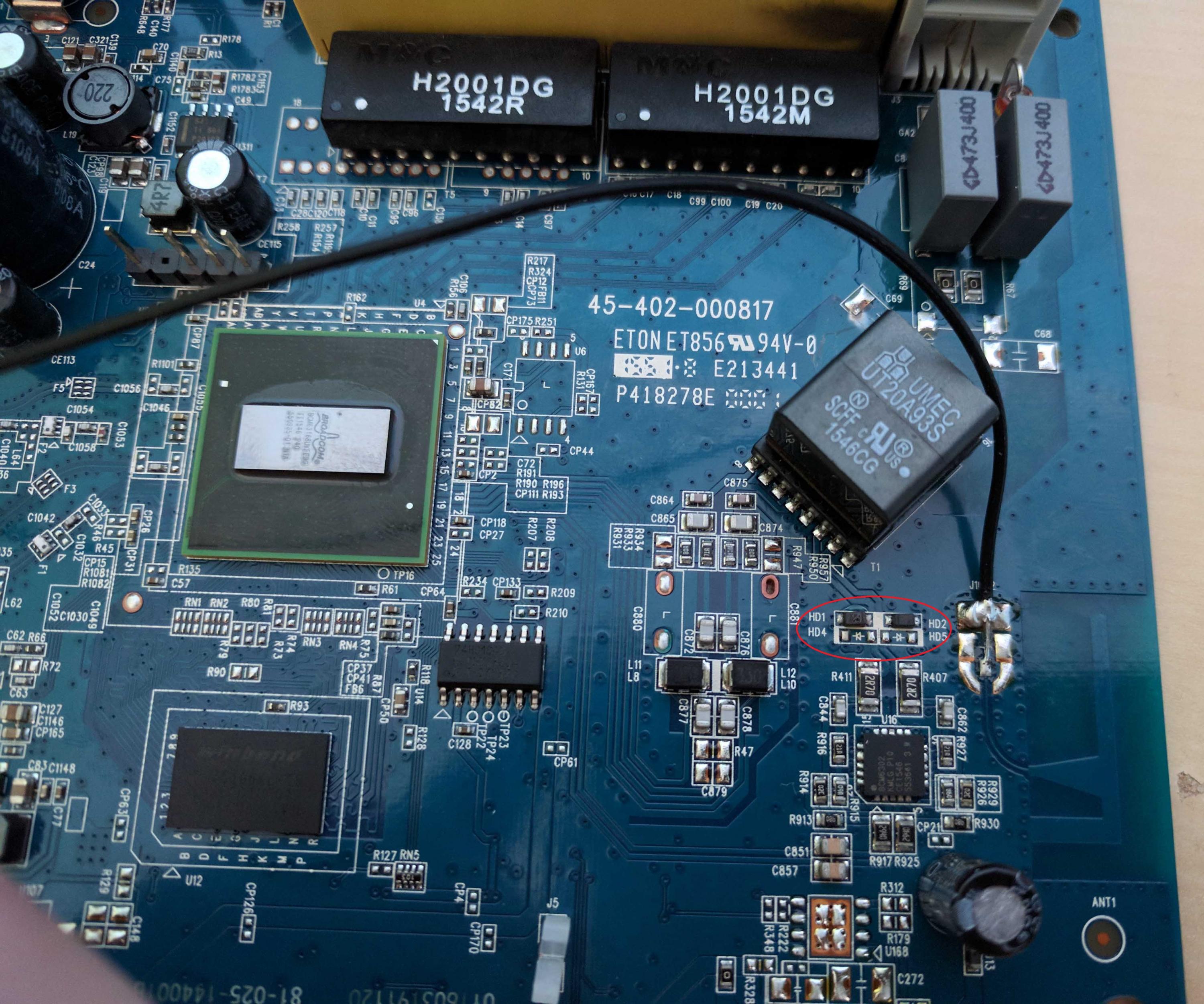

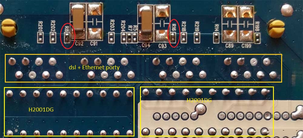

    Dear all,
    I am experiencing troubles with my wifi zyxel router VMG1312-b30b
    DSL port is off, DSL cable isnt detected.
    WiFi, Ethernet ports are working well, GUI accessible.
    After inspection of the box is obvious, that resistors R8, R16 are damaged/burned. Unfortunatelly, I am not able to find electronic schematic so I dont know the resistance.
    Could anyone help me with identification of SMD R8, R16 please ? These are next to DSL (RJ-11)and Ethernet(RJ-45) ports, close to H2001dg.
    Also, could you help me with identification of GA1 which is parallel to DSL port ?
    Pictures are attached.

    I would make an educated guess that R14 is the same as R8 and possibly R16.
    GA1 looks like a diode to me. Does it measure like one ?
      • 30979
      Re: Zyxel WiFi VDSL VMG1312-b30b dsl port off
      ga1 is a spark gap and should meter open-circuit.

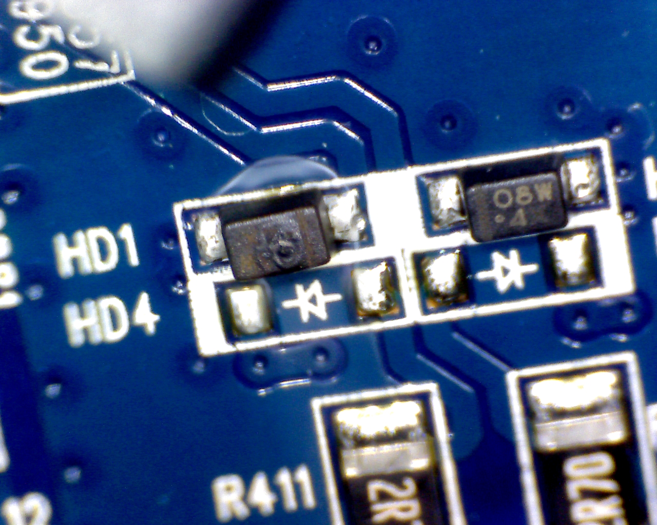

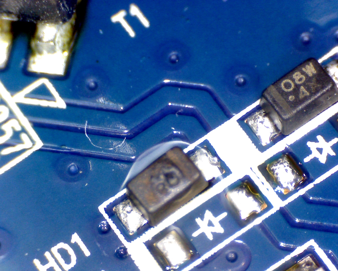

              Another broken part - could you help me with identifiacion please ?
              SMD diode HD1, HD2: O8W 4X - unable to find on google
              Have you seen it before ?
                • 30979
                MM5Z10V if it's a letter "O"
                MM5Z4V3 if it's numeric "0"
                  Amazing
                  How did you decode the diode ?
                      An idea how to determine whether is this 10V or 4,3V ?
                      0 and O looks similar
                        • 30979
                        desolder a working one and stuff it on a zener tester.
                        • perseus142
                          • Jun 2017
                          • 30
                          • Czech republic
                          Right. After desoldering the working one I measured Uz=9.36 V
                          My new 10V zener diode has got Uz=9.6V.
                          Is that suitable replacement part ?
                            • 30979
                            close enough.
                            zeners are only acurate to the last 5% usually anyway.
